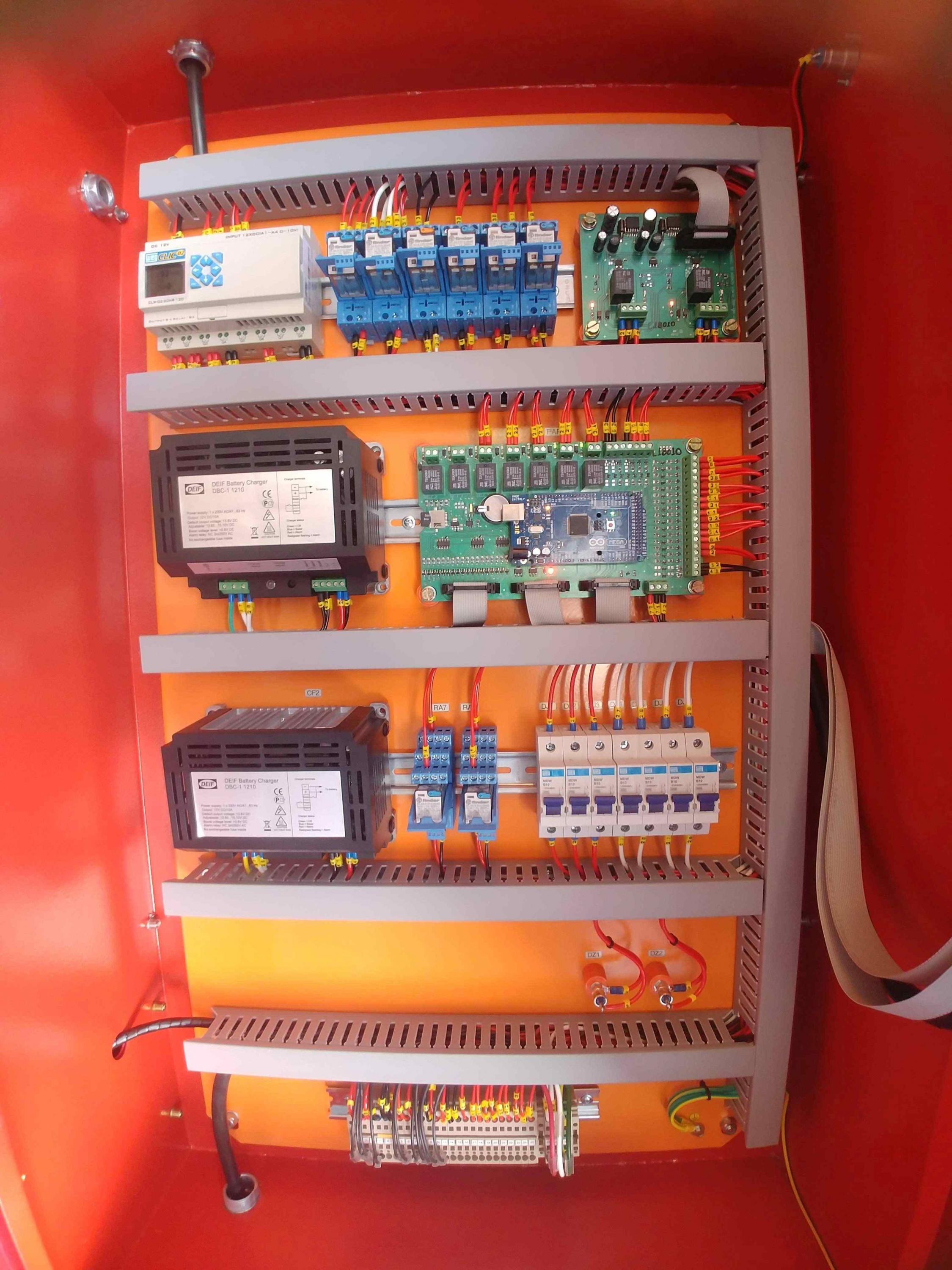

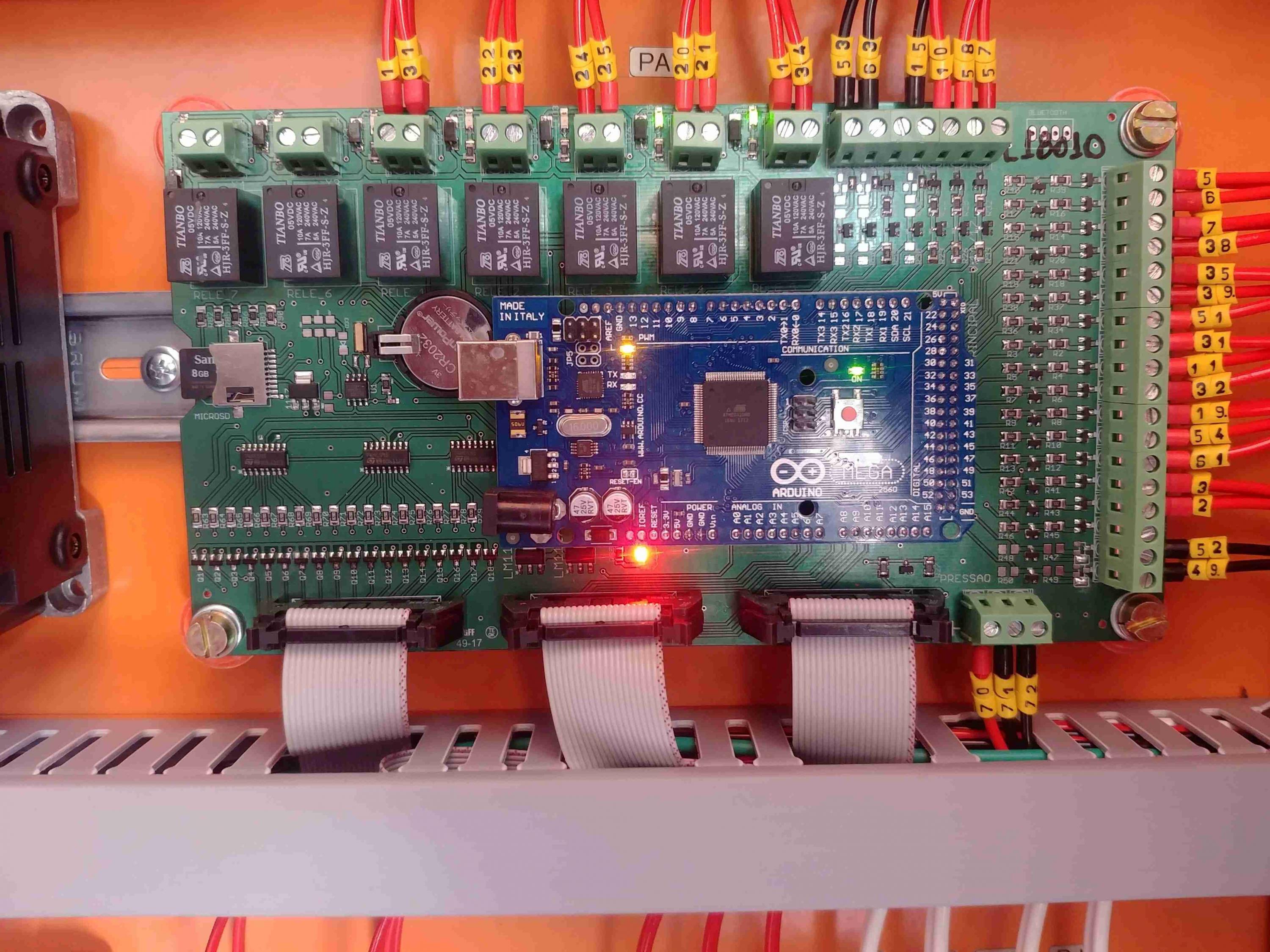

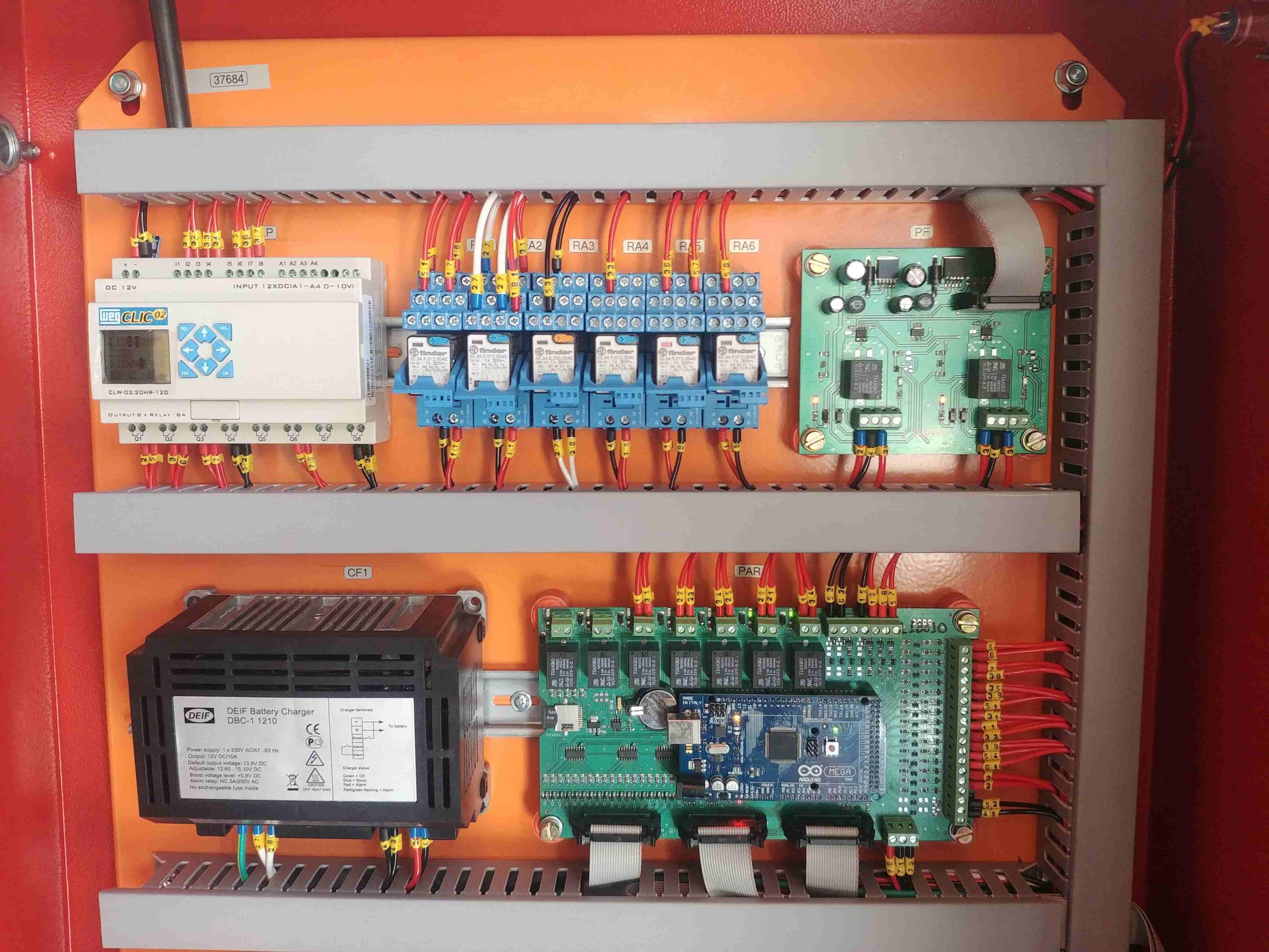

              This is a fire pump panel I've always found interesting. Uses WEG CLIC-02 PLC and a custom back board with a familiar MCU

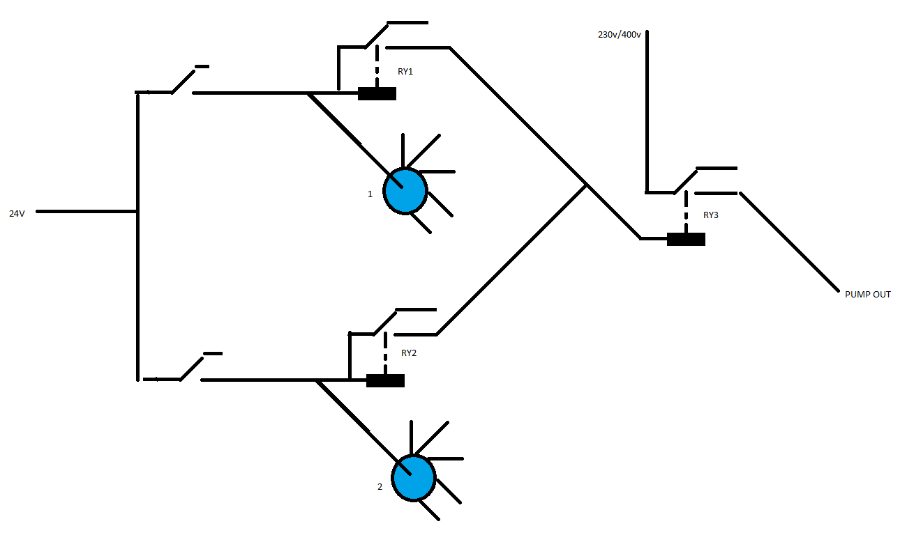

                I decided to take a step back do it all using relays at first (see the highly professional MS Paint schematic), which was easy enough to do and then worry about how I'd get this thing online...

                  Re: Another water pump automation project (suggestions ?)
                  Originally posted by Dannyx
                  The run timer is a good idea indeed, assuming the tanks fill up at the same rate each time and they're not being drained at the same time by whatever they're connected to, which would also affect how long it takes for them to fill to the brim, if ever, if the demand is high enough.
                  The valves sit above the tanks and water pours down into the tanks from what I understand from the client, so there's no risk of backflow whatsoever.
                  An indicator light for each tank and the pump would indeed look nice. I'd also add a master stop switch and maybe a manual override toggle switch to force the tanks to fill up if you want to go past the max level for whatever reason.
                  I would agree with stj in his filling one tank with the other tank. This would reduce redundancy. On the last tank filled on would have an overflow line. There could be some type of indicator to monitor if overflow ran out the pipe and stop the pump.
                  Even-though one fills from the top if the pipe is within the tank it can back up. In my schematic a flow switch which is Normal open would stop the pump once flow was stopped. I would think that one would want to have the tanks enclosed completely to prevent anything outside from entering them. One would not need valves to open and close if one monitors the output. If the last tank to be filled started to lower and the float switch opens, then the pump will start to pump. One will want the pump to continue to pump until the float switch closes meaning the tank if full. The flow switch will open if the well one is pumping from starts to go below the points that are put in the ground that allow water in. This would mean the pump is pumping water faster than it can run into the points. That then would indicate a need for a smaller pump.
                  A check valve is also used in a well system to prevent loss of priming of the pump. So, when the pump stops the prime of the pump will not flow back into the well.

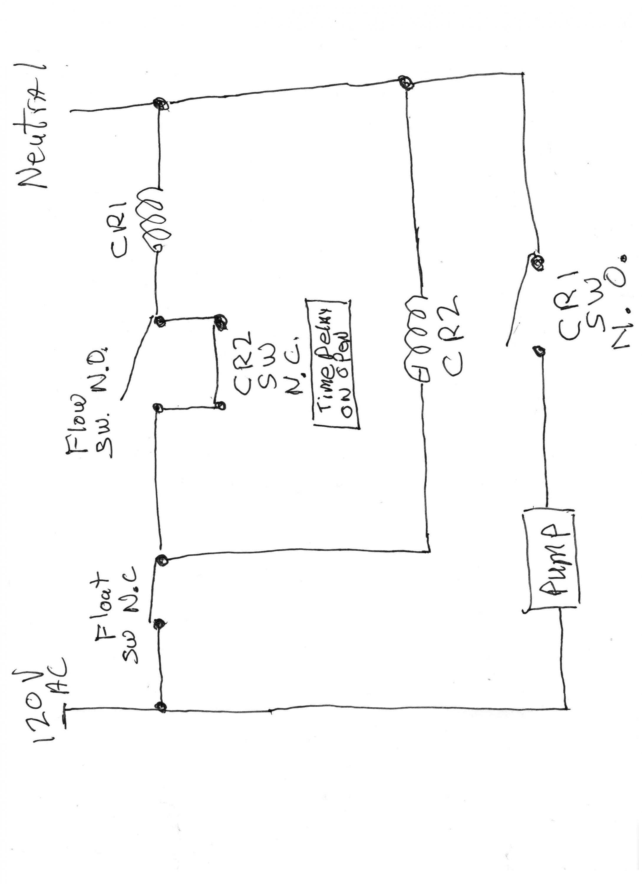

                                Originally posted by keeney123
                                He is the pump control all you would need is a relay switch to connect the AC voltage. For some reason when I uploaded schematic it rotated.
                                Explanation on operation of my pump circuit below. When float Switch in last tank falls below a given point the float switch closes. With the normally closed switch of relay coil 2 the coil 1 energizes and closes coil 1 switch. That then turns on the pump. The pump forcing water through the pipe and closes the flow switch. This will happen before the time delay can open relay coil 2 switch. As long as water is flowing, and the flow switch and the float switch are closed relay coil 1 switch will remain closed because it is energized by coil 1 relay. The energized coil 2 will keep its switch open which makes the pump dependent on the flow switch to close and the float switch to close. If the flow switch opens and the float switch remains closed the coil 2 switch will remain open and the pump will stop. If the float switch were to open the pump would stop because Relay coil 1 would deenergize and open relay coil switch 1. It would deenergized Coil 2 relay and the coil 2 switch would close. As soon as the water drops to a point in the last tank and closes the float switch the process with start all over.
                                So, this is a basic circuit. Circuits can be added for instance one looks and says what happen if Coil relay 2 burns out or does not open Switch 2 how can one protect against this. Can one add another connection to Coil relay 2 switch that when one open another closes? Can I add another circuit for overflow of tank 2?

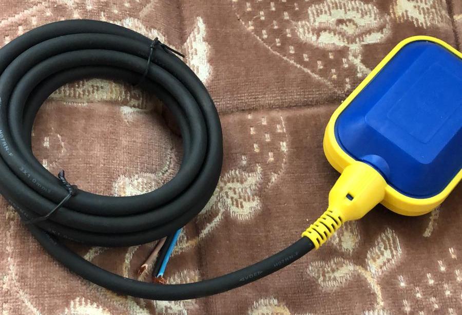

                                  I began sourcing some parts for this project, at least to get the basic form off the ground and someone was right: I'm indeed unable to find contactors with a coil voltage of 24VDC - only 24VAC, so what is the most common way of switching large motors in automation projects in this situation ?
                                  Should I go with a 230v contactor coil which you then switch via a smaller relay (probably the most cost-effective), or add a dedicated 24VAC transformer, in addition to the 24VDC supply I'd need for the logic and PLCs and other stuff IF they ever get added (or we assume they're there, for the sake of argument)....

                                      Contactors commonly have a mains-voltage AC coil. This is because they need a lot of power to pull in hard and fast, there is high inrush current until the armature pulls in and the magnetic circuit is closed. How many HP is the motor? You can use low voltage but they are hard to get and watch the coil current requirement. Get the aux side switch with the contactor for feedback if it pulled in or not.
                                      Limit switches and logic is usually done at the 24VDC level with lower current. Here you need a small relay to act as latch because the float switches will chatter due to water waves and slosh. You don't want a large pump freaking out and switching on and off quickly.
                                      So an intermediate 24VDC relay is used to switch the contactor mains voltage, and the coil can connect to pushbutton switches, logic etc.
                                      You can use a contactor+fuses or a "motor starter" or overload - these are electronic with a trimpot to dial in trip current. Something is needed to protect the pump motor against overload. It's likely a centrifugal pump which have little drama unless they get jammed.
                                          I thought of this method, but this would require TWO switches per tank: one to latch the relay, the other to UN-latch it when it's full, since one SPDT is not enough, at least not without some headaches. Since this guy only bought two, I can't do this, so I'll just have to hope the float is stable enough that it doesn't do what you describe. Here's what they look like, by the way.
