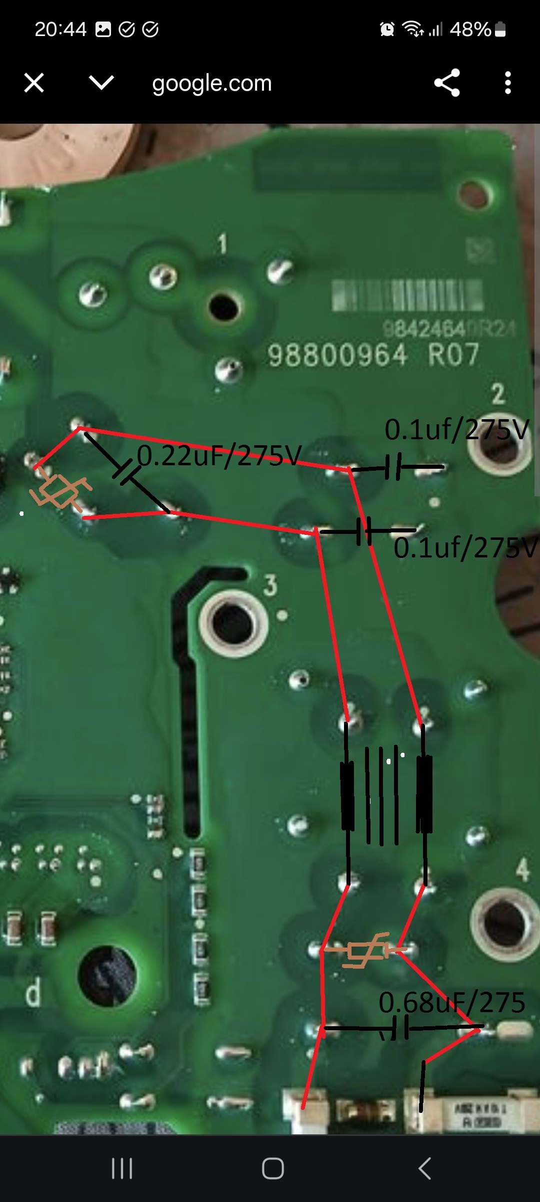

                You need to clean more.
                In those regions there are layers of AC inputs and GND after bridge rectifier.
                Any little burnt area will increase rapid burning more and more between layers.
                Sorry for poor drawing, used one of pictures to draw input circuit.

                  I connected the board to power and it shorted again.
                  I think the board has multi-layered wires so without an exact diagram I can't see how they were connected...
                    Because you didn't remove all the burnt PCB material.
                    Once it carbonises it turns conductive.
                    You need to cut out ALL the blackened material, then do repair/testing.
