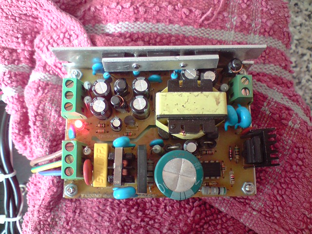

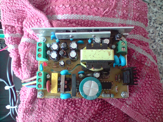

    I HAVE A TRANFORMER OUT OF A KAM LASER LIGHT THAT WENT FAULTY. IT JUST WENT DEAD SO I REMOVED THE TRANSFORMER AND FOUND A JUMPER WIRE BURNT OUT SO I REPLACED IT WITH ANOTHER ONE BUT NOW THE OUTPUT VOLTAGE HAS DOUBLED FROM 12V TO 24V WHAT WOULD CAUSE THIS SORT OF PROBLEM WHAT DO I TEST/CHECK
    PS I HAVE ANOTHER LASER TRANSFORMER THE SAME AS THIS ONE BUT IT IS DEAD I HAVE CHECKED THE GLASS FUSE WHICH I REMOVED AND CHECKED AND IT IS OK AND IDEAS WHICH ITEMS TO CHECK IS APPRECIATED
    CHEERS
    HERE ARE SOME PICS

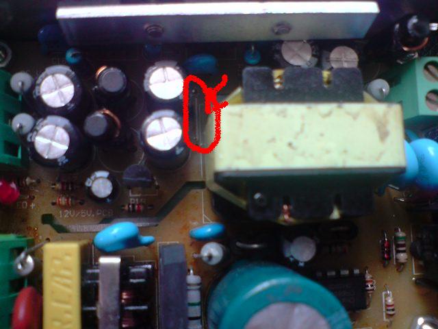

    Re: Transformer Giving Out Double The Voltage
    Are you sure it was just a jumper wire? They are normally quite thick & will take a lot of current to burn one up. What was the board marking for the jumper?
      it was just a straight line bellow the burnt wire i put the new wire on the bottom side because it was to tight at the top her is a pic
      cheers radio fox for info
        If the 24 volts is stable check the components in the feedback loop of the PWM.
            A burned trace is due to an over current condition are you sure that the laser it's driving is fine?
            Confused me there the proper term for this board is a ballast board.

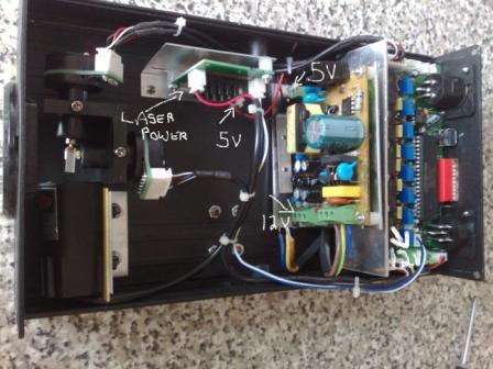

              sorry folks i haven't explained the problem properly the power board is from a animation laser there is two outputs from the transformer board the twelve volt output controls the dmx board and the motors for the mirrors. then there is a 5v output for the laser itself which when tested gave 5v its the 12volt that has doubled to 24v is it the yellow tranformer on power board that drops the voltage from 240v to 12v and 5v could this be faulty i think it is a smps but no data on the yellow thing to tell me voltages or make model her is a pic hope this helps thanks again.

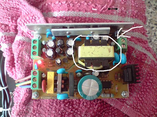

                what is this yellow thing called and what does it do
                cheers.
                Your never to old to learn
                  • 31277
                  that's the transformer.
                    That's gotta be a typo (240V). If the voltage you see on the primary of the transformer is 24 volts and the secondary has 12 volts then that could be right depending on the transformer's job. If it is supposed to step down the voltage so that the secondary could have higher current, then it most likely is fine.
                    Not knowing the circuit, is there any way the transformer could have been placed in backwards - causing a step up?
                    A transformer is a ratio device so a 2:1 could be put in backwards to produce 1:2.
                      The 5 volts looks like it may be externally regulated on that outlying board.
                      A switching transformer has a fixed turns ratio to reduce a certain primary voltage to a certain secondary voltage this can't change. The only way this could happen is if the PWM feedback is off increasing voltage to the primary.
                      Get the datasheet for the 4 pin PWM IC and check the external feedback components.
                      Unless of course the switching transformer was reversed as posted above.
                                  Guys,
                                  Are we not missing something?
                                  That beastie in the photo is a switcher not a linear.
                                  At the frequency it's cranking there are very few home meters that can measure the AC output of that thing (aprox 50khz), let alone the square waves.
                                  Another thing judging by your choice of words, your in the UK or a similar 220vac mains country.
                                  Garry, these things can be a hazard to work with if you are not well equipped.
                                  Im talking line isolation transformers, variacs, all that stuff.
                                  It is plugged into the 'mains' of your building. Bad thing to get between that much voltage and current, to anything that smells like a ground. 220 may be more efficent but it's a better killer as well.
                                  Few things to check with switchers.
                                  First is they must be tested under load.
                                  Don't run it into your laser, they tend to be expensive to replace.
                                  Since your system is a solid state laser unit, good chance the regulated output is the +5 volt. So isolate the P/S from the rest and hang a load on there good for about a half amp. Let's say a ten ohm about ten watts, over kill for sure.
                                  See if the rest of the outputs come into line when +5 is loaded.
                                  If that's the case, your laser may have been popped for some reason, and is not placing the correct load on the P/S giving you the wrong impression about what is working and what is lying to you.
                                  All the other outputs are in ratio to the 5 volt regulated control signal. So if the +5 is high, so will the others.
