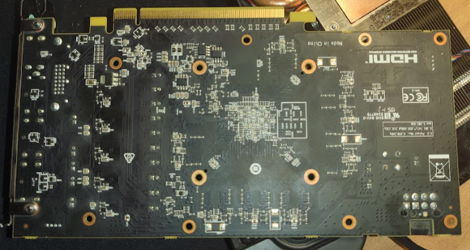

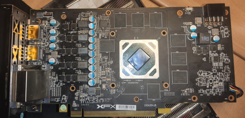

    Hey all, I've been trying to fix a rx570 XFX XXX edition 8gb. Keep in mind I've no knowledge so I've been doing this solely using tutorials. Any help is appreciated.
    8pin connector led is open when pc boots, but nothing else happens (no image).
    Fans don't spin. Before the gpu broke completely, the fans used to spin at max rpm at the start and there were some wonky things happening in general, so it was probably defective already.
    Everything below is based on this video: https://youtu.be/2Yz7HfzggYc?si=UM8VOndmqJX1gfgJ
    PCIe pins are all ok. They have similar resistance and not one is faulty. PCIe capacitors are all ok also, they have similar resistances.
    12V pin is ok. 3.3V is also ok.
    I tested the 8pin connector socket for short circuits but didn't find anything wrong.
    No visible damage/burnt components.
    I booted it with the heatsink unscrewed to check voltages and here is what I gathered:
    Everything below is based on this video: https://youtu.be/5oD69tIrU7c?si=cQbnSDhlDMxwOkT9
    GPU core doesn't heat up at all. Stays cold.
    12V voltage is ok (C157, C151).Click image for larger version
    3.3V voltage is ok (next to C157, C151).Click image for larger version
    At the 5V regulator on the back on the 3 legs I read 2.5V, 3.3V, 12.V and opposite of them I read 3.3V. Didn't read the suppossed 5V.Click image for larger version
    At the 1.81V on the back I correctly read 1.81V. One thing I noted was everytime I touched the probe on it to read the voltage, the fans spun for a split second.Click image for larger version
    Display rail read 0.92VClick image for larger version
    VDDCI/memory controller read 0VClick image for larger version
    1R0 (memory) read 0V
    GPU read 0VClick image for larger version
    Thank you and I appreciate the community this forum has developed
