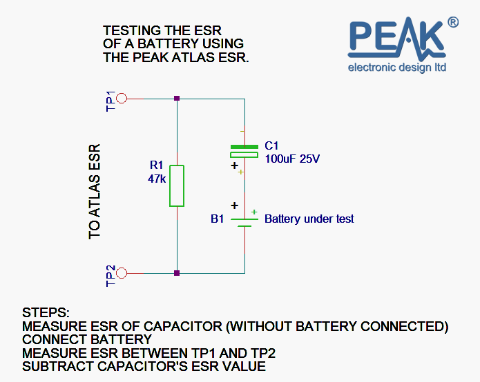

    Hello, I have ESR70 and this schematic was sent to me.
    1.Can I use some non electrolytic cap so connection polarity does not matter?
    2.What cap would be best? super low ESR and small size would fit in standart RCA JACK?
    https://canada.newark.com/lumberg/15...mm/dp/05AC9675
    3.Is resistor needed, why?
    4.Anyone compared such measurements with proper meter for battery internal resistance?

      You should use a cap as small as possible that has a very low ESR, ideally much lower than of the battery. A plastic capacitor will work if you can find one that has low ESR at the frequency your meter tests at.
      The resistor is to equalize the jig to prevent the meter from damage or deal with dc offset.
