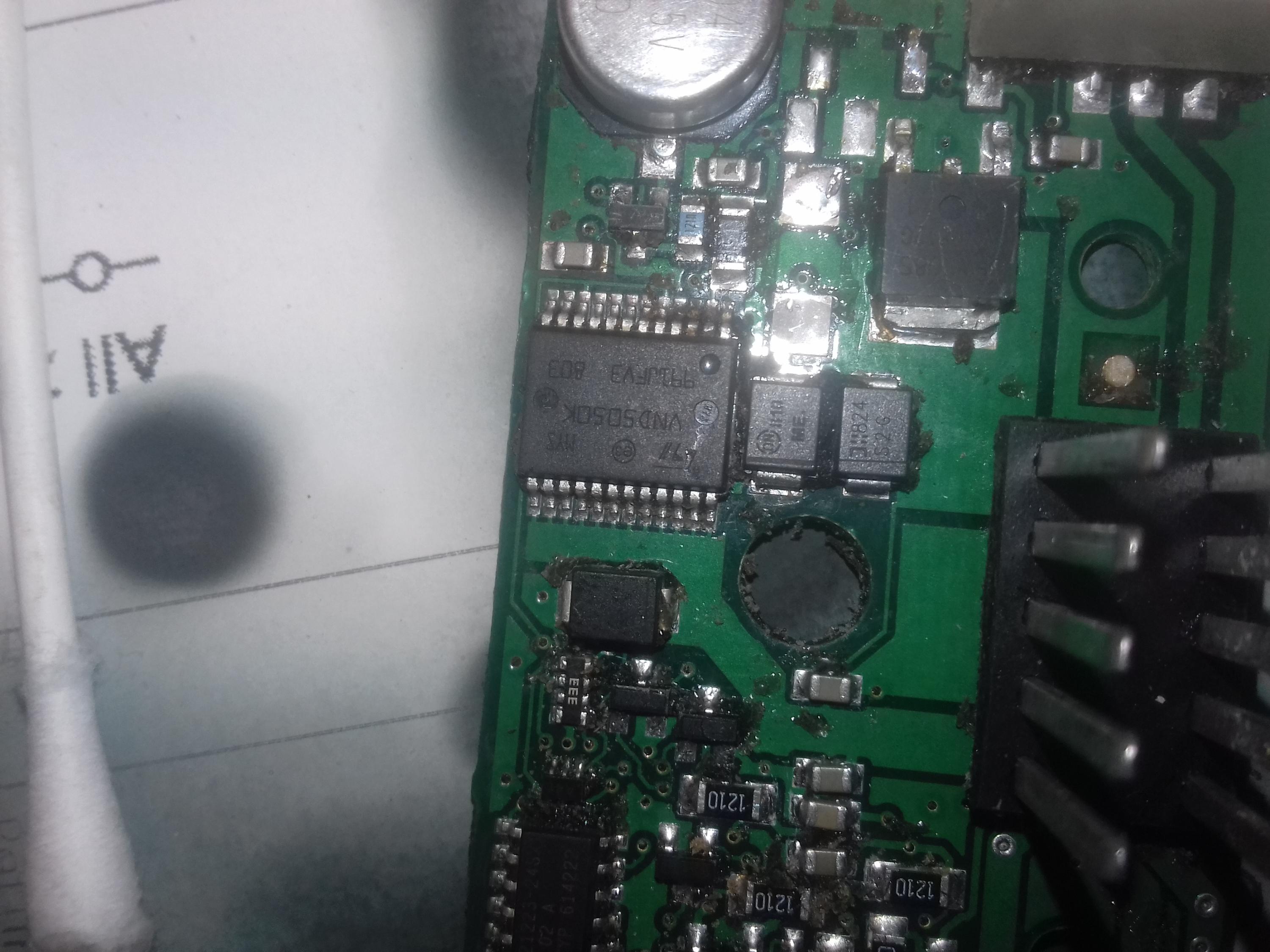

    what are these black things to the right of the ic chip . ? both test as shorted .

    The one on the left could be an ON semi 1SMB26AT3 ,marking ME https://cdn.badcaps-static.com/pdfs/...70e6d21d8e.pdf

      S2g-13-f

        i found ME marking as an inductor .. will see if it measures any inductance .

          ok i only just thought to look on the board for same marked components and found the same S2g one and it measures as a diode on the board . i need to remove it to know for sure .
          that leaves the other one marked ME . it doesn't measure any inductance so this might well be a shorted tvs diode as suspected .
          will see what pins it connects to on the ic chip if any .

            I`m fairly sure its a TVS diode connected to the high side driver chip VND5050K https://cdn.badcaps-static.com/pdfs/...5759eb738e.pdf

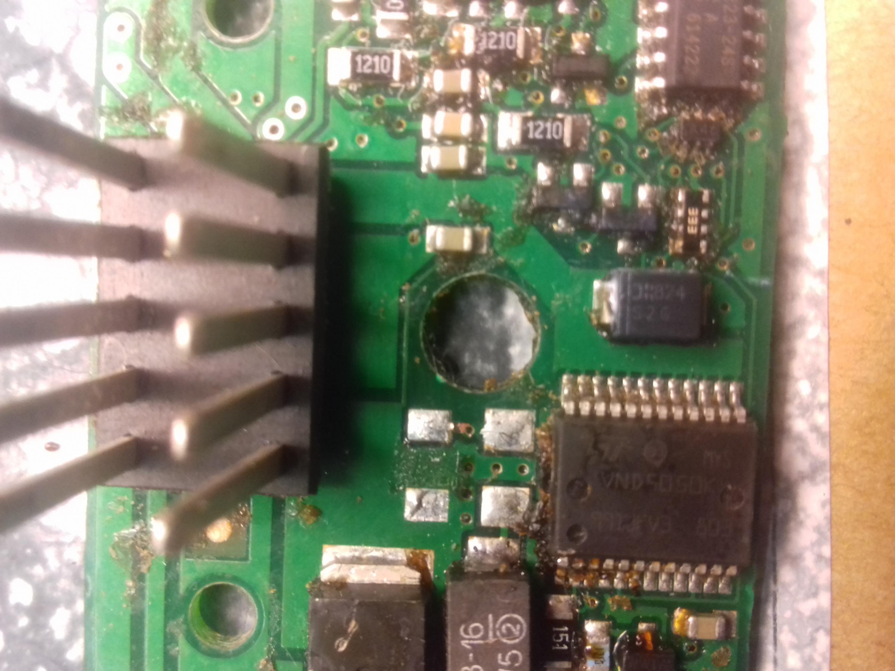

              it doesn't seen to connect to that ic . i do know these are wired in series .. here is a pic with them removed . and yes i spotted the broke trace ..where the pass through is .. right where they join together .

                  the stuff is potting compound shit . took ages getting it as clean as it is .. its a control box for john deere garden tractor . box id ..AM137667

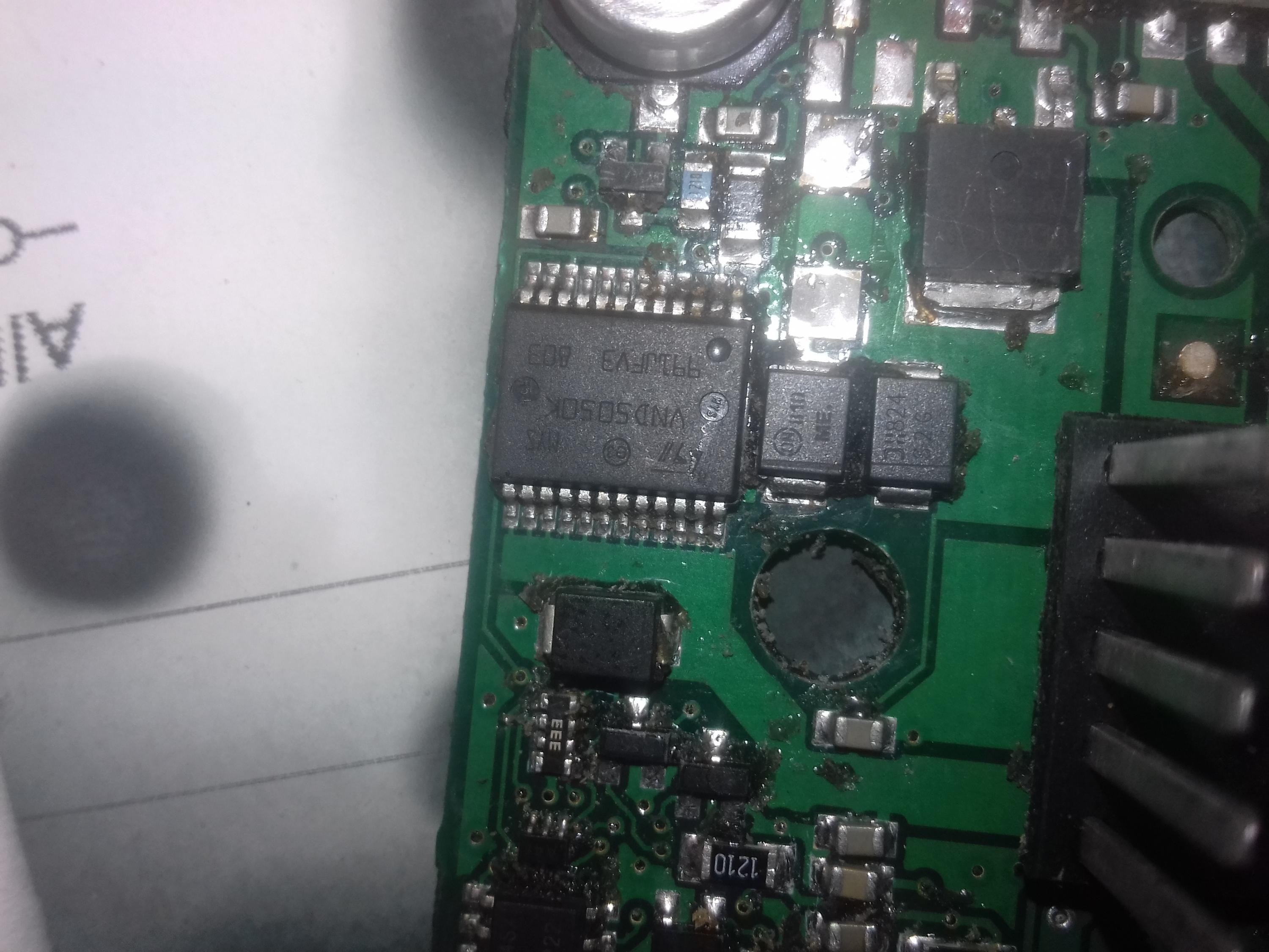

                                      have ordered those parts anyway just in case i chose the correct ones .

                                        soldered parts in .. fingers crossed it will now work ..
                                        new parts aren't marked quite the same as originals .
