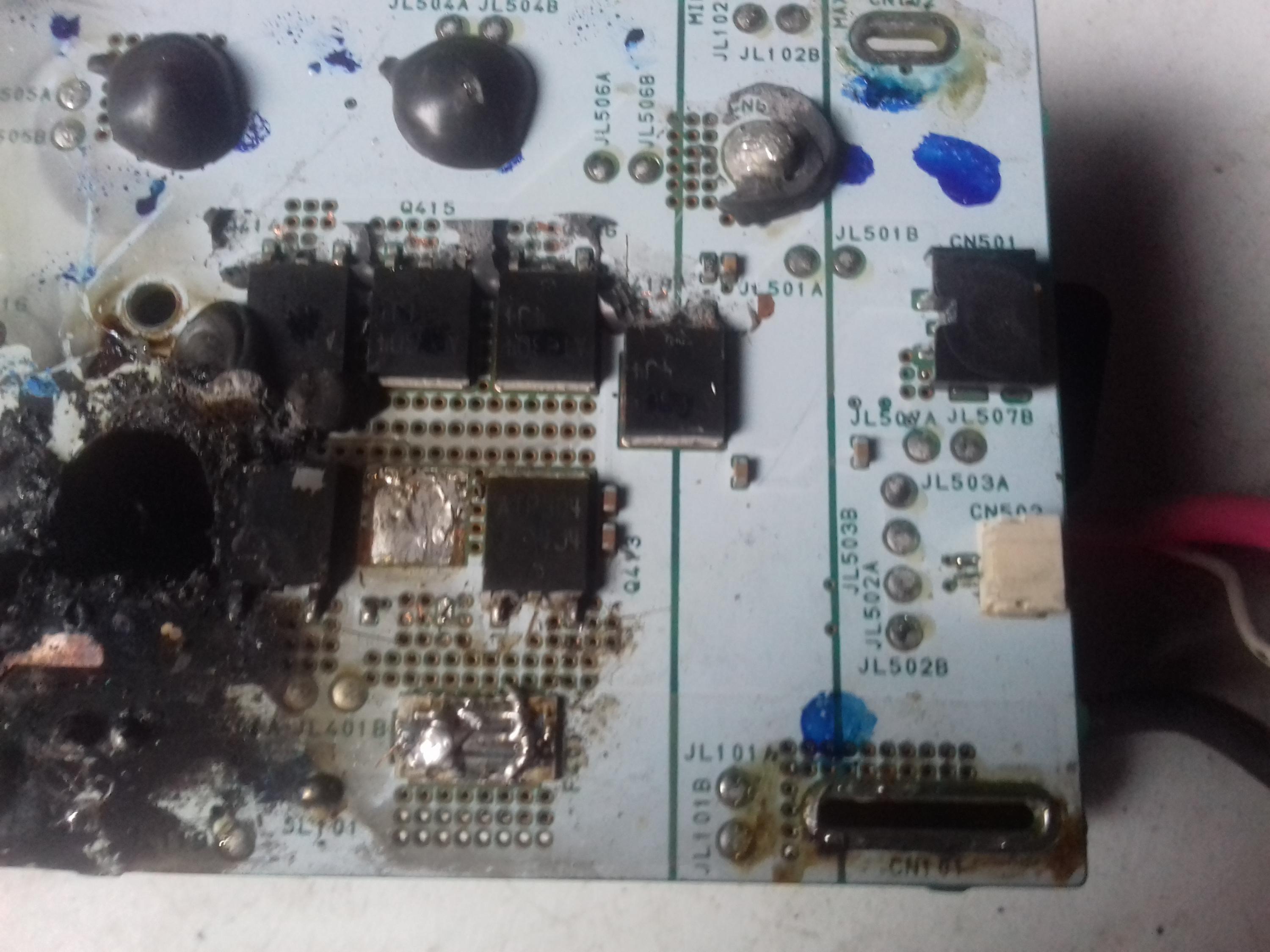

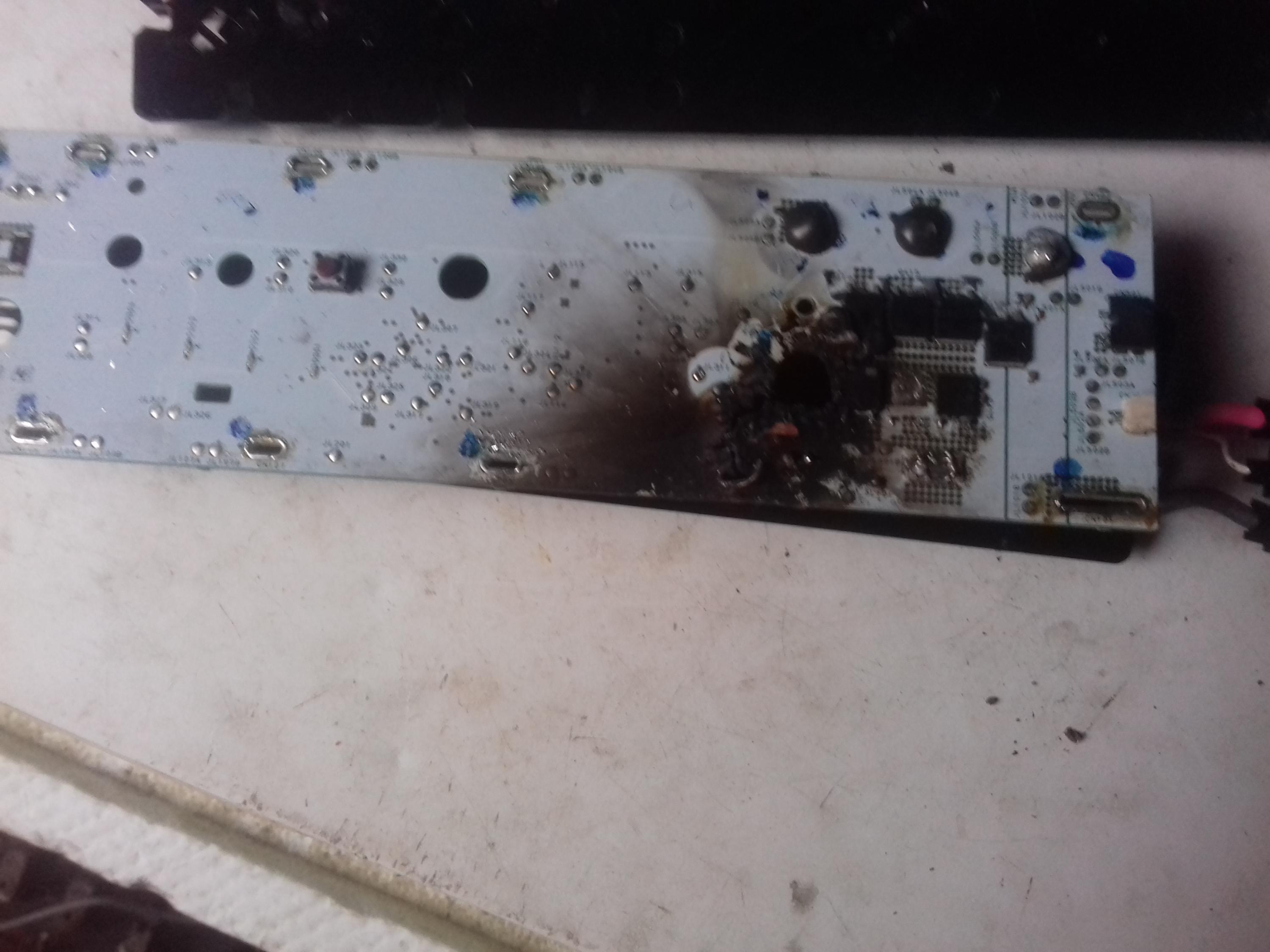

    i have an e bike battery pack in need of a new bms .the old one went up in smoke . its a yamaha one .
    was wondering if a say a cheapo 30 amp one would do it ? and would it be possible to use the original working charger as it has 4 connections .
    can post pics later if needed .

    Please post some pictures of this BSM balancing protection board that you have maybe there might be one that would work correctly you might be able use some of what you have with some modifications
    ( using your charger to a new BMS balancing protection board )
    I would probably recommend a 100 amp one for more headroom if I were doing this repair and upgrade it for more amperage capabilities
    If you would post what voltage and what type lithium ion batteries that are being used I would help you find one

        its a 10s battery pack .the old bms pcb is a total wreck . i will get details of the bike off the owner . as i don't have it here .
        will post pics later .

          Re: choosing new battery bms

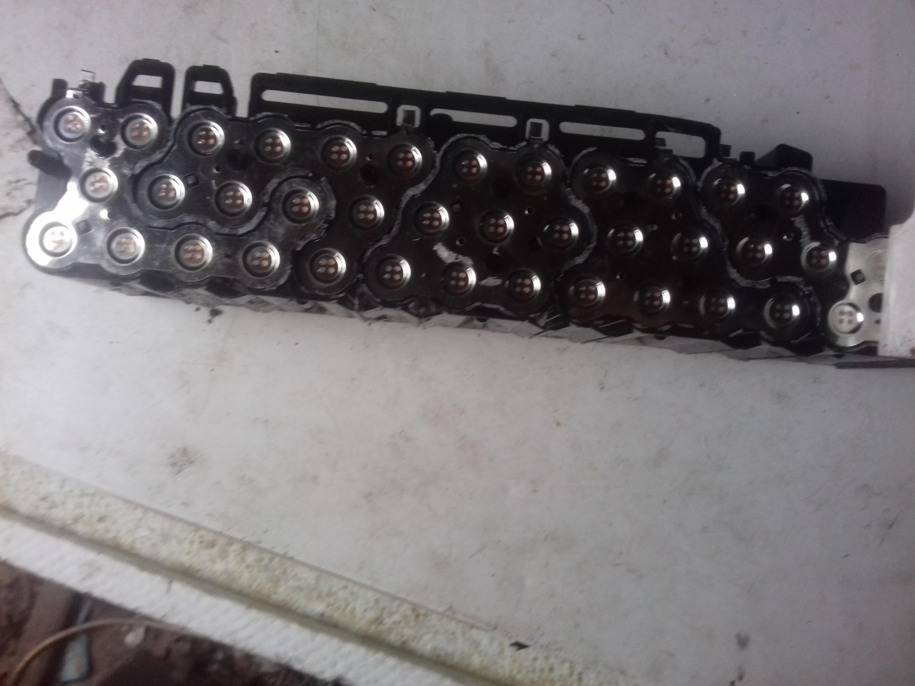

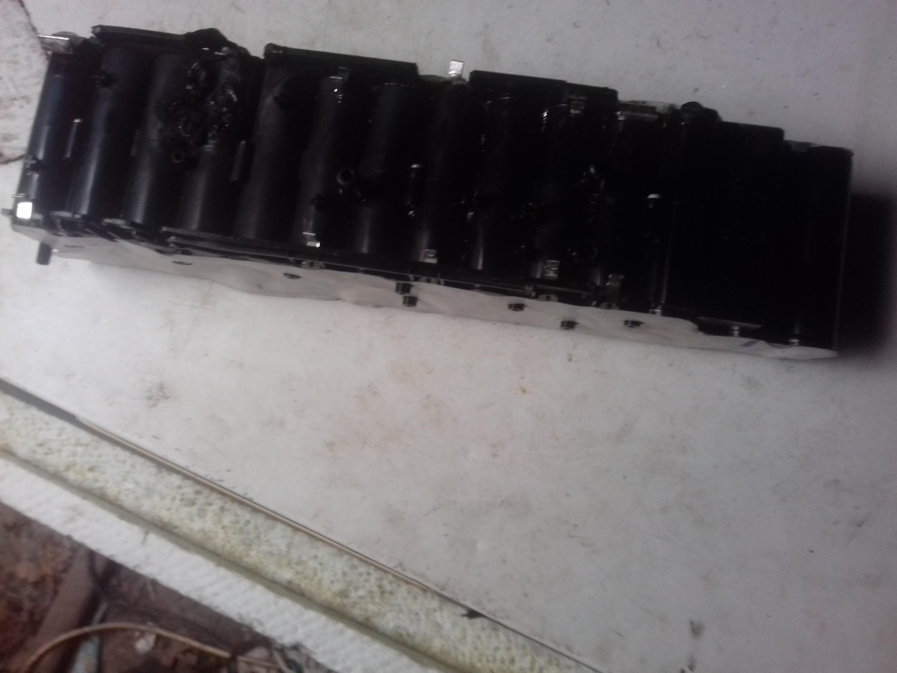

          some pics
          • eccerr0r
            Solder Sloth
            • Nov 2012
            • 8698
            30A probably would work IMHO for most cases at 10S but only if the motor was rated for around 1HP or less.
            As for the original charger, who knows what the extra wires are for...need to do research...
            Looks like the batteries took a bit of a bite there... ooh that doesnt look good...
                yep i had found a shorted fet and blown double thermal fuse but wanted to see the other side of the board and it decided to self destruct whilst removing solder from the tabs . yes i realise now i should have disconnected the main +- first .even so it still could have done that . guessing it was a bit of solder shoerted it .. scared the shit out of me as i had to pick it up and take outdoors whilst fire was shooting out of it . wish i had a vid of it but didnt have time for that .

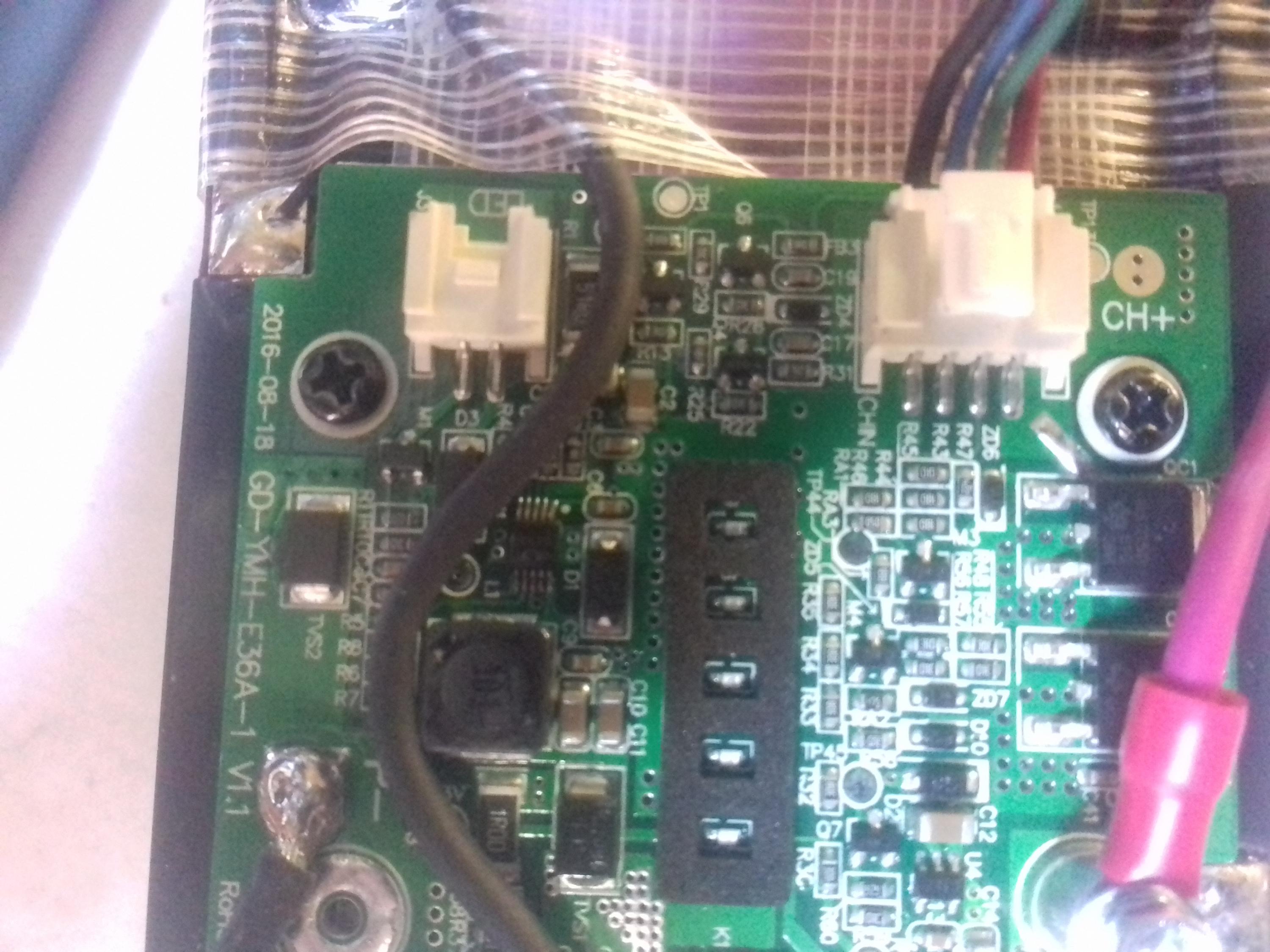

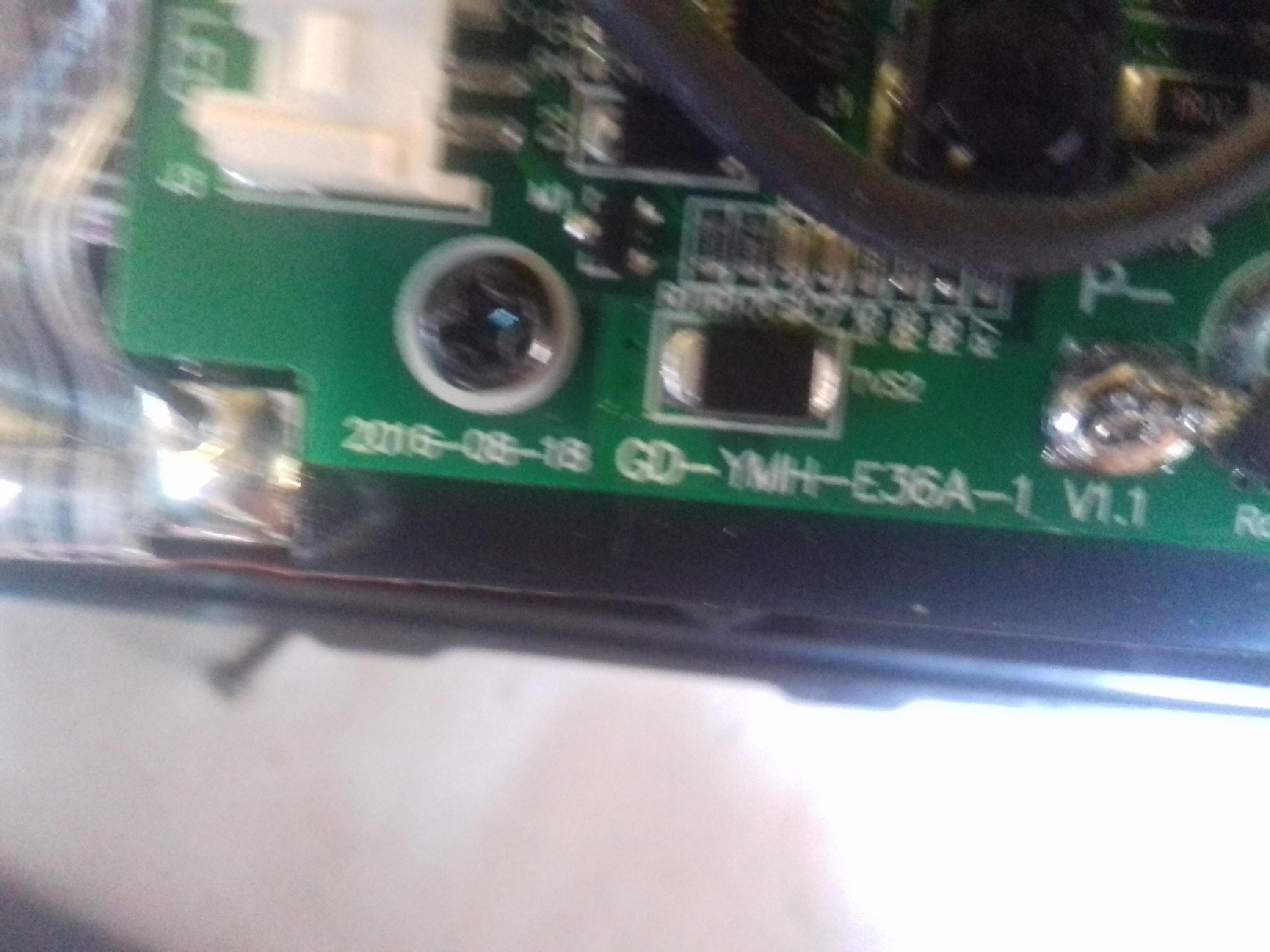

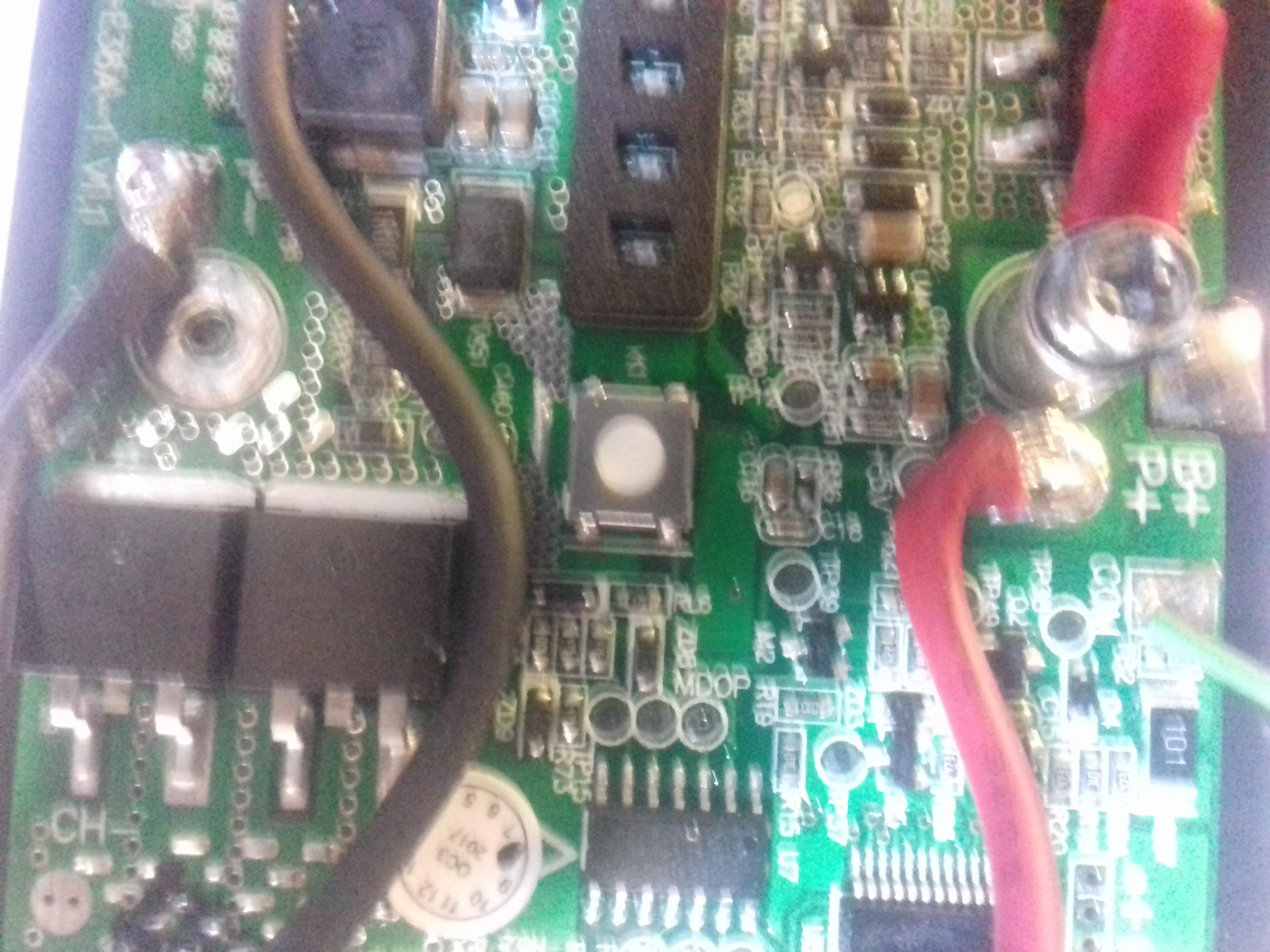

                                bms arrived today and its pretty small . will fit it anyway and see what the charger thinks of it .
                                • petehall347
                                  • Jan 2015
                                  • 4426
                                  • United Kingdom
                                  as suspected with new bms wired in it doesnt charge ..i have another battery pack here that is a copy one . i was trying to find the same bms as fitted to that one but cant find one . i have pics of the wiring . will post below .
                                  black blue green red go to the charger port .

                                    Is this the type of charger that requires voltage from the battery to activate the charging circuit
                                    • petehall347
                                      • Jan 2015
                                      • 4426
                                      • United Kingdom
                                      it looks that way .
                                      even if i get it charging i dont know what to do about the data wire that goes to the electronics from the battery .
                                        • Jul 2011
                                        • 6037
                                        it looks that way .
                                        If it has this it would not be useful unless you disable this part of the circuit
                                        Can you find output side of the power supply to bypass this part of the circuit
                                        Or just get a switching power supply that can limit current and voltage and be done with it
                                        Some of these chargers use a temperature sensor device for monitoring the temperature unless it also monitoring the voltage and current algorithms some way if it this type you do not have a very good chance of getting this to work correctly
