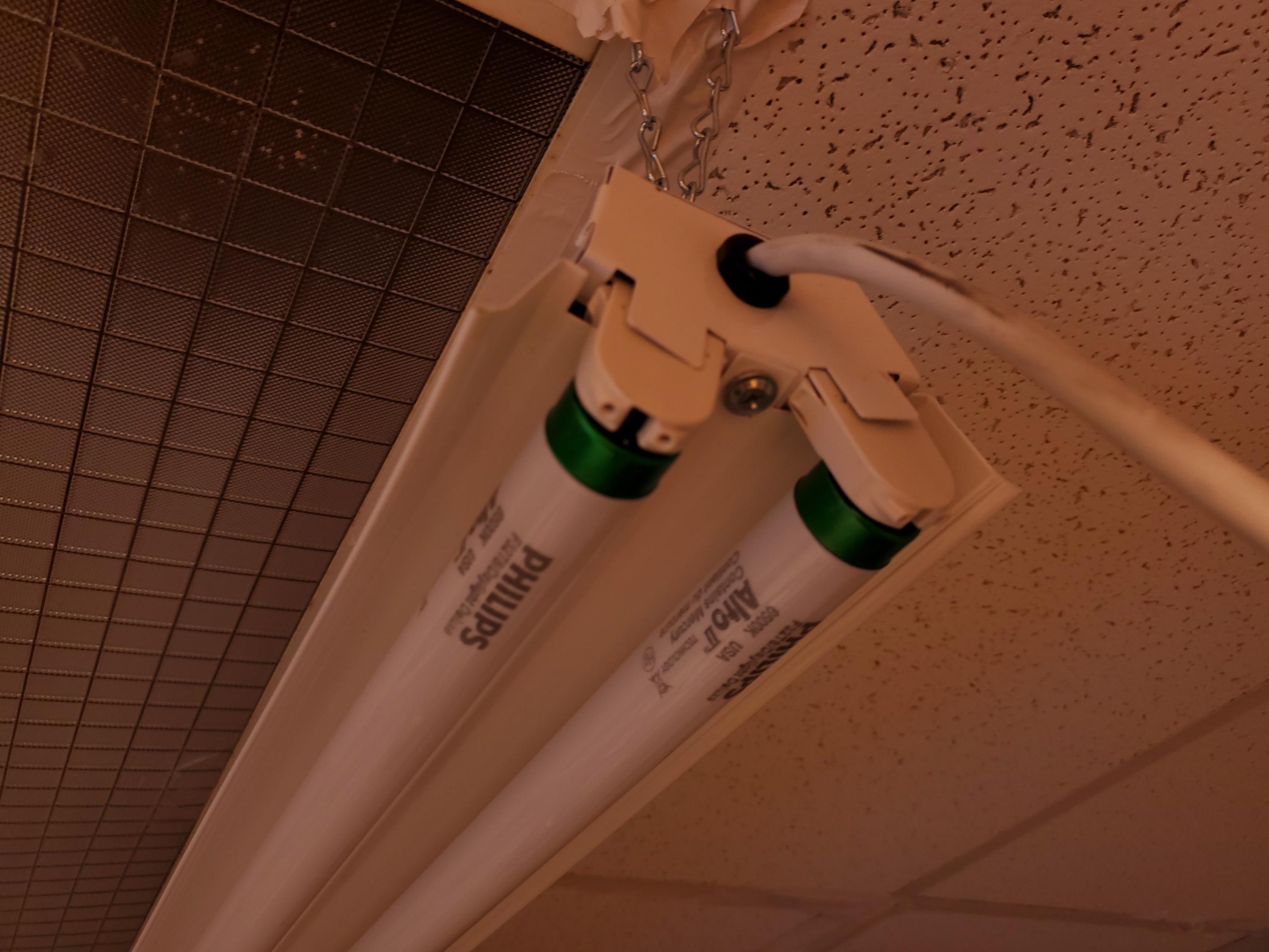

                                    • RJARRRPCGP
                                      • Jul 2004
                                      • 6304
                                      Re: Light bulb flicker when turning on after long time off.
                                      Without removing any of the bulbs:
                                      (The cord was scuffed when I bought the fixture, IIRC, LOL)
