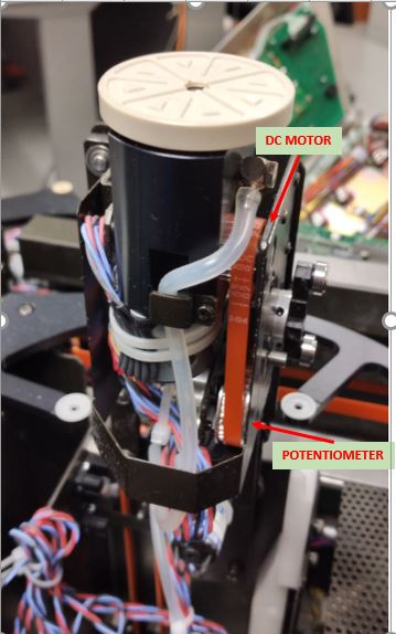

    I am looking for a replacement for a Magneto-resistor type potentiometer model SMP-1504 by manufacturer SAKAE TSUSHIN KOGYO CO., LTD. I have already contacted them but they no longer manufacture this type.
    What the manufacturer have are inductive types which they say is analog output and is not compatible with the Magneto-resistor type which is digital output. I am not sure why is it not compatible that but I did test it with according to specs input voltage of 5vdc and its out of 1.5v min and 4.5v max is according to specs also.
    The potentiometer turn together when the DC motor turns through a belt.
    The input of the potentiometer is from a 5vdc reference voltage and the output is into an OpAmp as indicated in the red arrow.
    Please help me analyze and suggest a replacement for this. Many thanks to all of you.

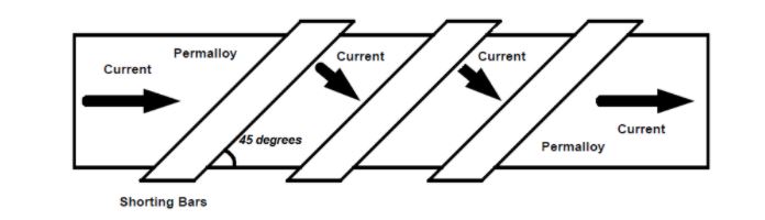

      Magneto resistors are often constructed of long thin films of permalloy. To increase the sensitivity of a permalloy magneto resistor, shorting bars of aluminium or gold are placed on the thin permallow films under an angle of 45 degrees. This forces the current to flow in a direction of 45 degrees relative to the length of the film. This is called a barber pole configuration.
      Visualization of the barber pattern used in magneto resistorsPermalloy fim magnetoresistor using barber pole pattern of shorting bars
      a typical AMR magnetoresistive sensor is constructed of a combination of 4 permalloy thin film magnetoresistors, connected in a wheatstone measurement bridge.

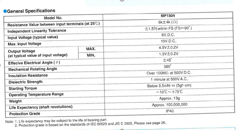

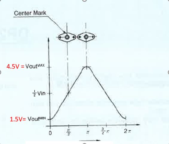

        Re: Magneto-resistor Digital Output Potentiometer
        Wow, life rated 100,000,000 shaft rotations. The original is an analog angle sensor, +-45 degrees (sine).
        Since the sensor is Japanese, it's likely all the parts are custom from Japan.
        If the sensor is dead and does not work, I would take it apart.
        You could buy a new raw MR sensor. Just have to match the magnet strength and package.
        MR sensors just ignore digital/switch type sensors.

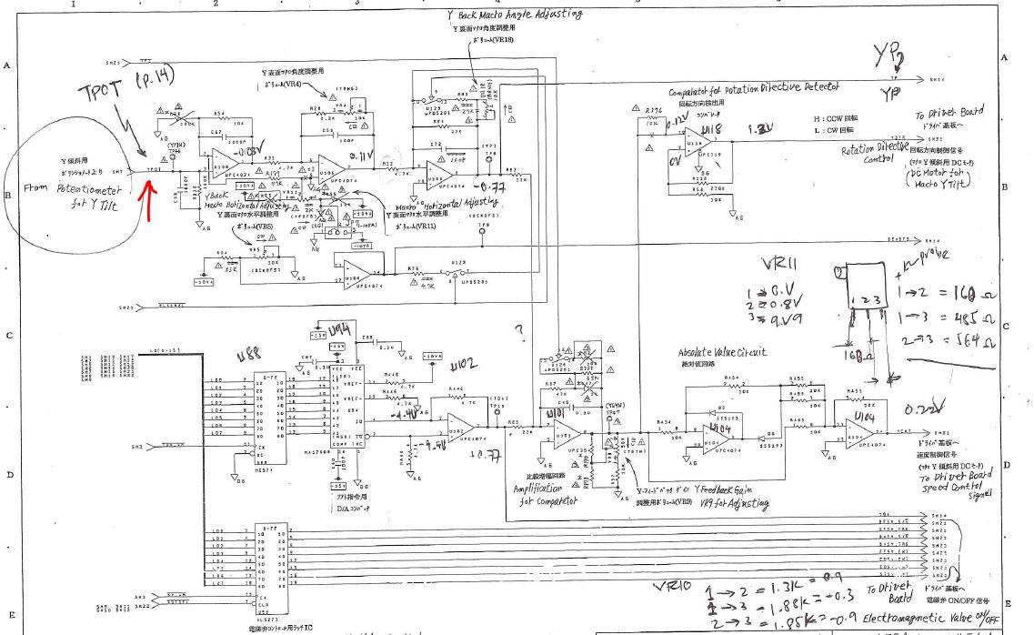

                I look at the schematic, the input of the circuit is for interfacing with the analog output of the sensor.
                What is wrong with the old sensor?
                Do you have high res or PDF of the schematic?
                What is this unit you are working on? Make and model?
                  Hi Budm,
                  Attached is the scanned copy, I am not sure if I can post the make and model since might be infringement. It is a wafer inspection machine in which the wafer is being tilted in x and y axis. Also going up and down for more focus on the microscope. The old sensor is not accurate anymore and when I tested it, at the max point is 3.7V only as compare with good of 4.5v with input of 5v. the min is within range of 1.3v as compared with the good one of 1.5v.
                  Again I am looking for advice if anybody is familiar with magnetoresitor/AMR technology. What is digital output for this device means. The OEM said that this is obsolete and they a new technology that uses inductance, still contactless but analog. According to the schematic, I dont think it will misbehave as long as there is voltage coming in to that OpAMp, digital or analog?
                    The "digital" sensors are a switch, on/off. The "analog" sensors are a continuous voltage output. I think the Japanese manufacturer got confused which type of sensor you are looking for: not inductive, not digital. It's analog.
                    For sure your sensor has low output? With 6VDC power, datasheet sensor max is 4.5V+/-0.2V and I can't see if it runs from 5V or 10V power. Its output goes to TPOT TP46?
                    Low output can be caused by: a bad MR sensor, weak magnet, or a large magnet air gap, or a bad op-amp U106 uPC4074 (not likely unless ESD damage) loading down the MR sensor.
                    The original circuit board has provision for calibration, there are trimpots to cover a wide range of sensor specs. You might be able to calibrate to get this sensor to work, assuming it did not drift or age badly. It might even have been this way all along: 1.3V to 3.7V
                    Does the board calibrate?
                    VR4 is gain (inverted)
                    VR5 Back Offset
                    VR11 is Offset
                    JP7 looks like for calibrating TF Offset, whatever that is
                    VR18 Back Angle gain
                    I see many optional resistors (with a X cross-out on schematic) that were to accomodate MR sensors with different outputs.
