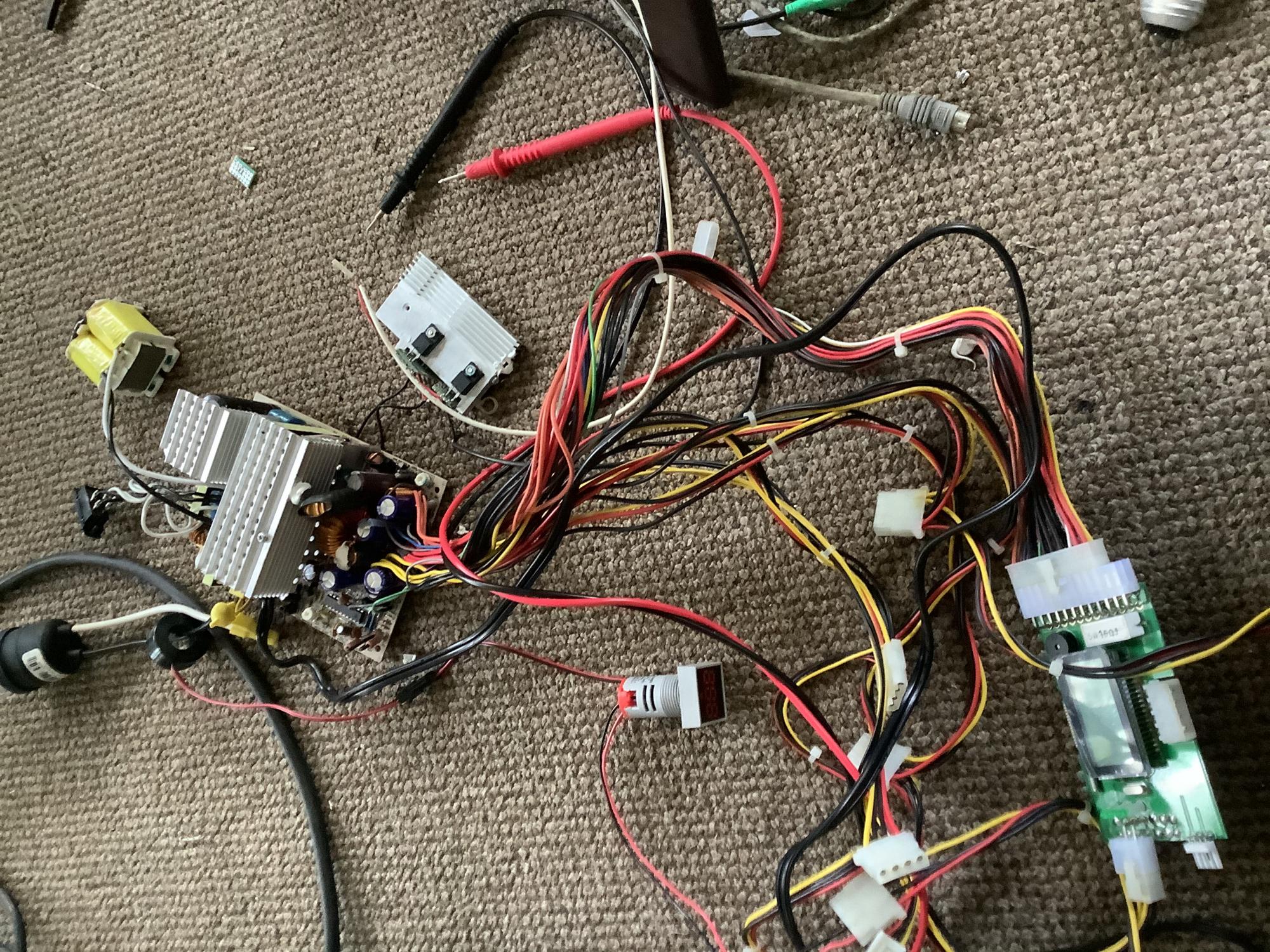

      What I am asking is will the modification to the switching power supply board and hooking it to buck converter
      I know I have to add on diodes and capacitors for 35 volt rated capacitor on the auxiliary power supply board where she taps off the switching transformer output pins would this work or maybe 50 volt rated capacitors ones
      How would you figure out what your maximum amperage output would be just from the auxiliary power circuit not to the buck converter
      Do you use the rating for the -12 volt rail and this would your maximum amperage or there another way to figure out what the maximum amperage is for the transformer tapped output

              When I do the switching power supply board modification I will post some pictures of it so you can get an idea of how she does this modification on the switching power supply board it only works correctly for isolated tap winding for 3 / 5 / 12 volt output and you tap from 12 volt to 3 volt which would the outside two taps on the winding you do have to use a volt meter or scope to figure out where you take the power from
              I have one power supply that I tried this on but it would not work because it only has 5 volt and 12 output only from the main switching transformer
              I took out the transformer and saw that most of the mounting pins are tied together and they are tied together on the board as well on the secondary winding
              I have another style that has independent winding taps that are not tied together on the board so I going to try on this power supply board later on today and see if get around 22 volts AC if I do then I can go head and make the auxiliary power supply board and try this out and see what the results are but because these switching power supply were bought new / old stock surplus and have crap-e capacitors on it and they pop there tops already I will have to replace all the capacitors first before I can do any testing
              One note these switching power supply as far as I know have never been used because they are very very clean inside

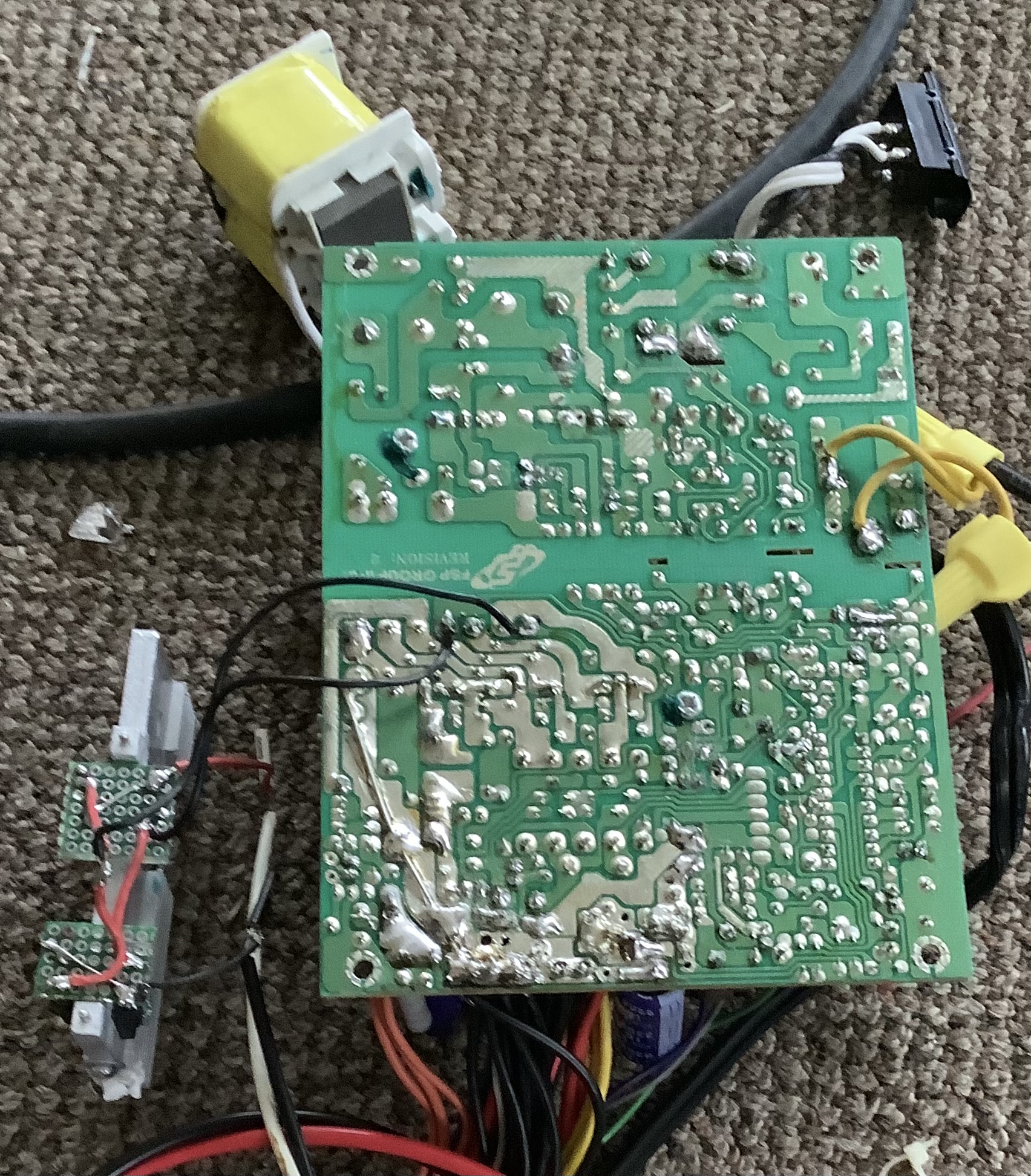

                                    Actually I can get about 60 dc volts with a 100 watt light bulb hook up to a Schottky diode rectifier setup with no capacitors on the output yet but it does pull the power rails down a little bit ( this is with a incandescent light hook to the output ) but it does seem to work I do not have a setup yet to test the short circuit test yet but this will come next
                                    I am a real dum a** yesterday when I was putting back in the choke you can put it in two different ways and of course I would put in the way it should not go in but had remove it because I need to hook some wires back up to the board and there in much remove were these go in
                                    And of course I blew the fuse on the board then I hooked up the incandescent light bulb instead of the fuse for now the bigger light bulb is a 300 watt bulb I use several times for troubleshooting

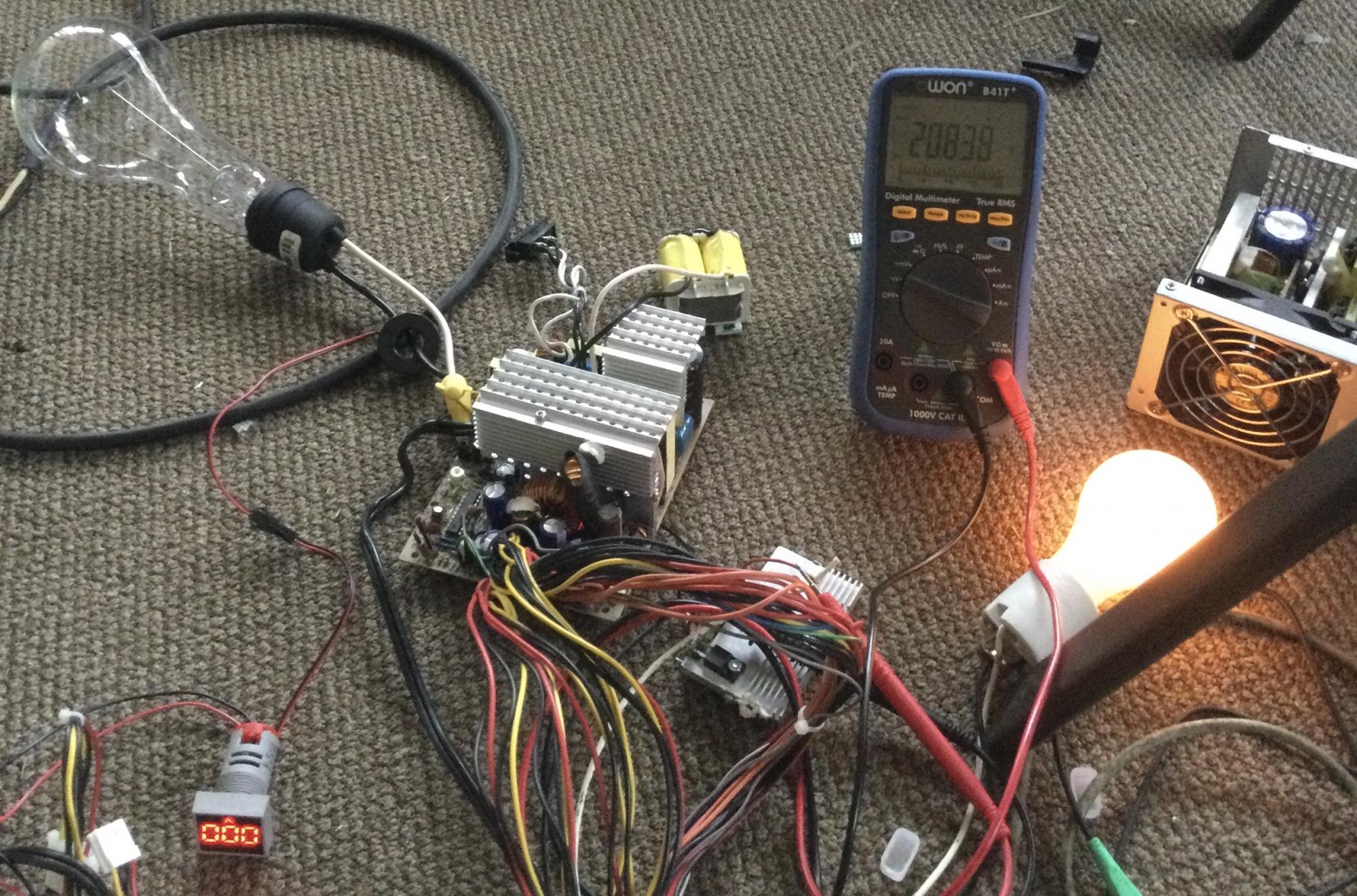

                                      As you can see in the picture with the incandescent light bulb as the load I am getting around 20 volts but this is with out capacitors on the output I have not gotten that far yet tomorrow is another day to work on it some more
                                      Does it look like it do able I think it might be but more testing is needed before I come to a conclusion about this modification to this type of switching power supply
                                      There is a correction about what I have above it was supposed to be have been that with the load the voltage is about 21.00 volts and with no load it about 60 volts I could not edit it anymore
                                      Unfortunately I do not have very many 100 volt capacitors and ones that I have are very low UF values
                                      So it might be awhile before I can get back to this project because right I do not the funds right now to do anymore to it
                                      More to come

                                        I hooked a couple of 150 UF capacitors that I have on hand and to see if this makes a difference and it does the output the capacitors were in parallel configuration
                                        With out a load the voltage is 60 volts with a load of 100 watt incandescent light bulb the voltage is about 52 volts
                                        So now I have to figure out what the UF value need to be for best performance and go from there
                                        Now there is a slight issue with the tester that I am using to run the switching power supply it is showing a over voltage on the 3 volt rail and the 5 volt rail sometimes and under voltage for the - 12 volt rail if you are running the auxiliary power supply board however if you load the 12 volt with about 2 amps or so everything goes back to normal
                                        Which is very interesting results I was not excepting these results
                                        Now these might change when I get the right UF value for best results because with out capacitors the over voltage on the 3 and 5 would be going on all the time with no load on the 12 volt rail
                                        Also the 300 watt incandescent light bulb is just glowing a little bit and my current sensor meter ( has been modified to run on 5 volts rail ) is showing one or more amps with the 12 volt rail is load with about 2 amps and a 100 watt incandescent light bulb on the auxiliary power supply board
                                        ( now on my bench power supply with the voltage maximum 50 volts it is showing about 500 milliamperes so the total load might 3 amp on the secondary side of the power supply )

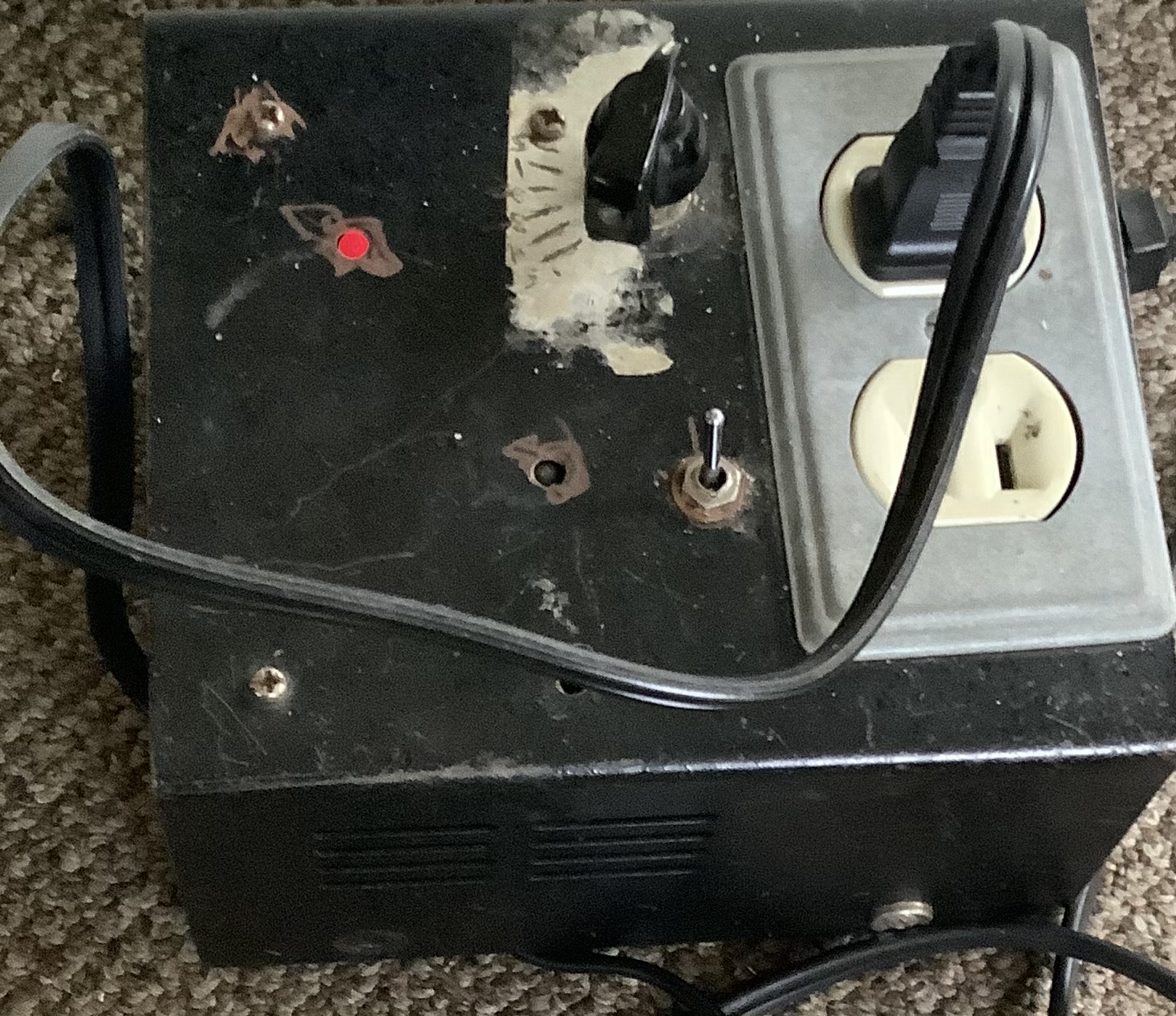

                                        Because the isolation transformer are out of my budget for what I am willing to spend on one
                                        Now I found one on eBay for $100.00 that would handle 3 or 5 amps I can not remember correctly which one it right now and might consider this one but I would have to have this amount of money on hand and have nothing else or project that are not a high priority to do at the time
                                        Now if anyone has a suggestion for buying one or making one with out it becoming a major project I am all ears
