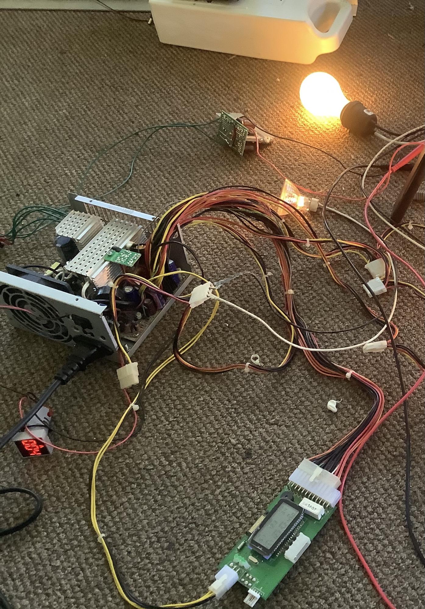

        Update

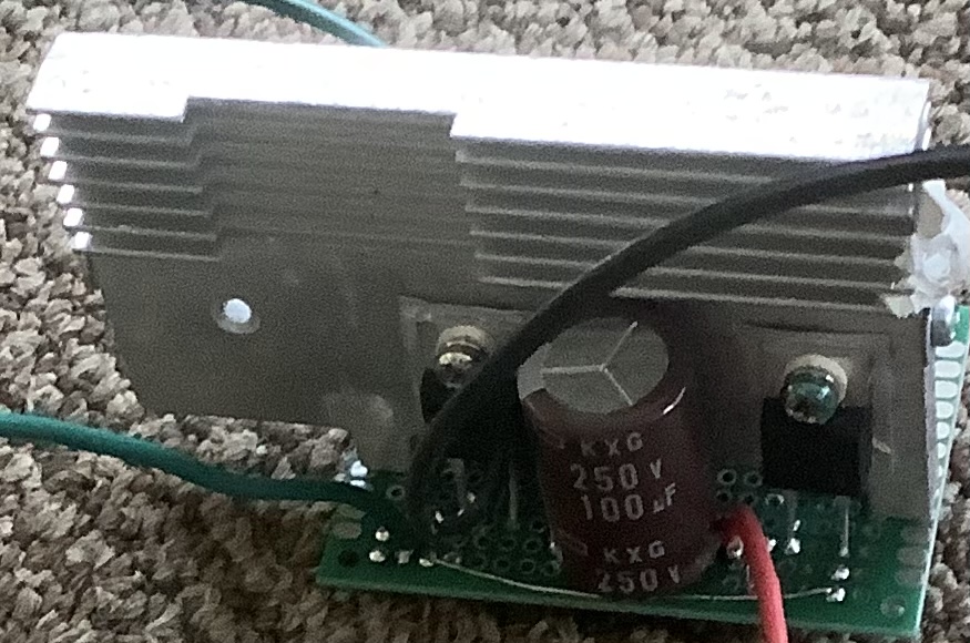

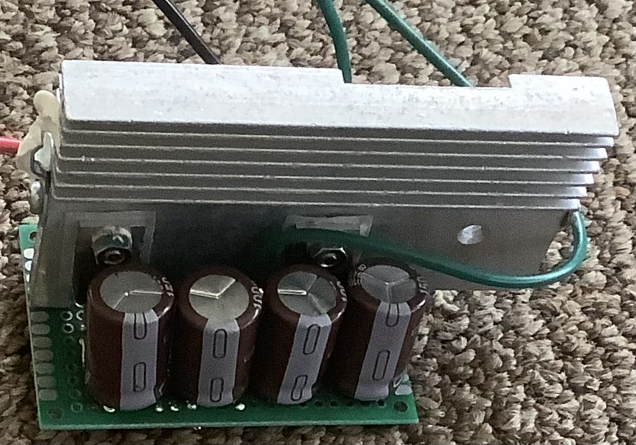

        I made a proper circuit board for this auxiliary power supply board and did some testing today with it

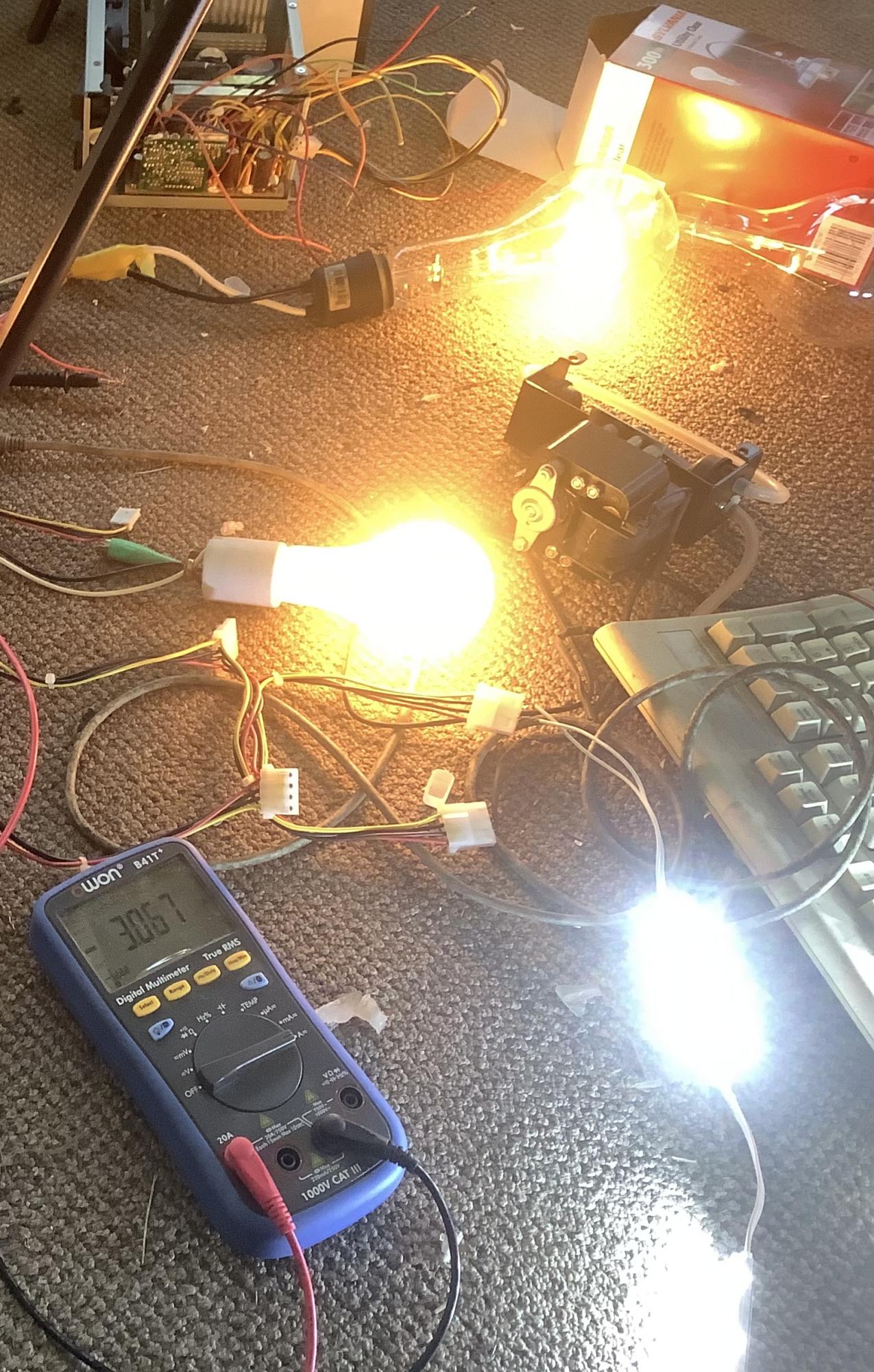

        I used ( 4 ) 150uf@100 volts ( 1 ) 100uf@250 volts capacitors for a total 700uf
        at 500 milliamperes the voltage is 52 volts ( 100 watt incandescent light bulb )
        at 1400 milliamperes the voltage is 39 volts ( 300 watt incandescent light bulb ) —> I only have two of these
        Unfortunately I do not have any more incandescent light bulb more than 100 watts
        and do not have any more light sockets for light bulbs right now so no quiet sure how I am going to do anymore load testing to do this with a light bulb instead of the fuse
        I do not want to load test the hell out of it with out having more light bulb instead of the fuse just in case s**t goes wrong
        The testing was done with the switching power supply board out of the case with no fan cooling the heat sinks so I did not run it for long periods of time
        Tomorrow I will put it back in the case and do some more testing of it and maybe torcher test the auxiliary board and see what happens but I know that I can at least load it 1400 milliamperes with no problems

            Update
            Ok did some more testing and found out that the current limit is about 1.5 amps @ 40 volts
            If you try to load it more than this voltage drops this might be because of the -12 volt rail is limited to I think to 2 amps
            I did a short circuit test on the auxiliary board I shorted the power wires together and then turn the power supply ON and it tripped the protection circuit when I remove the short and turn back on the power the switching power supply came back to life
            So the protection circuit still function correctly
            Now I going to do some testing with it hooked to the 22 volt setup and see how it function this way and see if I can get more amperage out of it I might be making another auxiliary board because I did not use heavy wires between the diode devices that I used and they have a rating of 10 amps anyway but I can use the board that I have to see if I can get more amperage out of the output rail from the auxiliary board

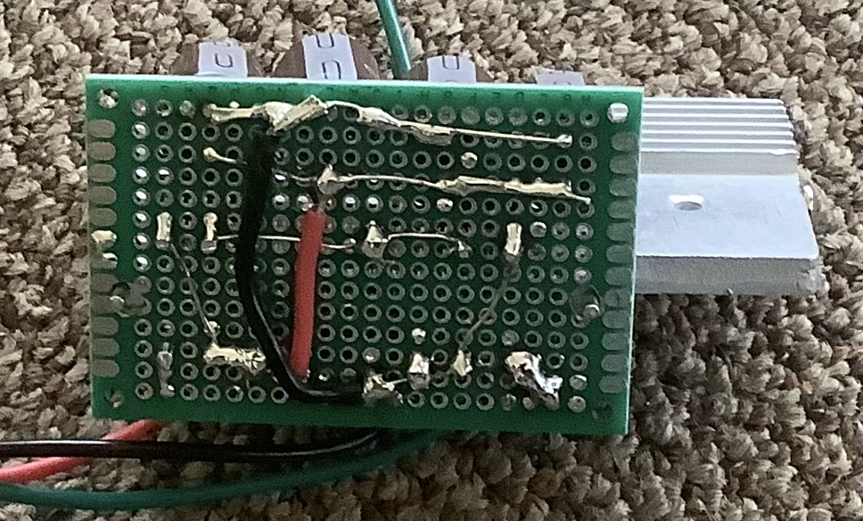

            Here is some pictures of the new auxiliary power supply board
            Well I did some more testing and found out for some reason you are limited to about 2 amps ( because the more you loaded it the more the voltage output goes down and the amperage does not go higher than about 2 amps) when you do this type of modification which for what I going to use it for will work prefect for because there are times that I need higher voltage but current limiting ( for testing LEDs modules )
            This winding setup is at 40 volts no load and load it about 30.something volts
            But the more you try to load the auxiliary board it changes the 5 and 3 volt rails either the 5 volt rail goes little high and 3 volt rail goes a little bit low or it is the opposite way 3 goes high an the 5 volts go low according to the ATX testing meter module which is very interesting to me about these results

                • Jul 2011
                • 6069
                Re: Please comment on this modifying a ATX switching power supply is this a good idea
                Update
                Yes you can do this modification to a ATX switching
                ( depending on the switching transformer setup this will not work on everyone of them )
                power supply as described in the website link that I posted earlier using the incandescent light bulb instead of the fuse was limiting the output auxiliary power supply board and not giving the full amperage
                The over current protection circuit still works correctly I shorted the auxiliary power supply output leads together and it turned off and when I remove line power supply it restarted again
                As you can see the amperage meter shows 4 amps current draw from the AC input on the ATX switching power supply
                The voltage with no load is 75 volts on the auxiliary power supply board
                3 amps @ 50 volts on the auxiliary power supply board and about 1.5 amp on the 5 volt and 12 volt rail
                You do have to put a small circuit load on ATX switching power supply board for it to work correctly and stabilize protection circuit to work correctly
                Now I am doing a burn in test on this modification to this ATX switching power supply to see if any issues develop I still using the electronic fuse testing box that I built a very long time ago
                The original picture was over 4.75 megabytes so I split the picture in half so you see how I am testing this switching power supply board with the modification made to it
                So far it has run for an hour already and still working
                I just realize that two pictures that I posted earlier were the exact same picture of the auxiliary power supply board I just posted the other side of the board
                ******Disclaimer notice******
                I would highly recommend that if want to experiment with doing this type of modification that you frist make sure that your ATX switching power supply work correctly first before you start
                I would highly recommend that you remove the fuse from the switching power supply board and use a incandescent light bulb instead of the fuse
                I would highly recommend that you build a bridge Schottky diode rectifier assembly with a heat sink and use 100 volt capacitors
                And above all please be careful and use caution while measuring voltages and current on these boards
                How I going to use this setup is to use the regulator ATX power supply rails and or use the auxiliary power supply board by itself or a combination of the two
