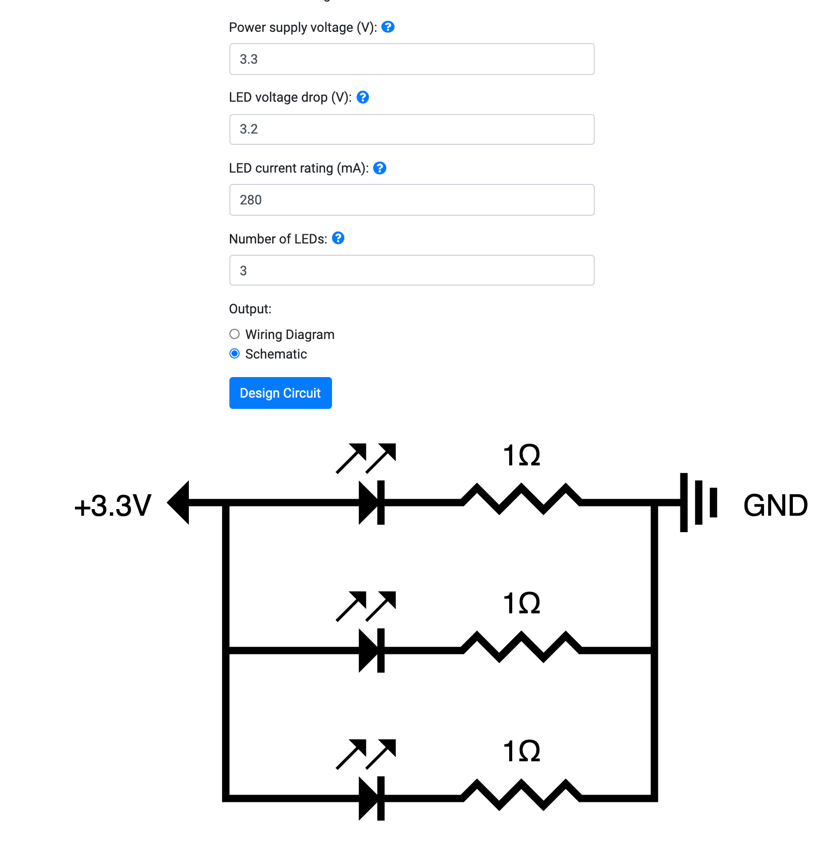

        This is a screenshot from a website where I put in the parameters and this is what it kicked out. I was presuming that I would build the circuit like this ... I just need to drive it...

          But where's the transistorized portion, that's a huge part of the circuit missing!
          Do also keep in mind that BJTs have a saturation voltage that may drop the voltage below 3.2 volts, and you may need to use MOSFETs with op amps, possibly with charge pumps, to get the gate drive high enough to fully turn on.

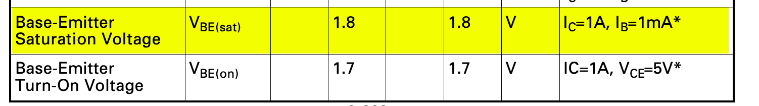

              ... so ... looking at the datasheet for that transistor ... am I reading this right? Would this not fully saturate long before it hits 3.3 Volts?

                    Take for instance, this schematic, and the transistor is the ztx602...
                    Based on what I see in the datasheet, once the pin at the base of the transistor hits 1.7 volts, those LEDs will be on as bright as they ever could be in this circuit, meaning that my options for "medium" and "low" light intensity will have to be achieved by telling the attiny pin to drive the transistor at two different voltage levels below 1.7. Correct? Which gives me a lot less headroom for resolution, which is fine, as long as the transistor will do what I'm needing it to do. But I don't know how to drive a transistor with current because to me, current happens when you apply voltage to a circuit but it's not an option, in this case, to say "Im going to drive this transistor with x number of milliamps" because in an Arduino, I can only adjust voltage levels on pins.

                        That circuit takes the small current available from the micro-controller pin, and amplifies it with the transistor to drive the LEDs.
                        This will turn them on full.
                        But PWM turns them on and off quickly, and varies the duration for which they are on vs off. By doing so it can control the brightness as we perceive it with our eyes due to persistence of vision. So there is no need to control the current linearly.
                        With a more advanced micro-controller, you can output an analog signal using the onboard DAC, then amplify that with a transistor to control the LEDs but then you will need a transistor with a heatsink so it does not overheat. PWM is more efficient as the transistor is either on or off.
                        The only other option is to have multiple transistors switching in different resistor values for your different brightness levels but this increases the cost and complexity greatly.

                          You are doing Emitter follower (Common Collector), so the Base Voltage with ref to ground will way higher than 1.7V Vbe junction. if you look at your circuit you will have Vbe, Vled, Vrs. The output Voltage on the Emitter will be = Vbase drive - Vbe.
                          You should have the Transistor or the MOSFET on the low side of the circuit and then PWM the MOSFET to control the current through the LED and you also need the current monitor feedback to maintain constant current through the LEDs.
                          Your circuit is the Voltage source not current source, so if you have fixed Voltage feeding the LED, but since LED Vf will vary with temperature so the current through the LED will change which will cause the LED brightness to change, that is why you need to use constant current source to drive the LED so if the LED Vf varies the circuit will try to maintain constant current through the LED thus maintaining the steady brightness.

                            Correct, need a common emitter or common source for mosfets. So that means low side, or use a p channel/pnp transistor. OP can use n channel/npn on the high side if they make a driver for them, which may complicate the circuit considerably.
