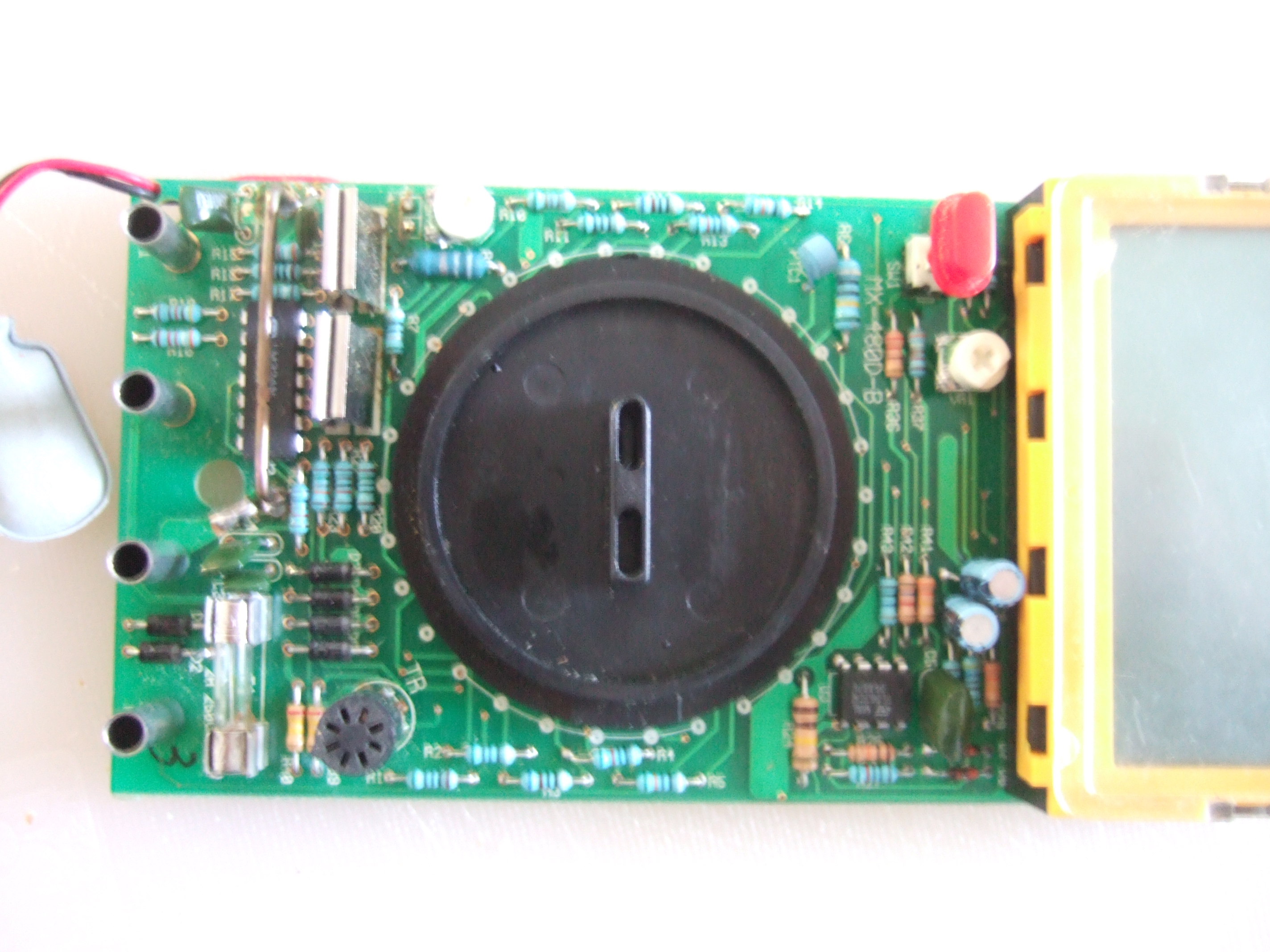

    Unforunately I damaged one of my DVM,s when working on some power supplies
    measuring some high voltages ,because there was some rf on the dc I was measuring.
    It still works but is noisey and it will not measure diodes, I would like to fix it if possible.

    There's lots of DVM schematics out there, if you have a make/model or pictures of the board it can help figure out the DVM chip used and what parts might be damaged.
    Usually a low cost DVM overloaded (by voltage) will damage its input protection clamp diodes, so you always get a low reading on ohms or diode test, when no leads are connected. Just speaking generally.

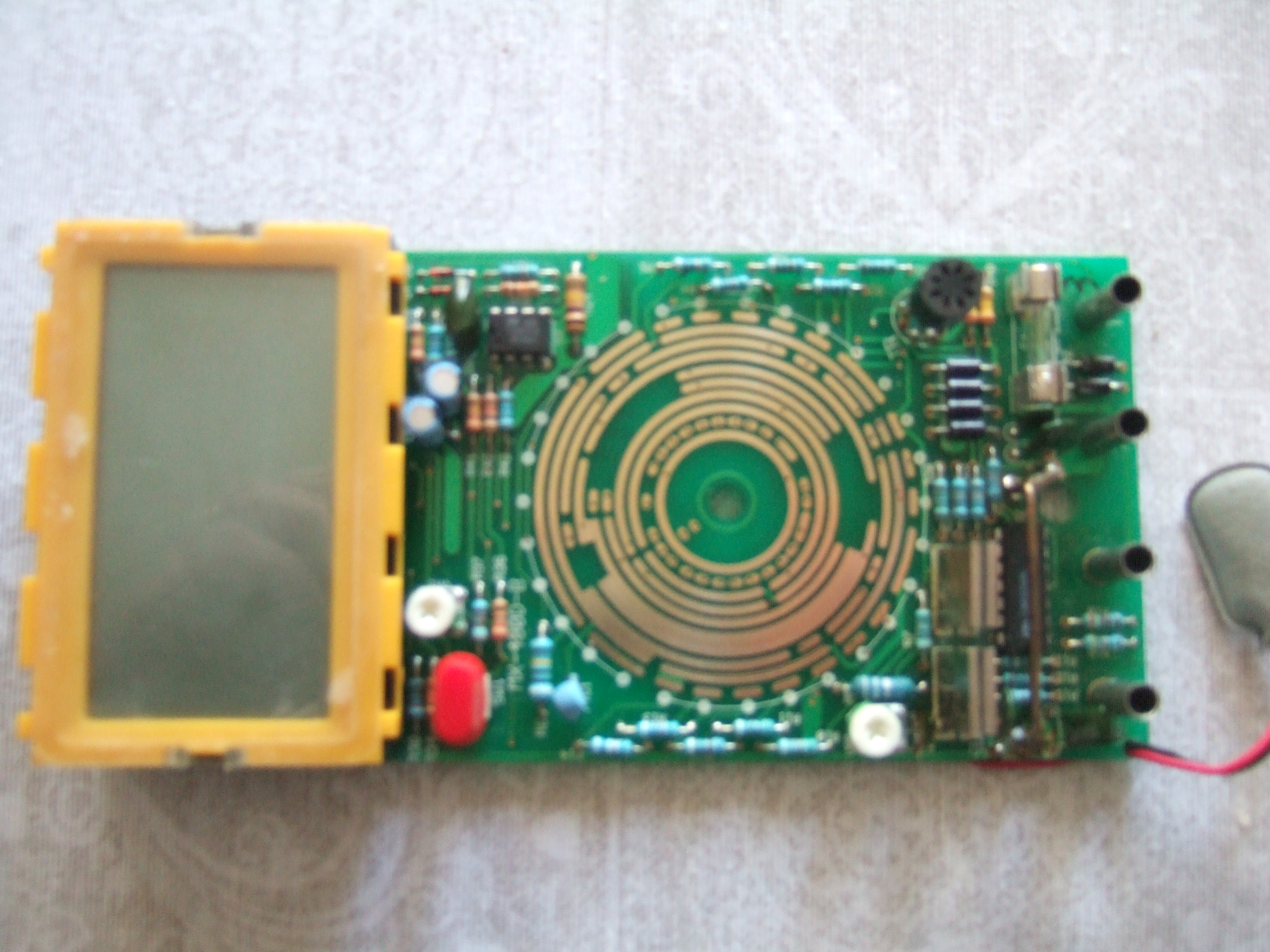

      Hi attached some pictures cant see any makers name on it .Fixed the noise problem by cleaning the switch ,just seems a problem trying to measures diodes ,very low voltage applied to the device .
      There are two op amps ,dual and a quad .
      Could it be a problem with the LM324 ?

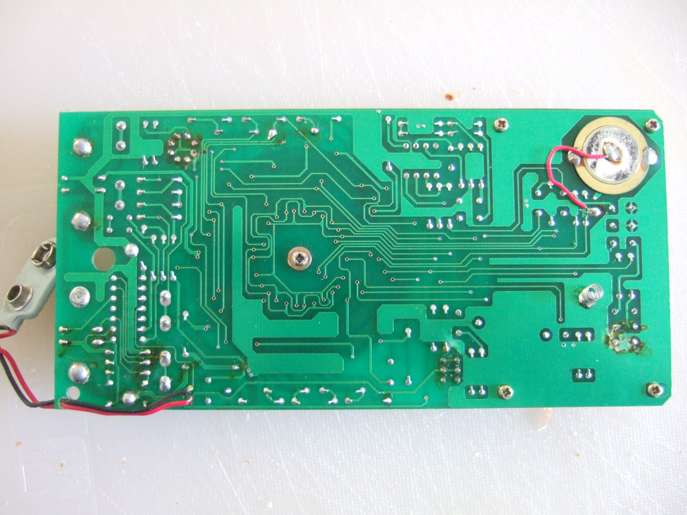

          The PC board is "MX-480D-B" but no hits.
          I don't see the usual two-transistor clamp or a PTC thermistor. Low cost DMM's sometimes have missing protection circuits and they easily die.
          I would (using another multimeter) test the six black diodes. Otherwise, all that remain are the LM324 and the big IC.

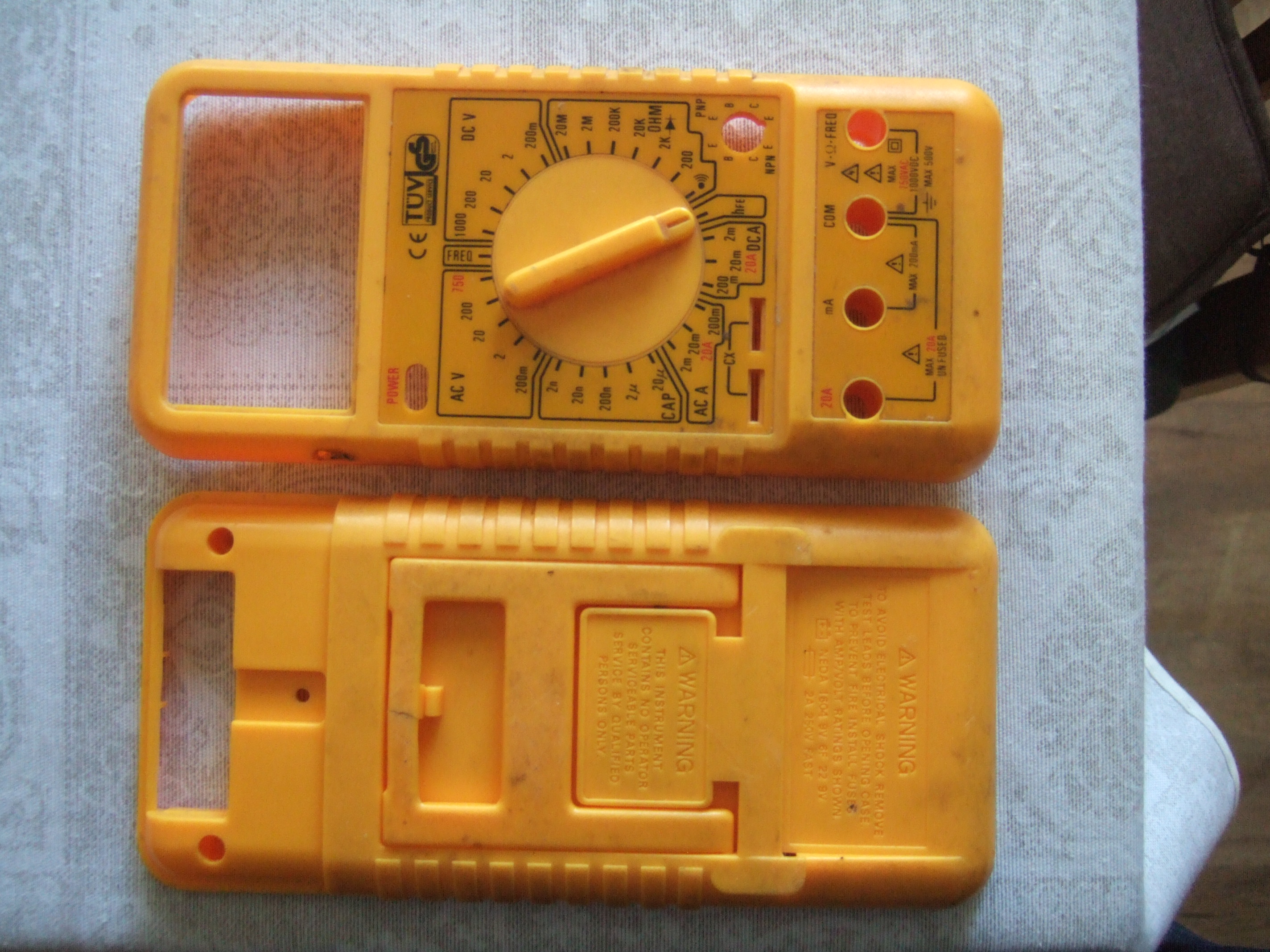

            It is likely a Maxcom MX480 multimeter, or copy. There is a blue PTC1 located close to the board number

              Looks like a dt890 to me, there are a few versions A B C D E F.

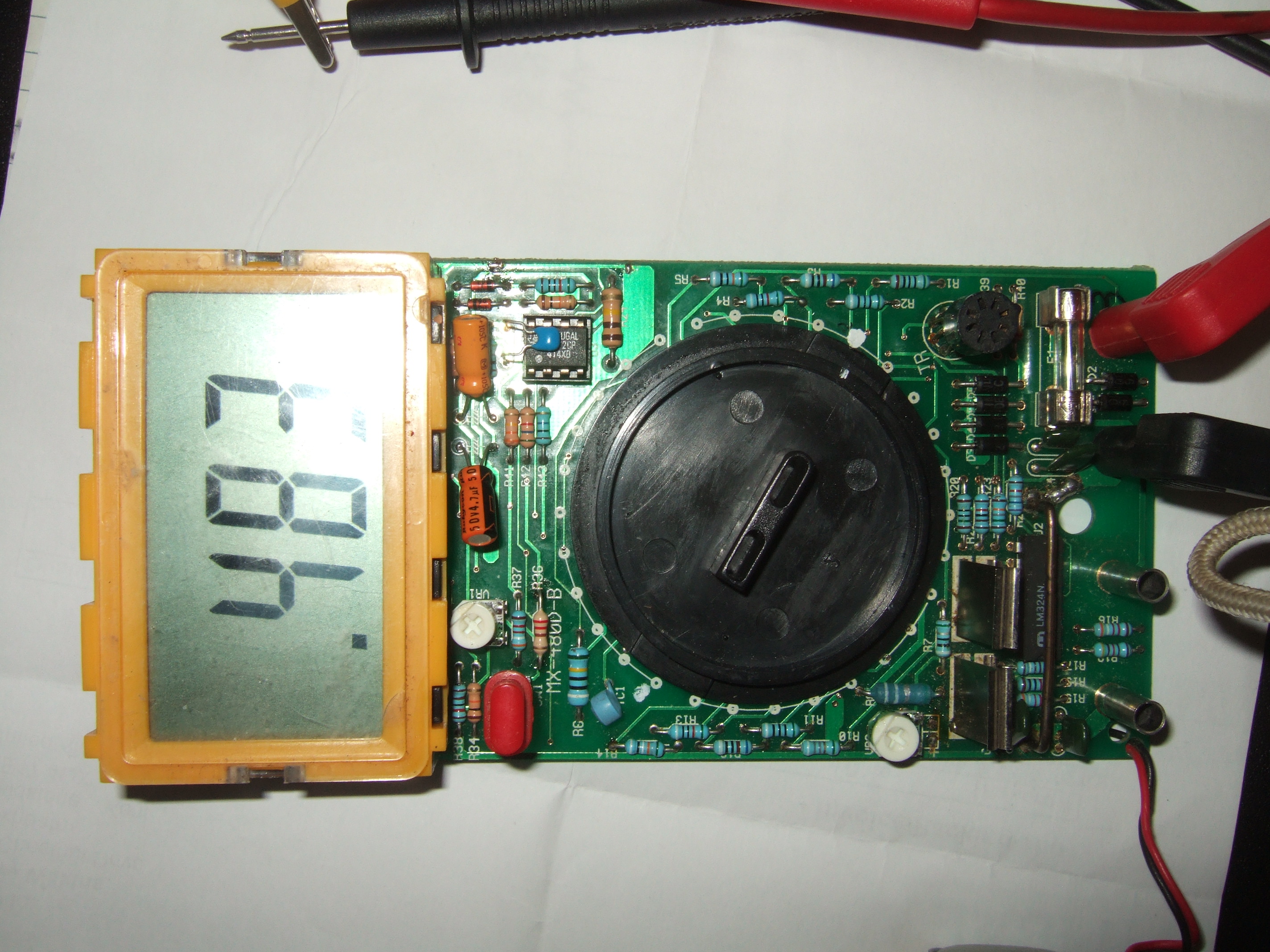

                  I could see there was something wrong around the TL 062 opamp ,so I removed it and replaced it with an 072 ,replaced the diodes and capcitors at the same time. A bit more investigation found R 36 was O/C.
                  Barry
