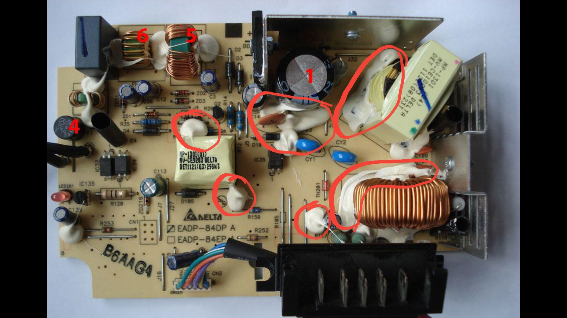

How is called that compound that glues components on the PCB?
    If someone can post a link, I will appreciate that.

        Re: How is called that compound that glues components on the PCB?
        No guys, not solder. The white stuff that looks like silicone/ETC or it is silicone?
        I am not sure that it is a regular silicone, I know that it's not supposed to be conductive.
          I attached a photo.
            thermal adhesive
              That is just silicone
                not exactly, it's NEUTRAL-CURE silicone.
                cheap crap has acid in it that eats the plating off wires & stuff.
                  No, I don't need a thermal adhesive, I need some kind of silicone to glue a capacitor that I have replaced.
                    dont use any silicone that smells like vinegar. i use black rtv, since it is easy to get for me.
                          It's not just cheap silicone that uses acid. Most use acid. In my local hardware stores, EVERY silicone uses acid even the most expensive brands.
                          Some even say things like "Organic Acid" or "Low Odor" but those are still not suitable for electronics!! They are all designed for building, roofing, bathrooms etc.
                          It must be Neutral-cure designed for electronics, indeed.
