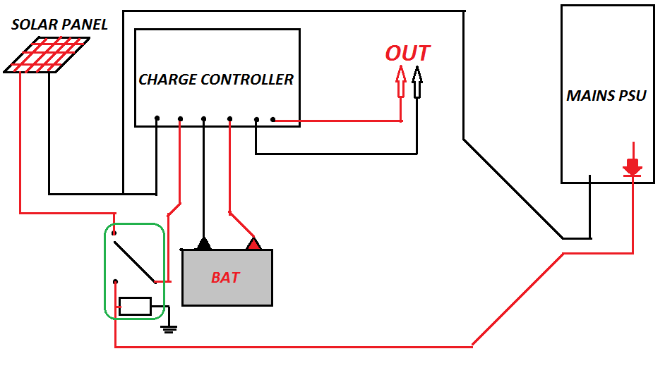

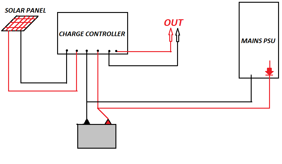

                                #175
                                Re: Remote pump control ideas.
                                Back on this project, it just dawned on me that I can leave the solar system in place as it is as well, since it doesn't hurt to have an additional backup system in there....not sure where I should drop my mains power supply though.
                                I was thinking of wiring its output in parallel to the existing battery directly (first doodle), though I'm not sure the solar charge controller likes the voltage from the AC supply feeding back into its battery output. One of the power supplies I linked to apparently has a diode for the "battery" output already built into it, which is why I added one in red inside my "power supply" there. I'd set the output voltage of the supply slightly higher, to around 15v, and this would eliminate the need for a 12v regulator, since I'd be using the charge controller itself as a DC-DC converter.
                                There will obviously be a time of the day when BOTH the supplies would be "on" and try to pump current into my battery there....not sure if that's a good or a bad thing and whether I should use a small-ish value resistor in series with one of them to prevent killing the battery in some way.
                                Other examples even show the mains supply being fed into the solar cell input of the charge controller and toggling between which is being used via a relay (second doodle). The upshot of this is that the charge controller now also handles the charging of the battery when "on mains" too. The downside is that DC arcing may be an issue + the beefy wires coming from the solar cell in this particular case would be a nightmare to shove into a relay socket
                                Wattevah...
