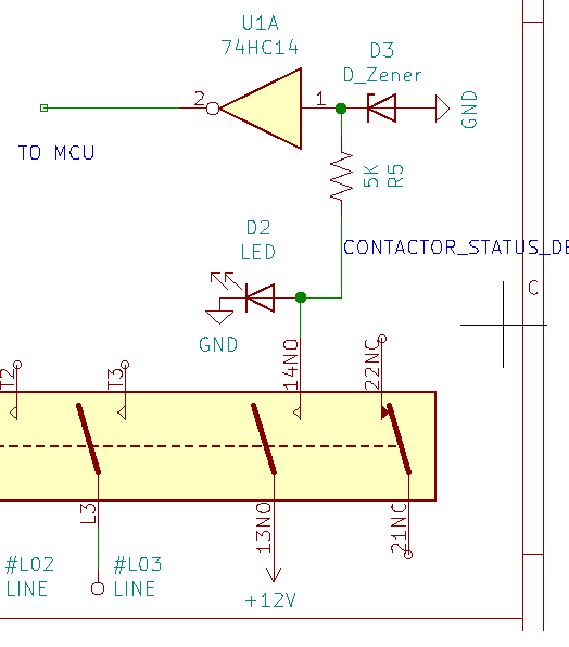

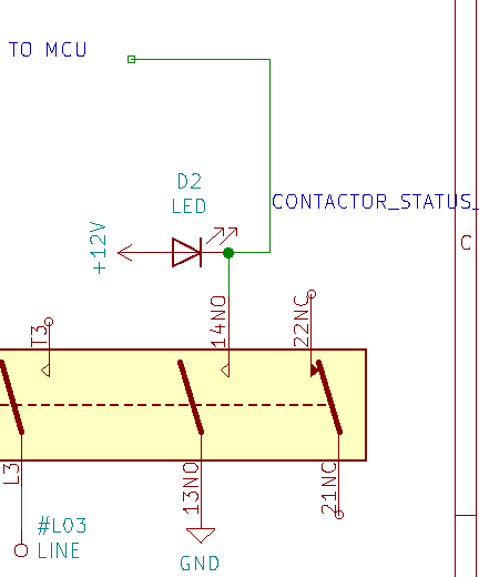

                    #129
                    Re: Remote pump control ideas.
                    Back to something slightly more hardware-related: it's a snippet of this project's schematic and I'm trying to "read" the status of the main contactor through one of its AUX contacts to signal it to the MCU, but I also want to turn on a 12v LED lamp with it. Would something like this work ? I used a schmitt-trigger there just because
                    Sticklers will probably point out immediately that I have a free set of contacts to the far right which I could use, but this is ASSUMING I only have the one N.O contact to work with and I need to both signal the MCU if the contactor is on/off AND turn on the green lamp. I'm not sure what happens when the switch opens...would the input of the schmitt trigger "float" and go ape$hit ?
                    Another idea was to use the base of a transistor there to drive the lamp (and use 5v on the AUX switch, instead of 12) but again: I'm not sure it would be "stable"...
                    Wattevah...
                      • 31247
                      #130
                      wtf?
                      use the relay to pull to ground,
                      out the led & resistor(2k2) to +12v or use 5v and 470ohm or higher
                      the microcontroller has internal pullups
                      btw - your circuit will blow the led to bits - literally!

                        #131
                        No, it would not, because it's not actually a single plain LED. It's THIS...which also explains why I paid no mind to resistors for the LED - it's a standalone lamp you run on 12v. It does the stuff you mention inside of it.
                        I WAS thinking of going straight to the MCU/schmitt pin like this, but this sends 12v into the pin when the diode becomes forward-biased (switch open) if I see it right (even with a resistor inside the lamp). It MIGHT work if running on 5v, since it would simply "pull up" the pin of the MCU/schmitt which wouldn't care...
                        Wattevah...

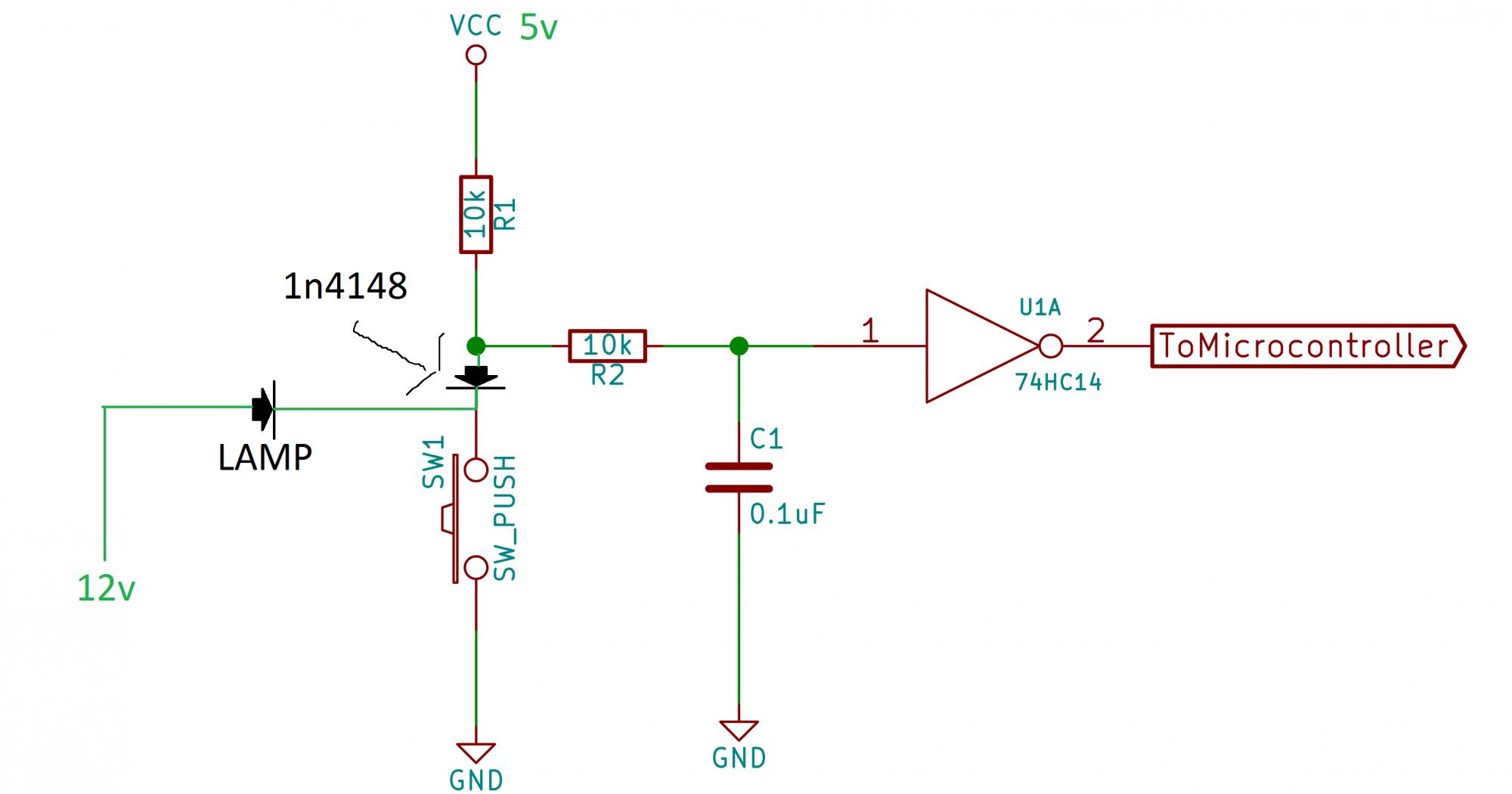

                          • 31247
                          #132
                          i think if you put a 1n4148 diode between the mcu and relay you should be good.
                          it will block the 12v through the lamp from the mcu
                          if that even happens.
                          i have some led indicators that dont have polarity, i think they have a rectifier or multiple leds in them.
                          • Dannyx
                            CertifiedAxhole
                            • Aug 2016
                            • 3912
                            • Romania
                            #133
                            These lamps are not polarized either, so there's a rectifier in them, or two diodes. Still...
                            I thought of a simple diode but couldn't figure out where to put it. Assuming we're still switching to GND through the contact like in the schematic, should I put it with the cathode facing the contact and the anode at the the MCU pin (or input pin of schmitt trigger IC in my case) ?
                            Wattevah...
                              • 31247
                              #134
                              yes, anode to mcu input you can also use a series resistor to limit the current to the limit of the pin if you want.

                                #135
                                I based my setup on THIS, so the schematic looks like so, adapted from the one the chap gave in the post (gotta love that artwork I did in MSPaint because my POS laptop at work won't run KiKad due to openGL or some $h!t ), so the resistor you mention is already in place I think (R2 in this case).
                                It seems to work fine this way: when "resting", the lamp if off and the output of the schmitt trigger is LOW, due to the pull-up resistor. You push the button, lamp comes on and output goes high (inverting action).
                                I seemed to notice a very short spike in excess of 20v when measuring the the output of the schmitt trigger when I push the button. It quickly stabilizes to 5v as expected and no smoke came out. It could be a fluke of my meter due to noise or something, since I moved the connections around a bit and the spikes seemed to go away too. I haven't killed anything yet, but I'm not sure I should overlook this issue and regard it as "solved"....
