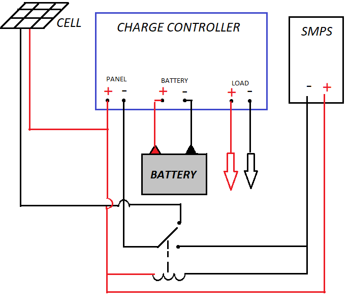

                      • 31248
                      #190
                      Re: Remote pump control ideas.
                      solar charge controllers are usually pulsed dc and they regulate current rather than voltage.
                      you should make a small board with a bridge rectifier and some smoothing caps - electrolytics for bulk and film/ceramic for speed.
                      put it between your power and the nucleo and any other electronics your running.
                      use a bridge instead of a single blocking diode because it gives you full blocking together with protection from some dick in the future putting a replacement battery in the wrong way!!
                      and dont power from the solar - those panels can go well over 30v on low load.

                        Good idea. I DID plop a single diode in series with the supply to the board + a single electrolytic, but I guess I should be increasing that capacity, add ceramics too and switch over to a FULL BRIDGE RECTIFIER ! Not sure what the values of the caps should be though...

                          probably 470uf is enough - your relay coil will draw far more than the nucleo!!

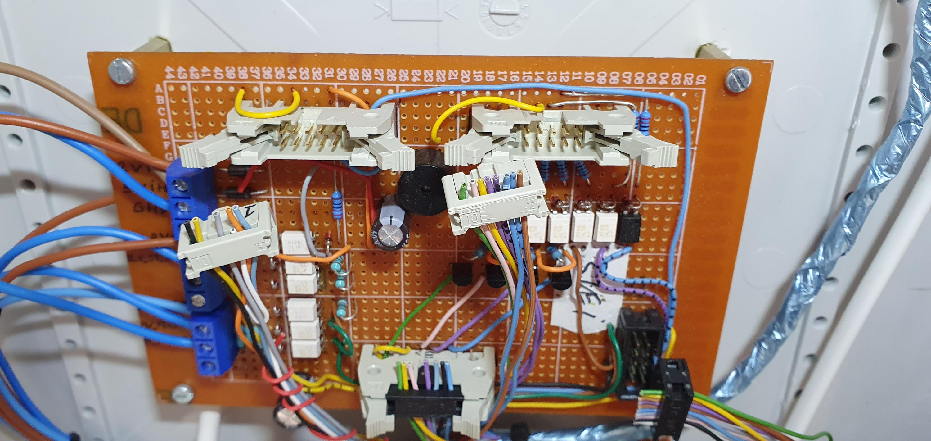

                              I can now definitely confirm there's a power issue messing us up. There's some situations in which the client board locks up and no longer loops and these can be replicated each time, so they're too much to be coincidences
                              Case no.1: both boards are connected via USB to the same computer host. In this case, the client connects to the server, but they only manage to exchange 1-2 messages before the entire thing breaks down and the client freezes...
                              Case no.2: that thing I described where the server is unplugged from mains together with the USB power adapter that powers it - not just from its USB connector. Plug it back in and, annoyingly enough, it's the CLIENT loop that freezes ! I say "annoyingly" because the client isn't even powered off to begin with - instead, it just telepathically knows the entire brick got unplugged....HOW ??? EMI most likely, though I WILL try moving the boards farther apart. However, try the same exact thing, but by unplugging just the USB cord from either the charger or the board end and leave the brick plugged in and the code resumes just fine (and also keeps looping if there's a connection error, as it should)...WTF ?
                              From a factual standpoint, I installed the "client" board in its own enclosure, what I consider to be a pretty good distance from the three phase contactor at the actual site where the pump is, so I'm hoping this doesn't turn out to be a problem there, though as far as I remember, I could still hear the buzzer buzzing away when the connection was "dead", so the loop was not stuck - there was still a code bug at that stage...If we get that out of the way, we should be good. My programmer buddy made some mods to the code here and there and it starts to look a whole lot nicer now. He stress-tested it all day while I was away, but when I came back I wanted to do the all-important power-cut test and did it by unplugging the wall-wart, letting the client board go into its comErr condition and lo and behold, nothing else happened when I plugged the server back in - the loop had frozen and we had a "uuughhh....f*ck" moments :|
                              Wattevah...

                                          #200
                                          I think you have to chisel away and deal with each EMI source/problem one by one.
                                          The contactor's coil does have a huge back EMF which would make the little relay contacts arc.
                                          The relay's contacts are high voltage and dirty (EMI) - and that wiring must be kept as far away from all the low voltage wiring.
                                          The arc at the contacts can radiate EMI and capacitively-couple it to the coil's 12V connection. This path gets it into your 12V system.
                                          What is usually done is either a MOV (i.e. 275VAC) across the contactor's coil (limits back EMF) OR an RC snubber across the little relay's contacts like 0.1uF X2 275VAC and say 33R 1/2W.
                                          Suppressing arcing at the motor contactor is expensive and hard to do. It's a big motor and nasty high voltages there. Not really feasible. Best is to keep the MCU away from it, or in a metal box.
                                          The opto-board looks OK. How is the earth-grounding to the 12V side done? Or is it floating? You can add a 0.1uF cap from 12VDC(-) to earth ground and that usually helps, if the EMI is present there.
