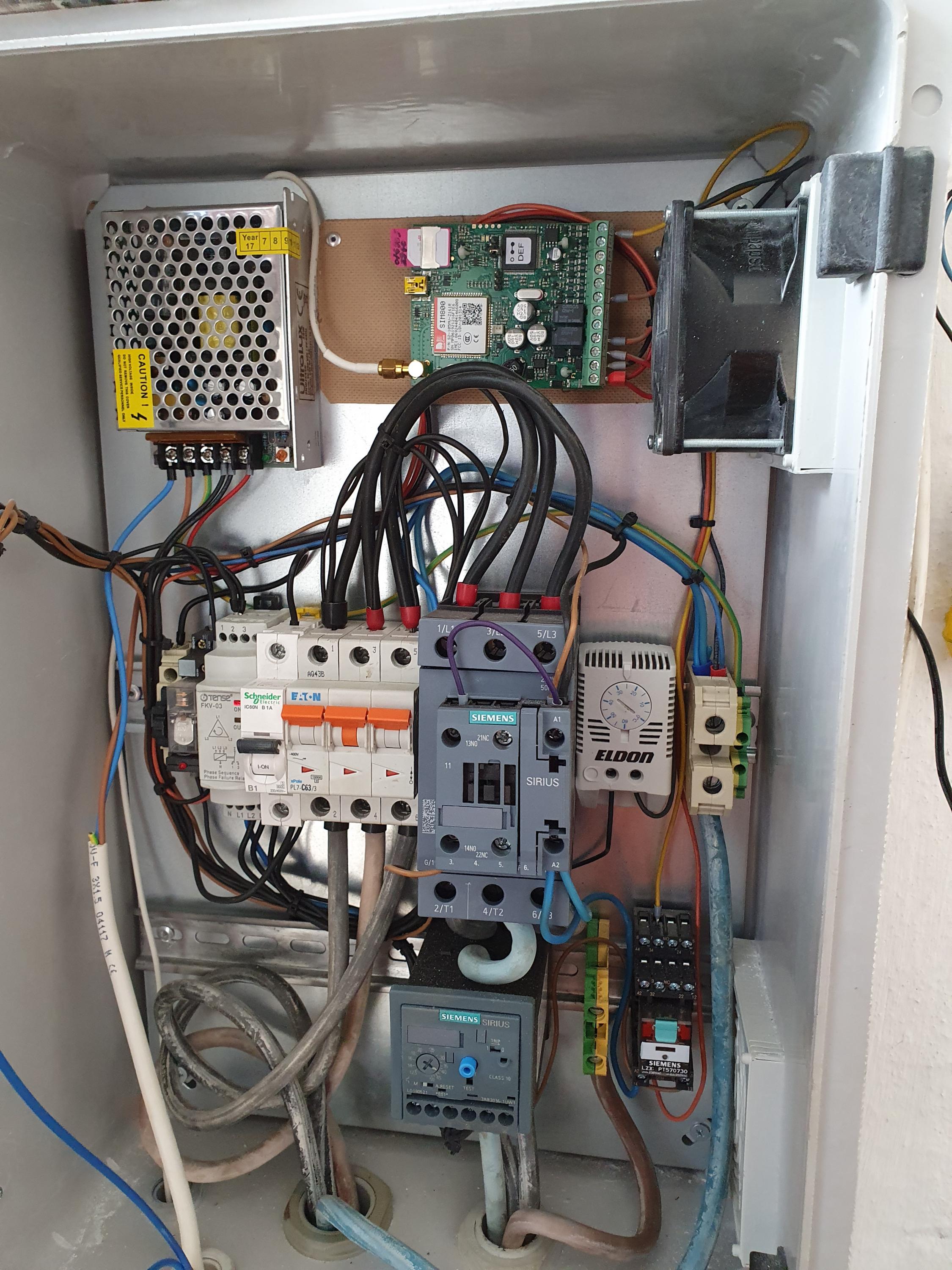

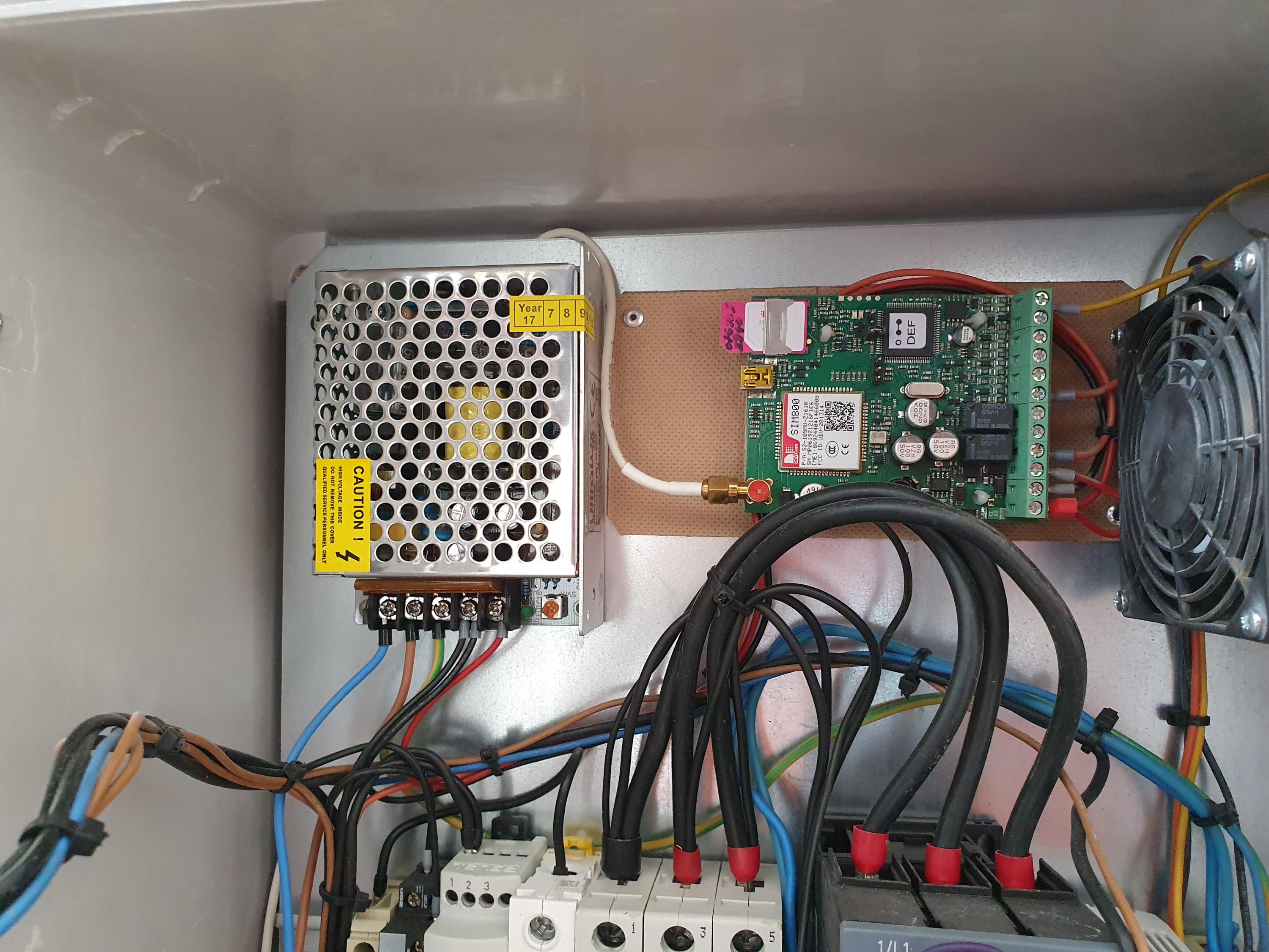

              Re: Remote pump control ideas.
              Originally posted by Dannyx
              Not necessary in this case, but could be added later on....I also managed to score the user manual for the GSM boards currently in there thanks to this chap who installed them. It's HERE if you wanna take a look.
              Page 8, Antenna Installation.
              Never install in the following locations: inside the metal cabinet. Closer than 20cm from the power lines.
                  Not sure where the antenna is located exactly, but I was thinking of leaving this system in place as well as a sort-of backup in case something goes wrong with my super high tech setup
                  You can see it in the photo, in the metal box draped around the power wires.
                  There are only two "Never install in the following locations" in the instructions and both have been ignored.

                    #29
                    Yes, but that's the wire for the antenna - we're not sure if the antenna itself is actually inside the box....

                      • 31247
                      #30
                      but it's not double-screened, so your inducing AC noise onto your groundplane!

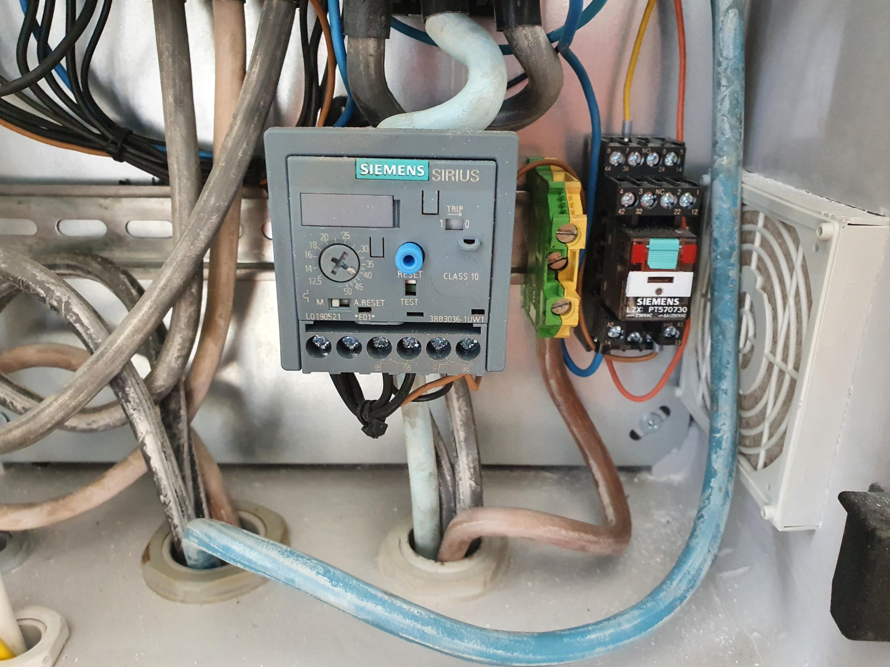

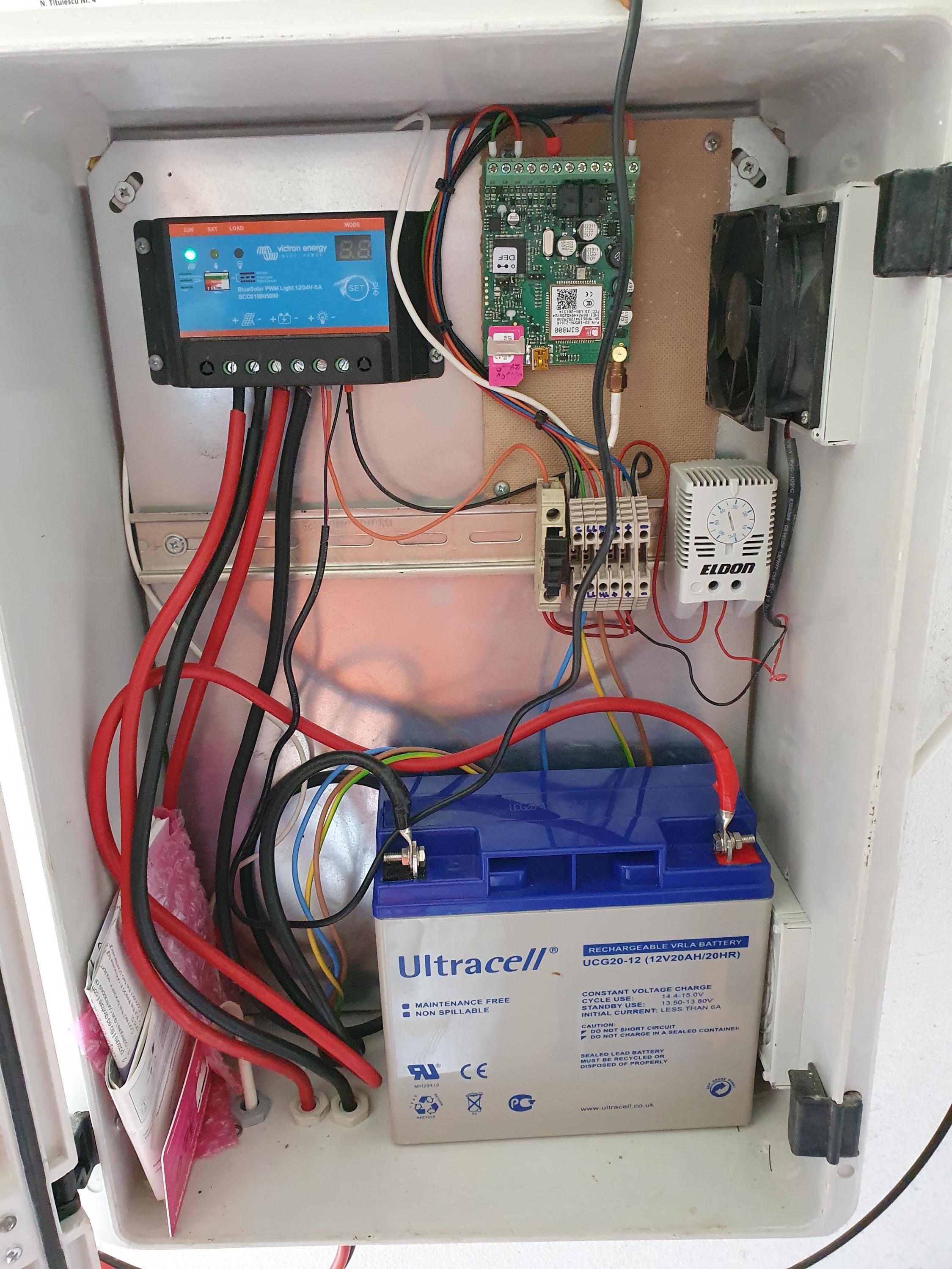

                                          #40
                                          I finally went to see this pump control system in person and take some pics of my own. It's about what I expected. The tank is located up on a high hill and its control box is solar-powered by that blue charge controller and battery. The battery appeared to be flat, according to the flashing red LED on the controller, despite the green LED indicating the status of the photovoltaic panel indicating adequate performance. It could be because it's been rather cloudy lately or because the battery itself is long in the tooth, or the controller's faulty somehow - I haven't touched anything at this point.
                                          Down in the foothills where the pump shack is, there obviously IS constant 3 phase 400v utility power running our box, which is also much more involved: there's the main contactor, an overload switch, a phase monitoring relay and a handful of different goodies for me to play with.
                                          I'm not sure how to best handle the case where the two ends lose communication. The local official who accompanied me on my visit told me it'd probably be best to just shut off the pump and send an SMS alert to someone, which the system actually does already through its GSM modules, though I'll need to modify this a bit so it's the Arduino who sends out the command to the GSM module when it can no longer ping its buddy up on the hill...
                                          Other than that, I'm not sure whether I should have a "manual" mode as well, which would allow the pump to be turned on/off locally with some buttons, regardless of the status reported by the MCU up on the hill, as this could lead to someone forgetting it in the ON position and the tank overflowing...
