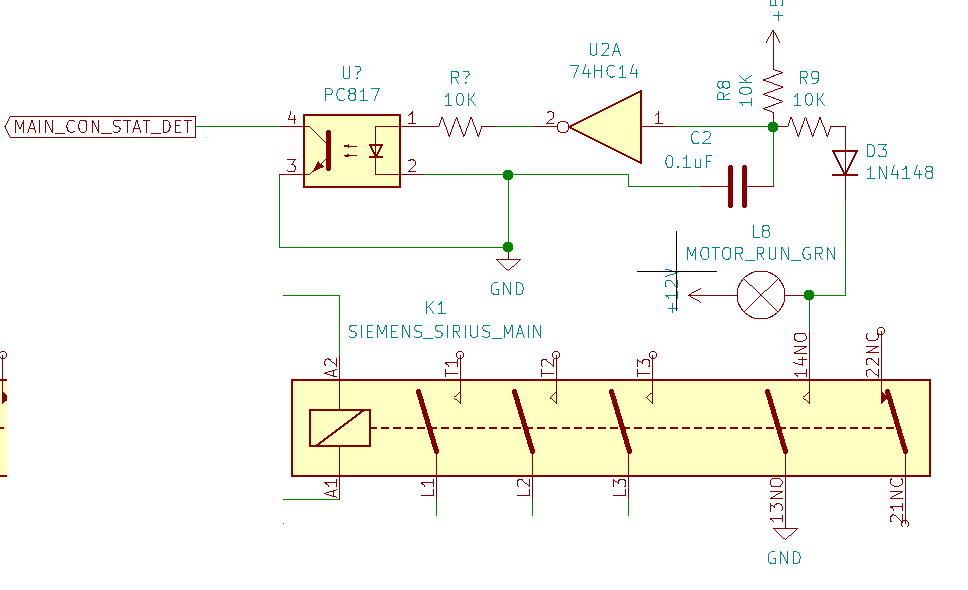

                  #148
                  Re: Remote pump control ideas.
                  Originally posted by stj
                  what the hell is that diagram?
                  why are you using a schmit trigger anyway?
                  i think later i'll have to do a diagram myself!
                  It's a snippet of the KiKad schematic - I cut to only the part of interest which monitors the contact status of the 3 phase contactor. I could upload the whole thing if people really wanted to see it, though it could confuse the heck out of you and it'd have to write a wall of text to explain what's what
                  I heard it's common practice to use a schmitt trigger between mechanical contacts and MCUs...it can't "hurt", now can it ?

                    #149
                    It can hurt because it's another part that can get zapped if not done right. The MCU will have Schmitt trigger inputs as well.
                    The contactor switch is not a nice signal because it's close to mains wiring and an arcing contact. So you need good noise rejection and protection against spikes, and also need many mA of current to flow through it.
                    I would use this (a typical PLC digital input) that makes the DI good (activate) for say anything above ~6V, and the slow opto does filter some noise.
                    It's easier to standardize your digital inputs as say 12V switch to ground. But this would waste current for the tank switches...
                    You don't care about debouncing or a Schmitt trigger because you turn on the contactor and then read the switch a good while later say 1 second, to confirm the motor overload relay has not tripped.

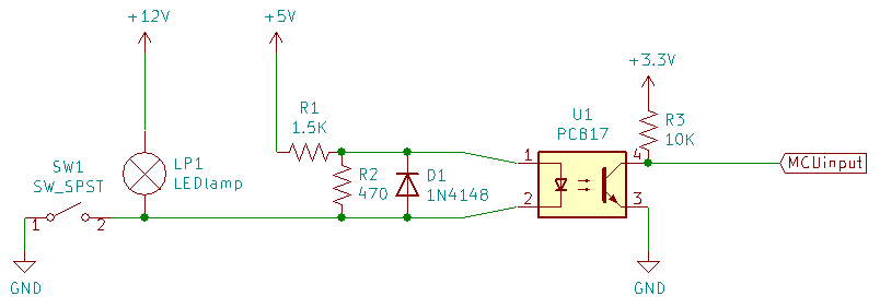

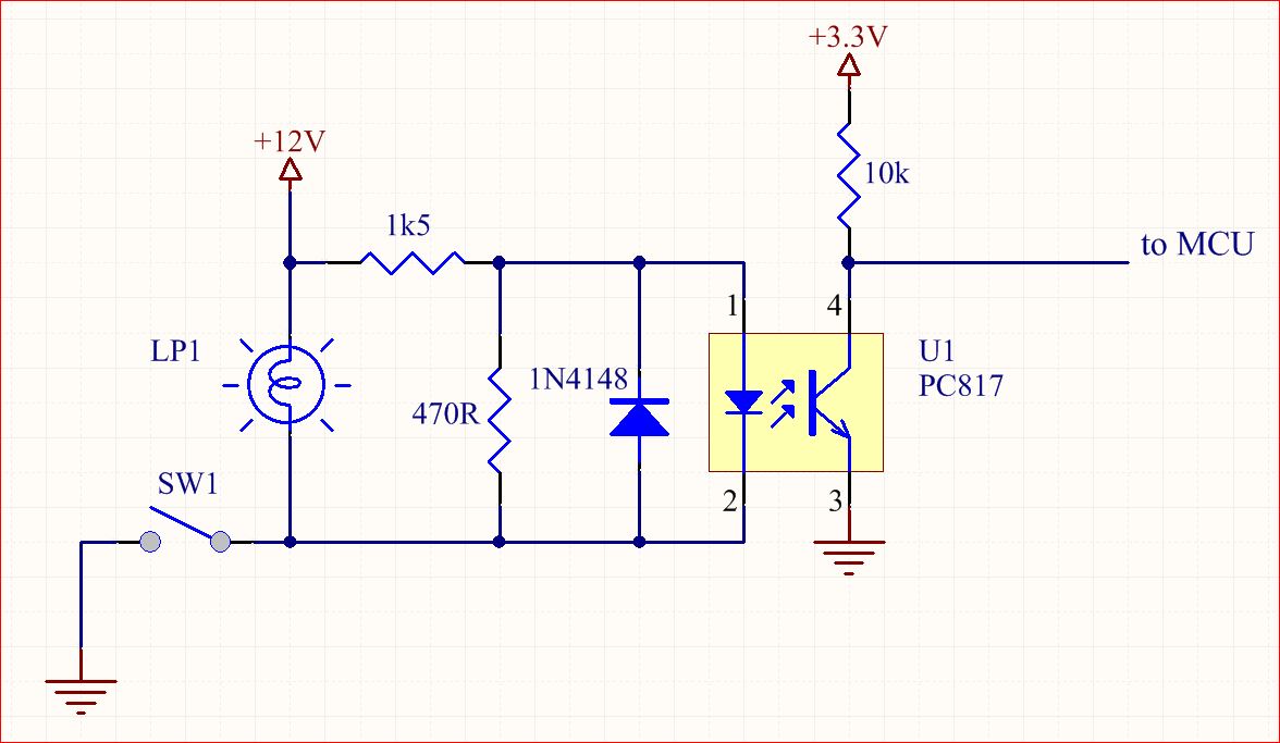

                      Nice. Thanks. I was actually thinking of the same setup at some point. So we should scrap the Schmitt triggers entirely ???
                      Recap: So SW1 is the auxiliary NO contact of the contactor and LP1 is the 12v LED indicator lamp for "motor RUN" ? Ok, got that
                      The 1.5K resistor is for current limit through the LED of U1 - makes sense. I went with 2k last time I had 12v on PC817 in this setup (in my car window project). Now that I think about it, I think I can even go LOWER. The Vf of a PC817 is given as 1.4v max. So 12v-1.4 = 10.6v. Divide that by 1500ohms and we get approximately 8mA of current to the LED....did I get this right ?
                      Can't I use 5/3.3v to drive the LED of U1 so that resistor can be smaller ? I'd only switch the GNDs of both the lamp and the cathode of the LED at once. Let me answer my own question with a schematic: no, because when GND is cut and the LED inside the lamp becomes forward-biased, 12v would flow through it and feed back into the 5v supply via the 1n4148 diode like in the schematic which I drew to illustrate this setup I had in mind...hence why named it "ProbablyBadIdea"
                      The 10k on the far right pulls up the MCU pin when the opto is off - makes sense as well. Pulling up to 3.3v instead of 5v is probably a good idea in the case of the STM
                      The 1n4148 is to clamp reverse voltage - I have this in that other project too. I've seen it as a 5v zener in some examples instead of a regular diode.
                      Now that 470 resistor is the only thing left - what does it do ?
                      The tank side does not have any lamps (energy conservation), so I could go straight to the input of U1 via the switch - either by pulling the anode side UP to 12/5/3.3v or the cathode to GND. It's a SPDT switch, so the COM (pole) goes to GND/V+ and the NO/NC (throws) go to either optocoupler anode/cathode, which each get a pin on the MCU. The resistor would indeed waste some power to keep the LED on, hence why I'd go with lower input voltage. The wire run from the tank switch to the control box is pretty long there, though it is shielded, if it matters at all, since we're talking small control signals, susceptible to noise...

                        #151
                        You want the opto to turn on around 1/2 input voltage for noise immunity, not at say 2V but 6V up. The 470R resistor across the opto LED wastes a few mA, so the 1k5 current is not entirely going through the LED. It just ends up increasing the activation voltage to work better with 12V signals. If you had a 24VDC input that activated at 2V it can get easily fooled and is not what a PLC uses.
                        It's best to have a few mA flow through the switch so humidity/dirt leakage current is not enough to activate anything. But not ideal for battery/solar systems.
                        That circuit - the LED lamp sees ~7V when the switch is open, and 12V when closed, so the old/bright dim thing. 1N4148 only good for 100V spike. Why do you want to run the opto from 5V, you're using three rails already 12V, 5V, 3.3V it's too complicated. I would just make the opto input for 12V. Or add a series diode good for 1kV. Or use a simple voltage divider.
                        If you need a low power-wasting digital input, I use small MOSFETs that have the built-in gate protection diode like 2N7002K or BSS138K, or go directly into an MCU input after protection diode/resistors. Again, set to trip at several volts. Remember 3.3V MCU will think >1.8V is a logic 1 which is very low in an industrial environment.

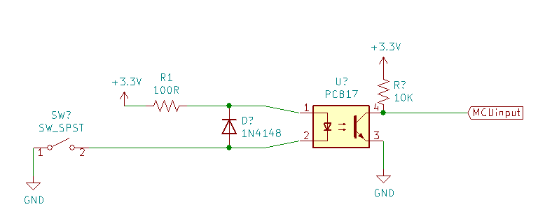

                                          #160
                                          Back to protecting my sh!t: can I also use optocouplers the other way around to protect "output" pins too, like so ? I saw this setup somewhere on the web, I tested it for around half and hour and it seems to work reliably enough, at least on the bench under normal temperature conditions. It's for powering the 12v relay which in turn provides 230v to the main contactor, since that's its rating...I originally had the MCU pin straight on the base of that 2n2222 but I thought the MCU may not like the arcing that goes on in the 12v relay close to the wire which leads back to the 2n2222. Don't worry about not having a flyback diode across the relay in the schematic - I have a 1n4007 there in reality.
