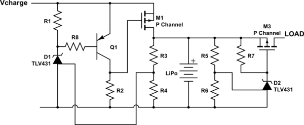

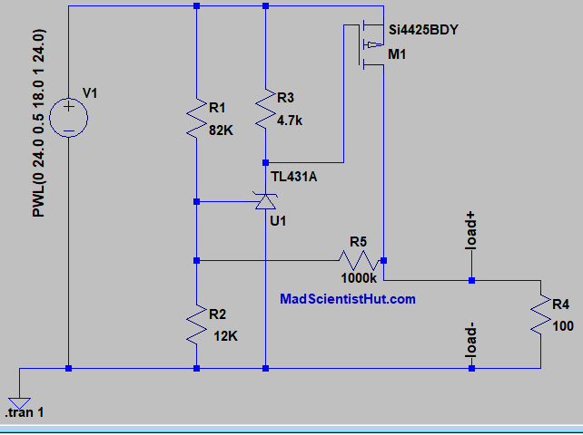

    I am trying to design a circuit based on this circuit:
    I substituted an IRF5305PBF for the Si4425BDY because I wanted a TO-220 package I think I misunderstood the datasheet as I am not sure what voltage turns on the Mosfet.
    I am using this TL431ACLPR
    I then tried to find a calculator to determine the resistor values for R1 and R2. The resistor values I tried did not work the way I expected.
    The source for the original circuit describes it turning off the mosfet at 18.2v and back on at about 19. No matter what combination of resistors I tried (based on the calculators I found) did that.
    How would I make the circuit work using the mosfet and TL431 I have?
    If not possible with the mosfet what one do I need?
    This device would run off of a 5 cell 18650 battery in series.

        I see that circuit all over the web, it's another blogger special.
        The TL431 always draws some current, it needs to power itself. Usually 0.4-1mA minimum, unless you go to low current TLV431.
        So there will always be a voltage drop across R3 4.7k resistor which may be enough to turn on the mosfet a little. You need to add an extra transistor, or changing to N-ch mosfet switching the GND side.
        Note the mosfet max VGS is 20VDC so a protective zener and resistor are needed to protect it.

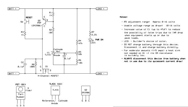

        This kind of circuit always incorporates a latch, so it does not chatter on and off because disconnecting load always lets battery voltage go back up, LVD turns off and connects load, voltage sags, LVD trips and voltage goes back up... it oscillates which is not good for some loads to have power on/off like that.
        The second circuit with latch taken from http://ka7oei.blogspot.com/2016/08/a...r-12-volt.html

          i cant see how that original schematic could ever work,
          R5 is going to effect your voltage reference, and it will get power from both the load via the load resistance, and the body-diode in the fet
