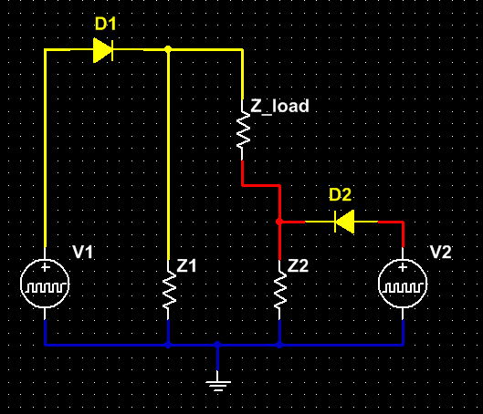

                        #31
                        Re: Power bricks in series?
                        Originally posted by eccerr0r
                        Initially I thought it doesn't apply, but after thinking about it more carefully and considering the schematic of ATX PSUs... again,
                        YES IT DOES APPLY!
                        And here is that diagram of two PSUs connected in inverse-series (continuing with the example of the 12V and 5V adapters), just to help with this:
                        A few important notes about the above diagram:
                        ** It is meant only for steady-state DC analysis.
                        ** C1 and C2 are the filtering capacitors inside the 12V and 5V adapters, respectively. Likewise, D1 and D2 are the internal rectifying diodes.
                        ** V1 and V2 were drawn as ideal voltage sources (which they aren't at all) for model analysis simplicity. These would actually correspond to the transformer output winding(s) of each SMPS. I also set them as 12.7 and 5.7V instead of 12V and 5V, just to (non-ideally) account for the voltage drop from the diodes, D1 and D2.
                        ** The 12V PSU is drawn "taller" on the left side than the 5V PSU on the right side - this was done to help a bit with visual representation of the voltages.
                        ** R_load is the load that can be placed between the two positive outputs to get "7V output".
                        So before R_load is placed in the circuit, C1 is sitting at 12V and C2 is sitting at 5V (assuming 0.7V drop through each diode and a very tiny and small discharge current provided through each cap.)
                        Once R_load is placed as shown above, there will be an instantaneous current flowing through it, because there is a difference in potential between capacitors C1 and C2. Eventually, the current should settle down to zero as cap C2 charges to the voltage of cap C1 (i.e. 12V). This is because on the above diagram, there is no DC path to ground. However, we saw that this is not the case when I performed the test with my 12V and 5V power adapters. The 5V adapter had a non-linear DC current path to ground that quickly started to draw more current as the voltage increased above 5.5V.
                        But that alone couldn't provide the current that I was getting when connecting my fan and light bulbs between the 12V and 5V output, which were much higher than the current I meansured when trying to "force" the 5V adapter output voltage to a higher one.
                        So what gives?
                        Well, that can be answered with an AC analysis diagram.
                        Here is the same circuit above, but drawn for AC analysis:
                        Note the caps for the 12V and 5V adapters were replaced with impedances, Z1 and Z2. (In AC circuits, the impedance of a component is the analogous to resistance in a DC circuit.) For capacitors, Z = 1 / jwC where w = 2Pi x f, in which f is the frequency in the circuit and C is the capacitance. And for resistors Z = R. The voltage sources V1 and V2 were also replaced, now more properly, with pulse voltage supplies, to reflect the output of an SMPS.
                        Comparing the above AC analysis circuit to the DC analysis one, we now see that with R_load (or in this case, Z_load, as the load could be non-linear, which both my fan and incandescent bulb are) there is actually a current path between the 12V adapter's output and the 5V adapter's: part of the current from V1 will go through the impedance Z1 of capacitor C1. But, another part of the AC current can go through Z_load and then through the impedance Z2 of capacitor C2. How much, of course, will depend on the capacitances of the output capacitors, along with the frequencies of the switching in the two adapters and also the impedance/resistance of the load.
                        And that folks, is what I think provided at least some of the "extra" / "mysterious" current that supplied my fan and light bulb without letting the voltage on the 5V adapter raise too much.
                        Unfortunately, I don't have an oscilloscope to measure the AC current or voltage across R_load / Z_load, but I imagine we would actually see a rather noisy voltage, despite both adapters outputting supposedly smooth DC voltage.
                        Now, if a large resistive load (larger than the R_load across the 12V and 5V outputs) is placed across the output of the 5V adapter (i.e. across C2), then much or all of the DC current through R_load could go through that and reduce the noise.
                        So going back to what eccerr0r said: the best way to safely use PSUs in inverse-series is to place a large-enough load across the lower-voltage supply that can "carry" the current from the load placed between the outputs of the two PSUs.
                        To give some numbers to work with for the above example with the 12V and 5V adapters...
                        Let's say you want to to draw up to 1 Amp at 7V (maybe connecting a bunch of fans like I did?) To do that, first you need to make sure both your 12V and 5V power supplies are rated for at least 1 Amps of output. Next, place a 5-Ohm load resistor across the 5V adapter. This will draw 1 Amp from the 5V adapter (i.e. 5 Watts, so your resistor should be rated for at least 5W dissipation) when there is nothing connected on the "7V" combined output of the two adapters. Once you connect whatever device you wanted between the 12V and 5V outputs, that device will draw a current from the 12V supply, and return it through the 5-Ohm resistor back to the 12V supply. The "7V" output will regulate properly as long as the current draw of your device is under 1 Amp (so you can have a fan that only needs 0.15 Amps at 7V, or you could have a bunch of them, but their total combined draw should not exceed 1 Amp.)
                        • eccerr0r
                          Solder Sloth
                          • Nov 2012
                          • 8701
                          #32
                          Actually there's no AC component, the analysis can/must all be done at DC. i(R_load) will be DC, i(C1 or Z1) and i(C2 or Z2) only makes sense from the charging/discharge from the power supply whether it be a SMPS or linear or even battery. In fact the AC component of R_load is meaningless because as shown the steady state will make the lower voltage capacitor charged to the higher one and there will be zero voltage across R_load.
                          As mentioned, the minload resistors that aren't shown are the main contributor to apparently unloaded PSUs working in this fashion. In fact if you draw these resistors, you can apply KCL/KVL and things just "work" (with diode models). Without the resistors, you can't really do any calculations other than the steady state.
