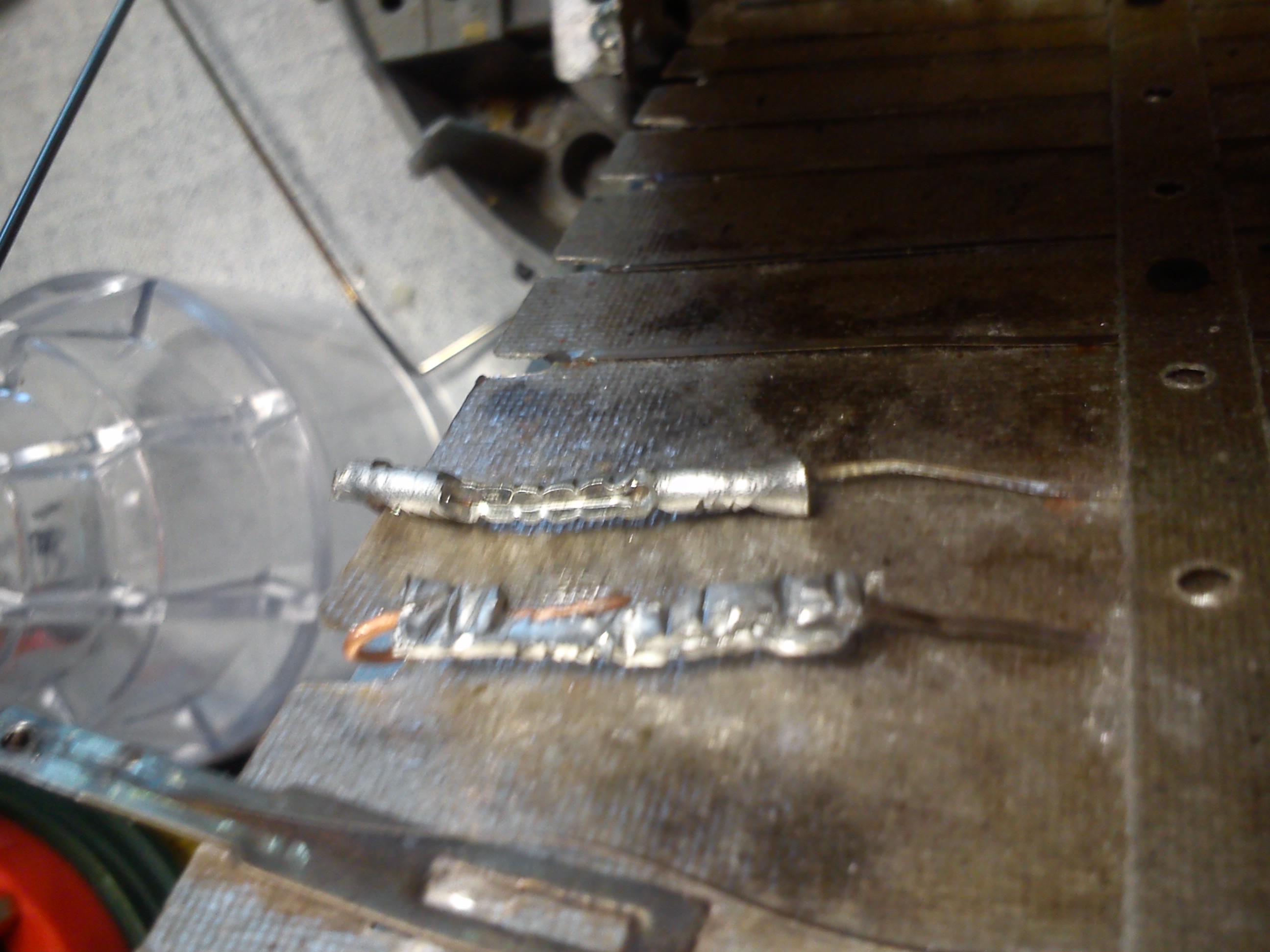

                  Re: Repairing a heater wire in a toaster.
                  Originally posted by R_J
                  I repaired one a long time ago, I made a small ferrell about a quarter to half inch long out of thin tin that fit over the element and used that to crimp the broken element together.
                  Thanks for the suggestion , i will try this one out.
                  I would like to learn how to weld but dont have the machine.
                  I have some scrap metal laying around and will definitely try this...Never repaired a heater before so this will be the first one. thanks again. I dont have a crimping tool either so im just gonna try to do it with pliers.. Will upload some pics for you guys to tell me what you think.

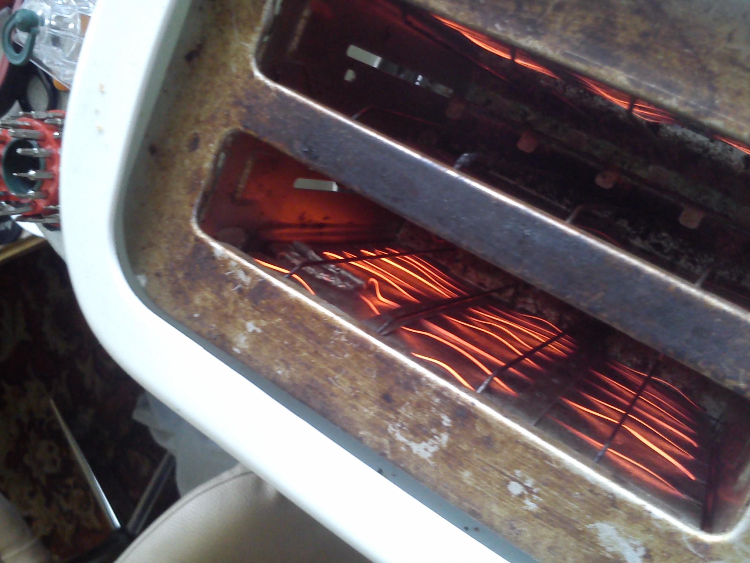

                      so here it is my crimp job... seems to be doing good .. i tested it 3 times at full settings and no problem ... the large aluminium piece seems to dissipate heat at that weak point... so i think this toaster will be good untill the heater fails somewhere else. Thanks again for the suggestion R_J great call
