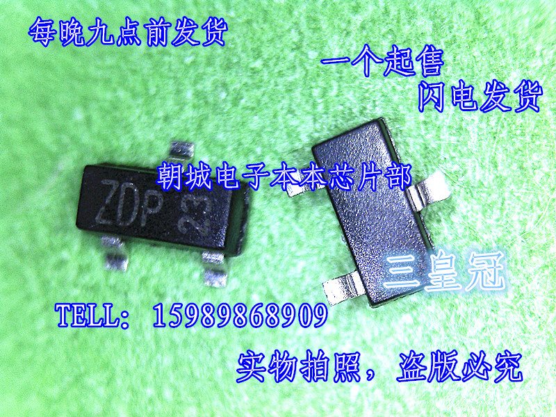

      Searched Ebay for "PNP Sot23" and find tons...what voltage/current do you guys think I should try to replace Q10-"ZDW 38"? All I have from other projects are NPN

        Re: Need Help Idnetifying a Component
        All the information you need is in the datasheet.
            You think the link bud provided is correct? I am asking because I do not know.
            Here is the Datasheet. The "38" is ONLY a datecode, it will be different on the same transistor depending on WHEN it was made.
            Here is a picture of the same part made in HONKONG (date code 23)
