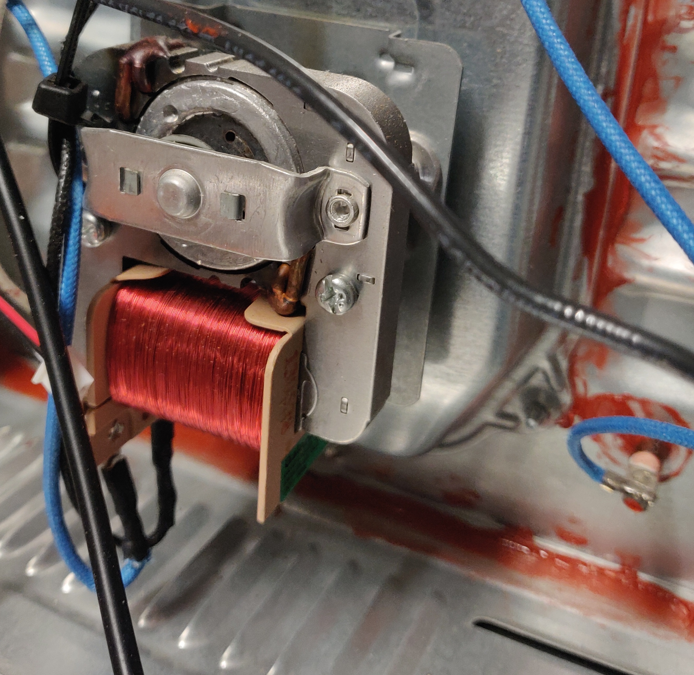

                                        Yeah, I did some research about halogen bulbs. They are basically the same as "quartz heaters" except the quartz heaters are red instead of clear for halogen bulbs. Halogen bulbs give off about 3.5% of watts as light, the rest is "waste" heat. It just so happens that I'm pretty happy with 96.5% heat for a few bucks. I may end up putting the halogen bulbs in some perforated metal tubes, that seems to be common for quartz heaters.
                                        I just hooked up the fan, I thought it was going to need a speed control, but the fan isn't terribly strong and there are apparently guides in the unit that take air in from the middle and send it out the top and bottom, near the heaters. I couldn't ask for a better setup. I'm curious how much it actually affects the heat though.
                                        You can see in the pic my first cut at sealing the oven with high temp RTV silicone. You are certainly right about these ovens being poorly insulated. There's zero insulation and the seams aren't well sealed either.
                                        If it doesn't cool down on it's own fast enough after being insulated, I could easily rig up a stepper and leadscrew to open the door.
                                        I'm planning on running this with a 3d-printer software, klipper. Having gcode specified heat profiles sounds very appealing to me.
