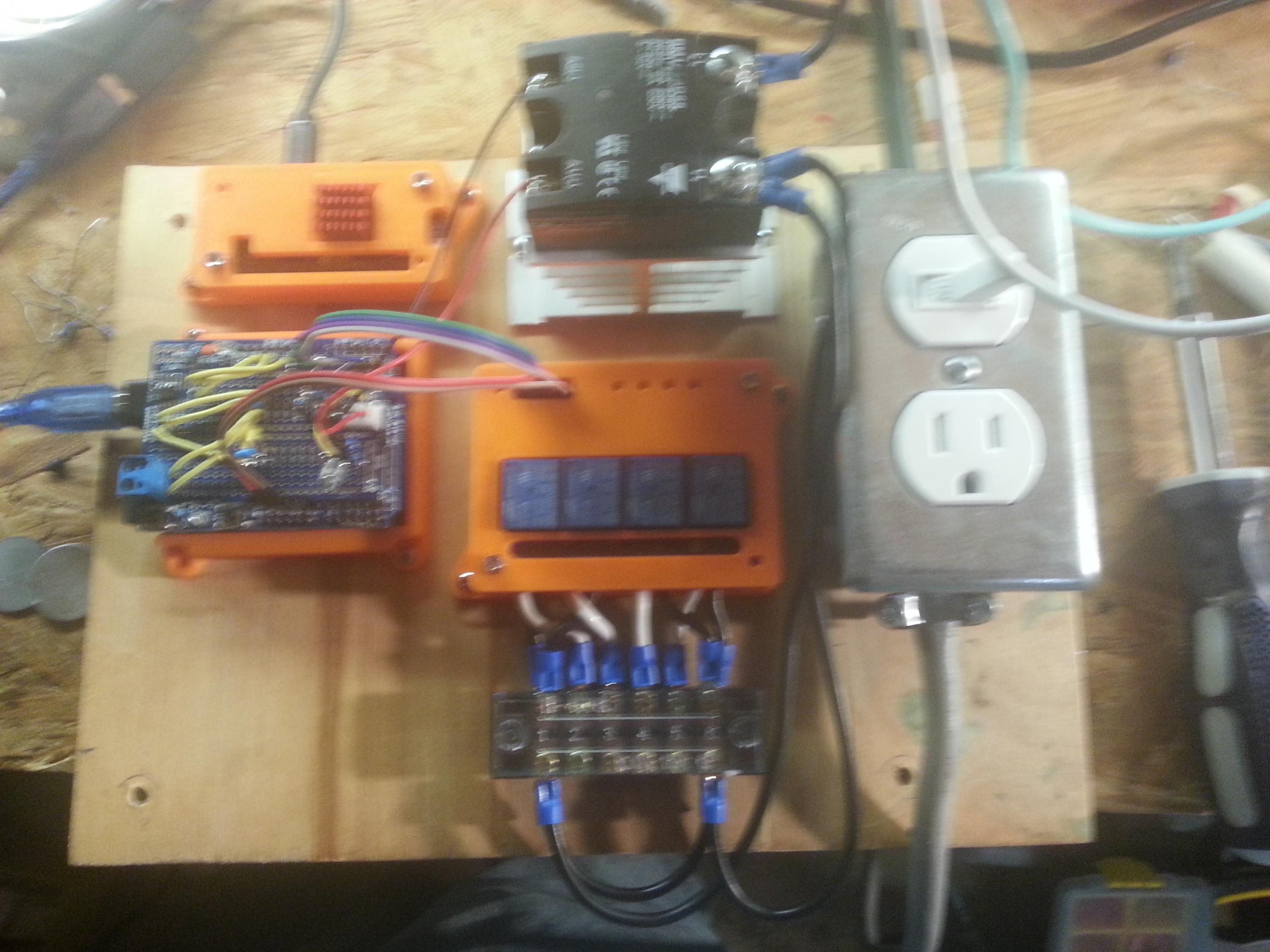

          In case anyone was interested in an update, I have the hardware together, and the software about 50% there.
          Here's the electronics on my bench, ready to be wired to the oven.

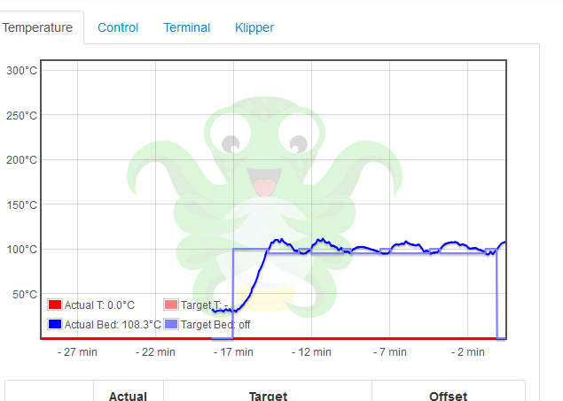

          And here's the first pid tune. Temperature is a bit shaky, after the pid tune, I'm getting 0-7C overshoot. I need to take the noise out of the thermocouple first. If that doesn't work, I might have to replace the max6675 (I found it in my box...) with something a bit more modern. On the plus side, that was with only 25% of heating capacity, I only had the lower resistive elements on and the fan on. The ceramic insulation really helped out. The down side is that cooling may become an issue, the oven now holds heat for a long time.

            Way Underdamped
            Still impressive!

              Yeah, I think it's error from the noisy thermocouple, messing up the pid tune. This was just a dry run, so I have probably almost an extra meter of thermocouple wire hanging on there acting an an antenna for stray signals. I'm going to trim that and wire it up in the morning. I think that should help quite a bit. I have worked with these max6675 in refrigerators in the past, and I don't remember them being quite this noisy. You would think they would receive some noise from the compressors... Now that I think of it, I always ran software SPI, and I ran them slow. This one is running hardware SPI, and at the default, it's a bit faster. I may have to slow down the clock.

                This is usually indicative of lag in the loop. That may be a true "delay" (in sensor or actuator) or an effective delay (e.g., thermal mass of heating elements).
                I can't recall if you have true proportional control or just on/off. In either case, it might help you troubleshoot the system if you can superimpose the actual control signal on the plot. I.e., you'd be able to see if the process was "coasting" past its setpoint or if the controller wasn't adequately anticipating response.
                If you can get actual coefficients out of the controller, there are tools that you can use to model the loop to see how tweaking those could improve your response.

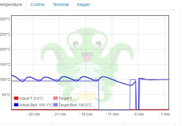

                  I have another thermocouple, just a cheesy, plastic jacket "waterproof" (it's not at the end) typek thermocouple. I left it long, and tested. Lots of noise. I cut it short to about 1' long, I had only 0.1c movement, great improvement. Can't put it in the oven, it's guaranteed to melt.
                  So I cut my oven type-k thermocouple short. Still a lot of noise. The oven thermcouple is stainless braid jacket with two seperate high temp wires in the braid. It's also mounted in the oven, and the oven is connected to ground. If I tie the thermocouple shield to ground on the arduino, I get +/-0.1C temperature stability. Are there any downsides to doing this?

                    Making progress! This is what it's supposed to look like when you do a pid tune in klipper. Look at that nice steady temp holding afterwards (ignore the gap, I borked it up and had to reset).
                    Garbage in, garbage out. Nicely tuned thermocouple, much better results!

                        toaster oven: found on neighbors curb
                        4 relay board: from stock, a few bucks originally
                        arduino: chinese clone, $3
                        arduino shield: $2
                        max6675: Probably $7 10 years ago
                        thermocouple: from stock, $3
                        carlo gavazzi relay: ~15$ over 10 years ago. It failed, tossed in box, pulled out and repaired because I needed a SSR
                        big relay heat sink: don't remember
                        ceramic insulation: $16 from grainger
                        high temp silicone: $6 home depot
                        raspberry pi zero: ~15 from sparkfun
                        OTG usb adapter: a few bucks
                        Two halogen light sockets: ~$3 each from china
                        two halogen lamps, 500w: from stock since my halogen lamps busted
                        high temp wire (2mm^2 IIRC): ~10 I think, from china
                        hardware
                        electric box, switch, plug, cord, terminal strip, usb charger: no clue, had in stock
                        hardware, threaded inserts for protecting cords entering/leaving the oven
                        I'm sure there's something I'm forgetting, but that list is pretty close.

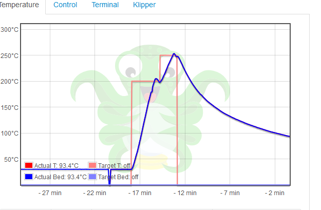

                          More testing. 75% heat, lower resistive heater with both upper and lower 500w halogens. I started out going for 200C without any pid. Ramp up was quicker than I expected, and hey, nothing lit on fire, so after checking on it, I went for 250C. I sure like the slope of those lines. I don't think I'll have any problem running lead free reflows (not that I will, I'm all about the Pb). I'll have to tune things a bit and make a reflow profile, but I can easily see starting the preheat/dryout with top and bottom resistive heaters (getting them good and hot) and when it's time for the reflow swapping over to the halogens for a quick burst of heat to get to liquidus, hold for 30, and back down again.
                          Maybe I go full blast with all heaters, cut the resistive heaters at liquidus, hold with the halogens and ramp down with the halogens. Since the profile has to run in 8 minutes, the oven isn't soaking up as much heat as I thought it would. Cooling shouldn't be a problem.
                          Though admittedly, this is an unloaded test. I don't think a board is going to add a lot of thermal mass though. And these are air temps, not top of the board temps.
                          Tommorrow I'm going to have measure the resistance of the heaters and do some math. The oven was rated for 13a, and I added two 500 watt elements which puts me over a 20a circuit, barely. If I downgrade to 400w bulbs, or maybe a 350 on top and keep the 500w bottom, I could squeak by at a touch above 19a. I don't know how much I trust the labels on any of them though. I really want to be able to run this from a standard 20a circuit.
                          I need to fashion some shields for the halogens too, at least the top one, I can't actually look into the oven when they are on, it's like staring into the sun.

                                Making progress! This is what it's supposed to look like when you do a pid tune in klipper. Look at that nice steady temp holding afterwards (ignore the gap, I borked it up and had to reset).ATTACH]211640[/ATTACH]
                                Unless you can see the "control" signal on the graph, there's nothing to say that it's not "holding" just because the enclosure isn't "leaking".
                                What you want to see is the control and the sense before you can attest to the performance of the controller.
                                It still seems like there is a lot of lag -- when the heating elements are turned on, they overshoot, considerably. (again, without seeing the control signal, you can't tell if this is because they are being commanded to remain on or if they just "coast too far", once engaged.

                                  GC: The first part of that graph is the software measuring the system, overshoot is expected and a desirable part of the measurement. The second part of the graph overshot a smidge because I didn't turn on the pid controller. You see the signal drop to zero because I took it offline and reconfigured it with the pid parameters. After that, the temperature overshoots a tiny bit because of the heat already in the system, but after that it holds solid.
                                  I don't have anything on the graph to show the controller clicking on and off, but I did build an led into the arduino that will turn on when the heater is engaged. Yes, there is an LED in the SSR that performs the same purpose, but the one on the arduino is considerably brighter, it's much easier to see.
