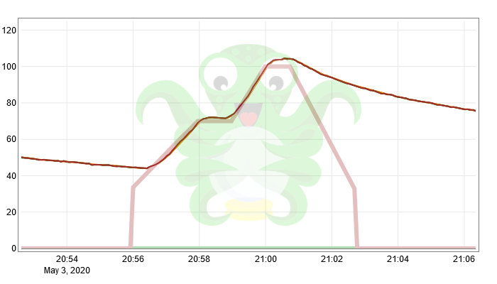

      I wrote some python scripts to manage the gcode for holding temp, ramping up and down and made a go at a test trapezoidal reflow (at lowered temps). Pretty good considering I left the door open for the first ramp up, which also probably explains the overshoot at the top. The ramp down diversion was expected, that's a maximum decrease slope, i.e. if the oven cools any quicker than that, it needs to add heat to slow the cooling. Also at higher temps, it would ramp down quicker.
      It's also a very smooth ramp considering it changes the temp every five seconds, so the target isn't a straight line up as octoprint shows it, but a stair step shape. But that's pretty normal for CNC machines/3d printers, any diagonal line is, at a micro level, a lot of very small steps.

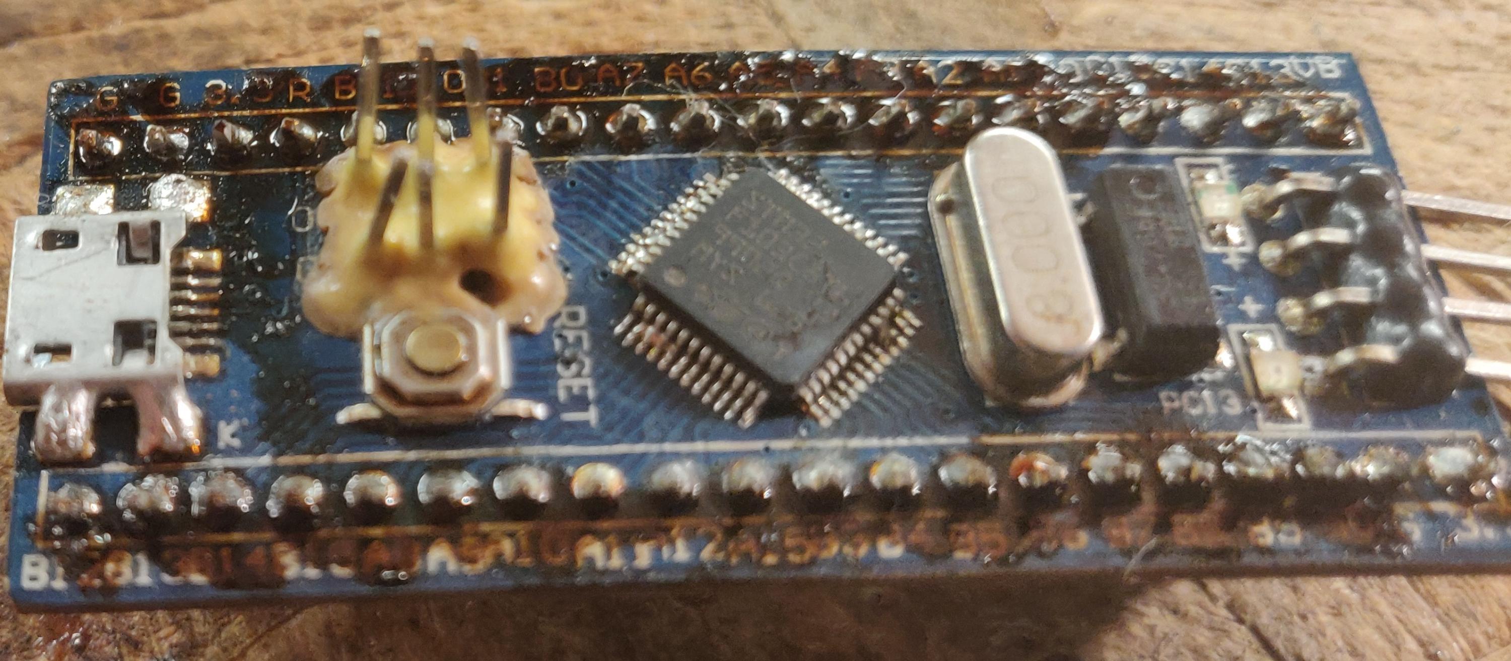

                      It's ugly, but I'm calling it a minor success. Yeah, this board didn't look good before this, the chip was already fried, were it not already fried it would have been needed to dry out first (moisture sensitive part), and yes, I didn't remove the plastic parts before reflowing, but I just wanted to see if I could get the solder melted. No problems there. In retrospect, there were some issues though.
                      1) I read the wrong lead solder paste profile. Most are a bit colder than the one I used.
                      2) I programmed it on the faster end of things. A more gradual curve wouldn't have hurt anything and probably would have allowed the oven to heat up a bit and the final ramp to go quicker.
                      3) The way I programmed it, I think it was working against the pid control. I had set it up to update the setpoint every two seconds, but I'm not sure that took advantage of the Integral part of PID, i.e. the algorithm always thought the goal was close, so I don't think it ramped as fast as it could have. My testing showed that the oven could achieve 1.3C/sec up to 225 (IIRC, maybe 200C), and the oven was not hitting the numbers when I was ramping at 1C/sec. Granted, this time the oven had some load, but this was a puny bluepill board, with a negligible thermal mass.
                      4) I was hoping I'd not have to insulate the back, but I think I'll be bending some flashing tomorrow to make a back that I can stuff some insulation in. Once that is done, only the front door remains uninsulated. Hope that can give me a touch more heat. I'll probably have to fashion a gasket for the door, but it seals decently well right now.
                      5) I slapped on the paste too thick. And here I thought I was going thin. A little really goes a long way. I counted eight solder bridges.
                      6) A door opener might be required, or at least a buzzer to tell me to open the door.
                      What went right?
                      1) Well, the software did exactly what I asked it to do, though the end product wasn't right. That's always nice.
                      2) The chip ended up aligned pretty nicely on the pads, I was concerned about the fan possibly knocking it out of alignment, or possibly drift when the solder melted.
                      3) The solder melted pretty nice even though I applied too much. I didn't see any solder balls. No solder balls behind the pins afaik either.
                      I have some things to think about, and some tasks, but nothing insurmountable. In the meantime I have been getting good use out of the oven at lower temps, this may become one of my favorite tools.
                      So here's the result, warts and all. Truth be told, the board looked pretty bad going into the oven, so I can't pin it all on the reflow.

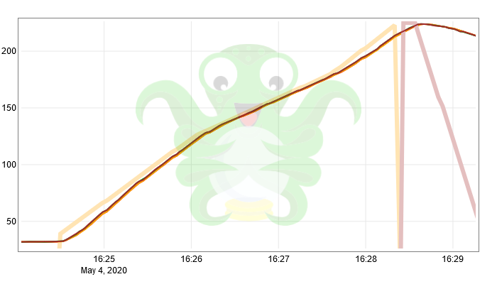

                          I added insulation around the oven door to seal the crack.
                          Made a back panel out of flashing to put insulation on the back outer wall.
                          Ran a test. Still 1.3C/sec. Grumble.
                          Double checked my halogens, one was 500w, the other was 350w. So I upgraded to 500w/500w. Now I'm at 1.4C/sec. I'd have liked to hit at least 2C/sec, but at that rate, I'd need another 900w to get to 2C/sec. Or more insulation. I don't have much room between the oven chamber and the outer metal case, it's packed pretty full of the ceramic insulation. The other option would be to add some reflective matting that seems to be the rage among reflow oven builders.

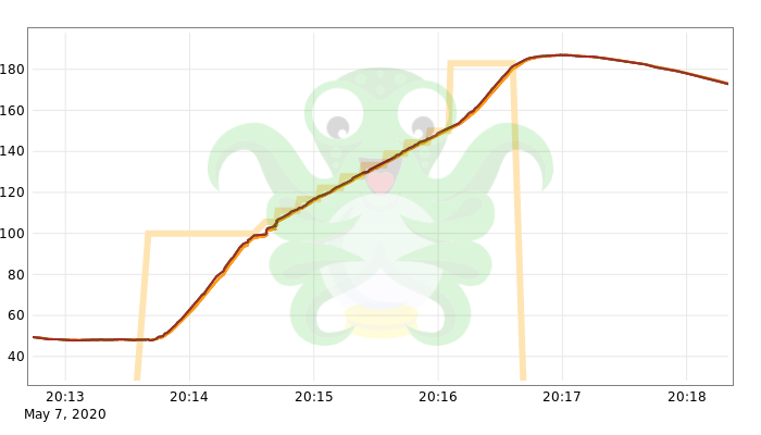

                          In related news, I reprogrammed the gcode to get a better controlled slope where required and max output for when the required temp gain is closer to 1.4C/sec. Pretty happy with the slope. Near term I'm going to have to add at least a buzzer, longer term a stepper to open the door.
                          GC, thanks for the docs, I'll read up, though my latest test I'm getting only 5C overshoot with all the heaters on, which isn't that bad considering.
