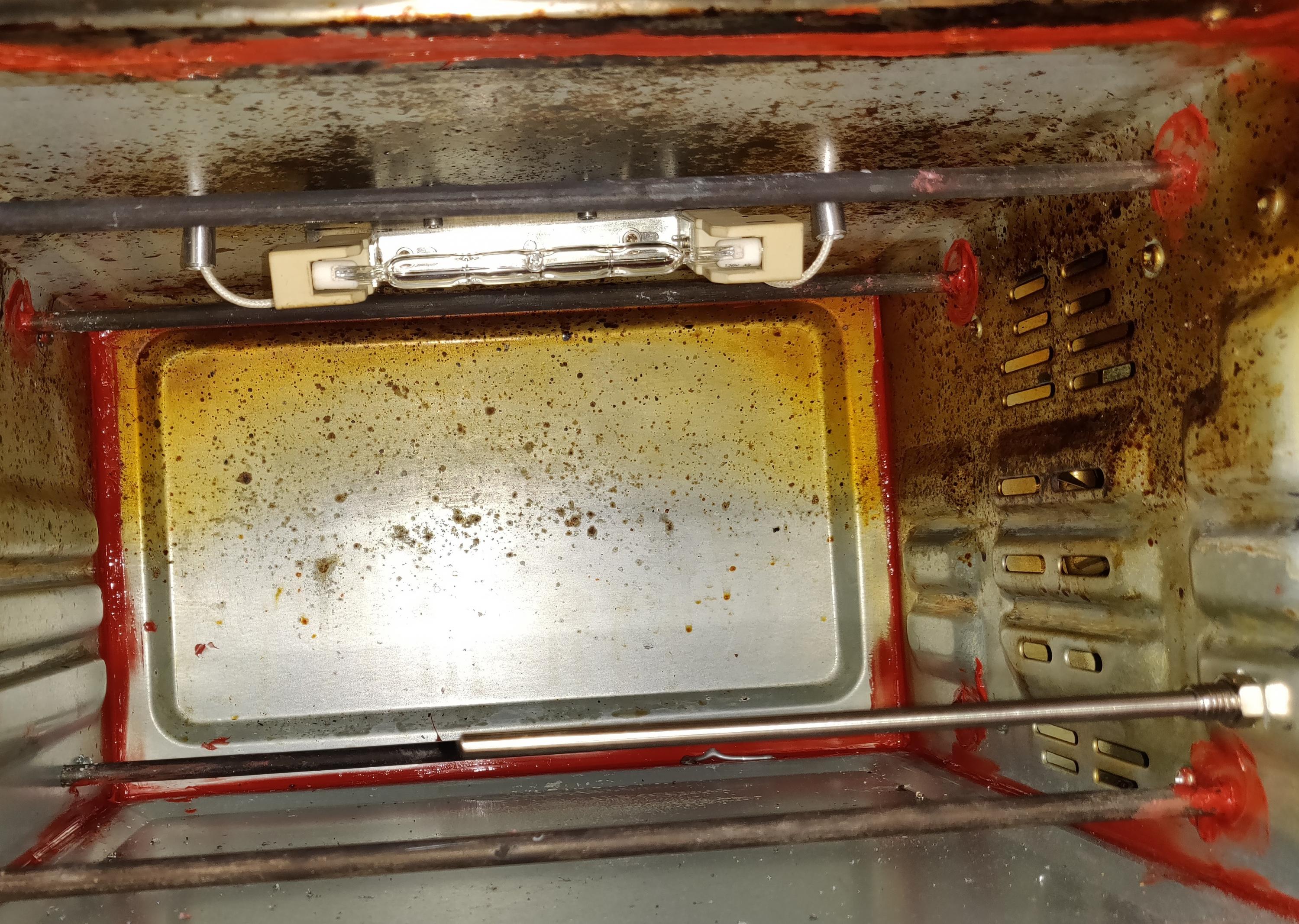

            Pretty happy with how this is turning out. With the fan on, I was easily getting 1C per second from cold to 200C. It slowed a bit after that, took a while to get to 230C. Strangely, I cut the power to the elements and the fan, and the temp immediately shot up to 270C. I'm not exactly sure what happened there, maybe the heat rose? I'm not actually using the thermocouple shown in the pic yet, I had a different one hooked to my meter and it was about midway in the toaster, about where I would expect a pcb to be.
            I bent a piece of stainless to mount the bulb holder and used two threaded rivets to snake the power through without fear of cutting the wire. Rivets aren't clamped down or sealed yet, so there's two holes in the top of the box still and no insulation. If I insulate it, I probably won't even need the second halogen bulb, though two halogen bulbs would probably hit the peak faster and cool quicker than using the resistive heaters.

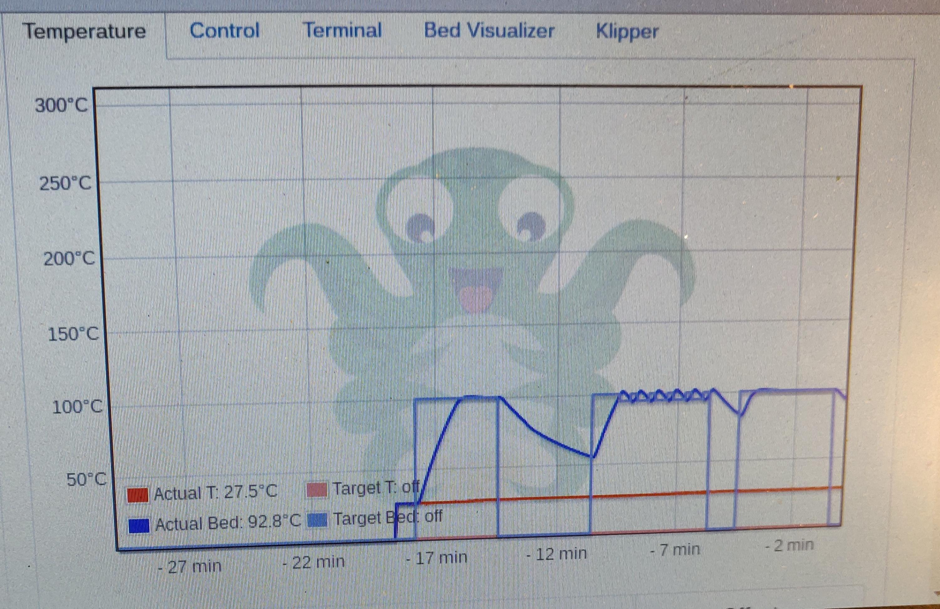

                Well, I hate to do this to you, you really sound like you know all the vagaries of PID control. But really, with klipper, I push the button, after giving it a target set point and it runs a PID tune for me. It saves off the three pid values, and uses it the next time I turn on the heaters. Honestly, I have never bothered to learn the PID algorithm because it works so darn well out of the box.
                Here's a pic. The first temperature rise was manually setting my printer bed to 100C. Pretty good, it was holding within 3c. It has been a while since I ran a pid tune, and I had changed my default temperature, so it was time. I run the pid tune at 100c (I think my last one was at 60c), the software cycles the temp around 6 times, I accept the changes (off screen). I manually set the temp back to 100C. It overshoots to 100.8c, then comes back down to 100.1c and bounces between 99.9c and 100.1c. Pretty good for "I push the button."
                Now, what you say is true about large thermal masses, I honestly don't know if a large board vs a small board is really going to make a lot of difference in the thermal mass in relation to the heating capability of the oven. If it does, I could certainly run a pid tune with a large object and later a smaller object and save the values, using them selectively based on the size of the board.
                There are a fair number of custom reflow softwares out there, but when I looked, they are pretty tightly linked to specific hardware implementations. Going with klipper, it's a more general purpose (though the author would disagree, 3d printers only) software that supports many boards, probes, configurations, and has many, many features. It's truly overkill for this application, but that's what I like about it. Nearly every feature I could think of is already supported and well tested, and I know it well because I use it on my 3d printer. If klipper doesn't support it, there are well documented frameworks for implementing a custom gcode (I may have to make one or two before this is over.) And octoprint (works with klipper) supports an insane amount of plugins.

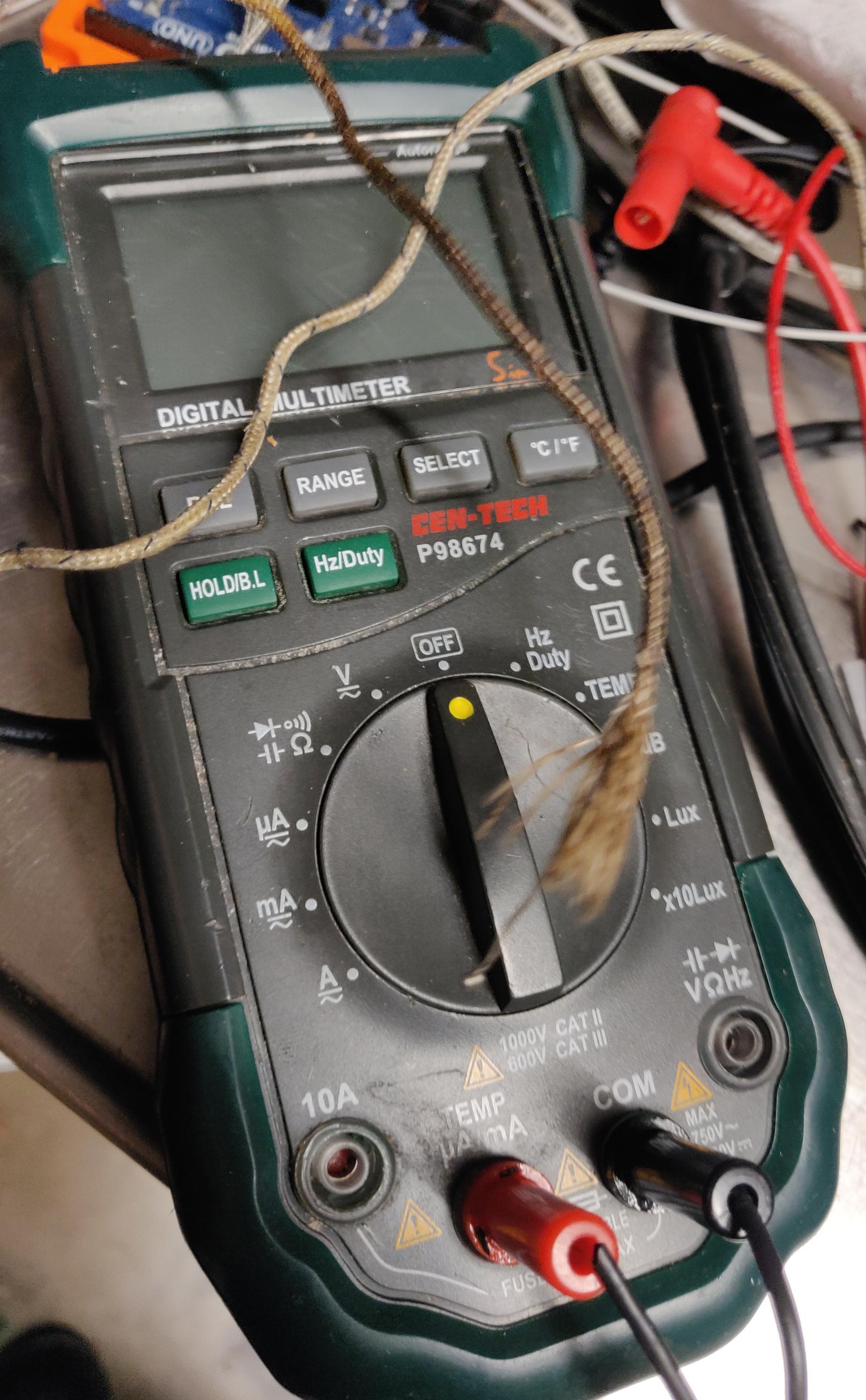

                  Usually a small tiny thermocouple (not in a thermowell) is used.
                  The one in the pic thermocouple looks big which means it has high thermal mass (slow responding) with some conduction heat loss to the oven side wall. If it's right over a heater, when you unplugged things the heaters take time to cool, loss of fan means a thermocouple gets that extra heat for a short time. I think that's why it climbed up. Not sure what you actual temp sensor looks like.

                    Yeah, the loss of the fan was what probably did it, but it wasn't really close to any heater, it was as close to dead center as I could get a loose wire with the door shut.. It was a tiny thermocouple that came with my meter, looks like a k-type.
                      The coefficients (assuming the controller only uses the three "classic" ones and doesn't support bumpless transfer, integrator windup, etc. features) will change based on the operating point. (Note that the operating point is deliberately changing based on your profiles) The "system" that you are controlling hasn't been designed for its specific purpose but, rather, thrown together with the controller expected to magically fix its shortcomings.
                      So, you may find that the loop works well at a particular temperature/mass mixture but performs poorly at another. E.g., the effort ("amount of control valve action") required to raise the temperature 1 degree at 50C will be significantly different than at 100C. Likewise, the heat loss/cooling at those points will differ. I.e., the system being controlled is non-linear.
                      You may also find that the setpoint changes introduced by the "profile" lead to a loss of control at those points in time, depending on their magnitudes. A change in the setpoint effectively looks like a disturbance in the process variable. E.g., raising the setpoint 5 degrees looks like someone might have just opened the door (causing the temperature to "fall" by those 5 degrees).
                      You can design a controller to recognize the difference between these scenarios (because it can see that it's setpoint is changing if it watches the set point's value and not just the "error" term). A smart controller can even dynamically adjust the gain (and deadband, windup, etc.) parameters based on the current value of the setpoint to compensate for the dynamics of the process.
                      How "good" the controller is working isn't evidenced by the size of the numbers -- without knowledge of what the system's inherent response is. One thing we often do is disable our controls to see if we're actually improving the process's inherent control or making it worse (yes, a controller can overact and make things worse than they might otherwise be in its absence).
                      You should look at particular profiles to get an idea as to how a particular set of tuning values works FOR THAT PROFILE. (assuming you can save/restore them from secondary storage). E.g., if a profile calls for operating at an elevated temperature, you would want to know how the controller works AT that elevated temperature. Likewise, how it then adapts to a different preheat/cooldown temperature (if it is too lsow to cool down, you may need to deliberately alter the profile to compensate for its sluggishness -- or, increase the size of the vent/fan in your oven).

                                No one likes the graph I posted above? I think octoprint is pretty slick... Looks a lot better when I'm not taking a cell phone picture of an lcd screen too.
