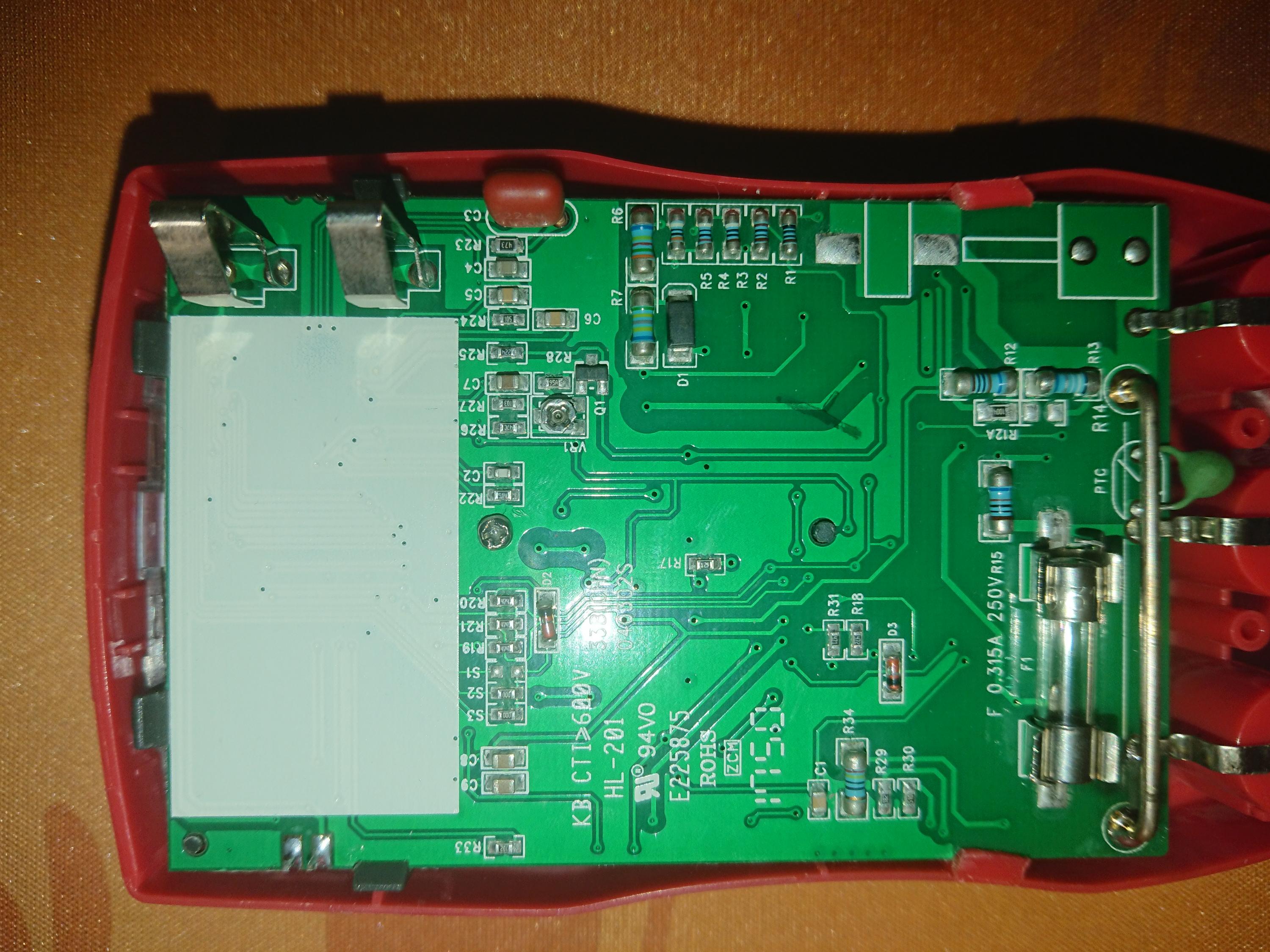

    Hi! So, a couple of months ago, I got tired of me watching my movies and when someone flips a certain switch in the house, my Blu-Ray to stop working for a second, then come back on (the TV being fine, mind you, connected both at the same outlet). So, I took my multimeter (Uni-T UT33B) and tried to measure the voltage of my outlet when that switch is flipped. Dumb me, I set the multimeter for DC Voltage, while connecting the red cable to the Unfused connection. Of course, both the fuses in the multimeter and in my house blew.
    Now, I replaced the fuse in the multimeter, but it still doesn't measure anything. I'll link a video in Google Photos of how it behaves when I don't have anything connected. I suppose there is a short-circuit inside the multimeter somewhere.

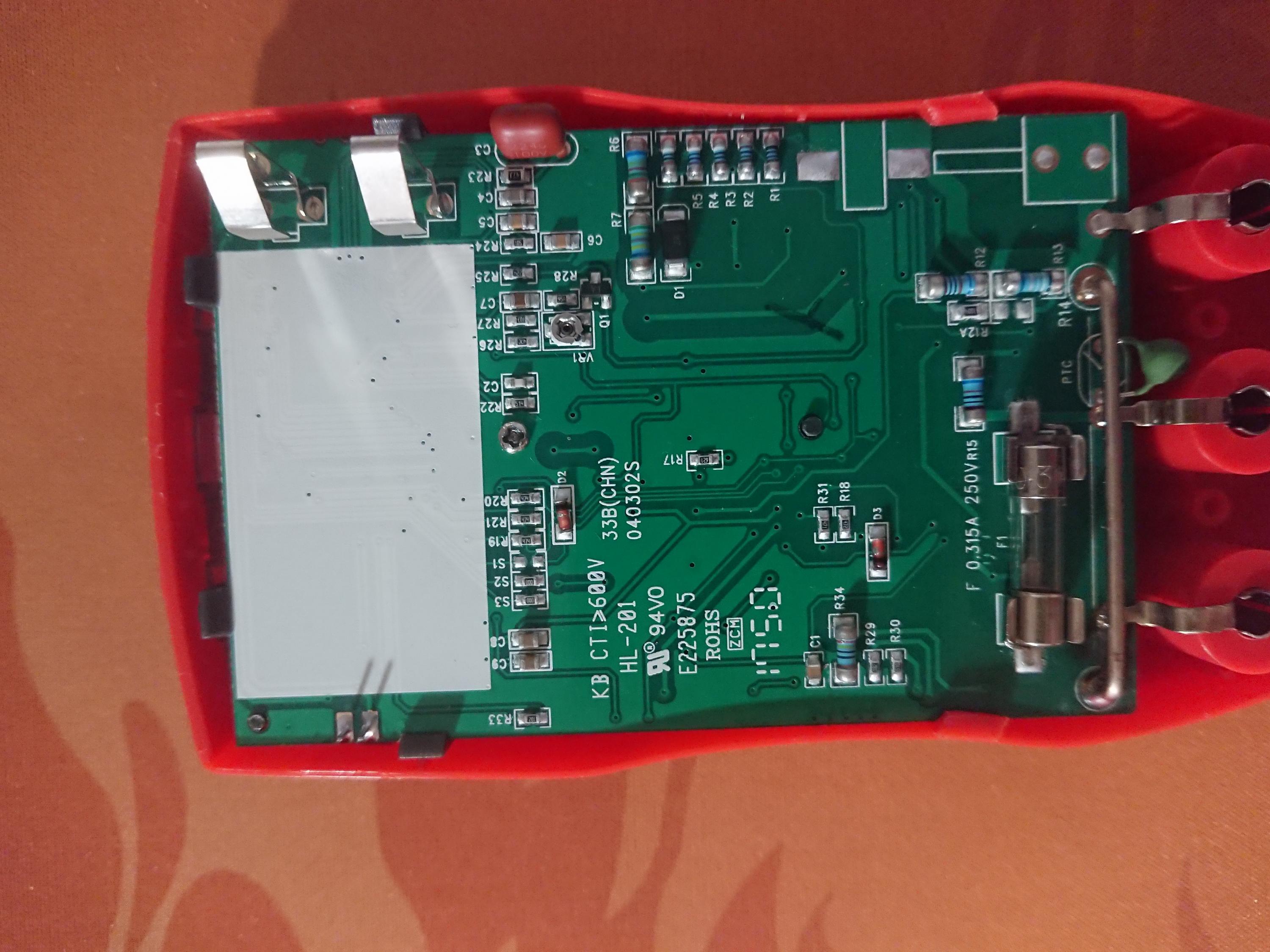

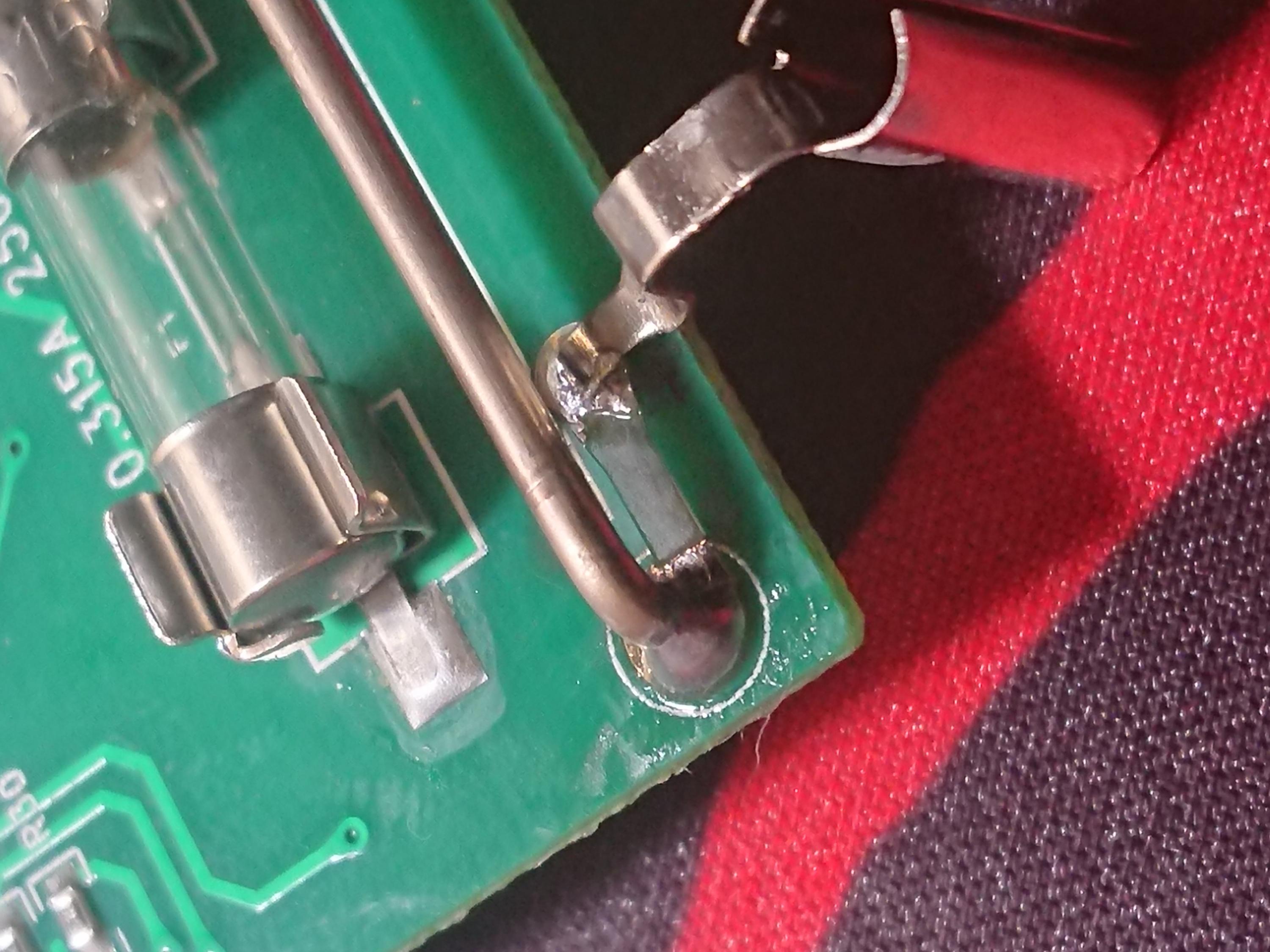

    I'll also upload down below a photo of the board of the multimeter. If needed, I'll try and find a schematic of the board as well.
    Any advice on getting this back up and running? I don't want to spend money on another UT33B, rather I'd buy a better multimeter, but I don't want to spend that kind of money right now, as I'll soon need a serious laptop for Video Editing and Android Studio, and those are very expensive.

        take the board out and check for burned tracks near the sockets

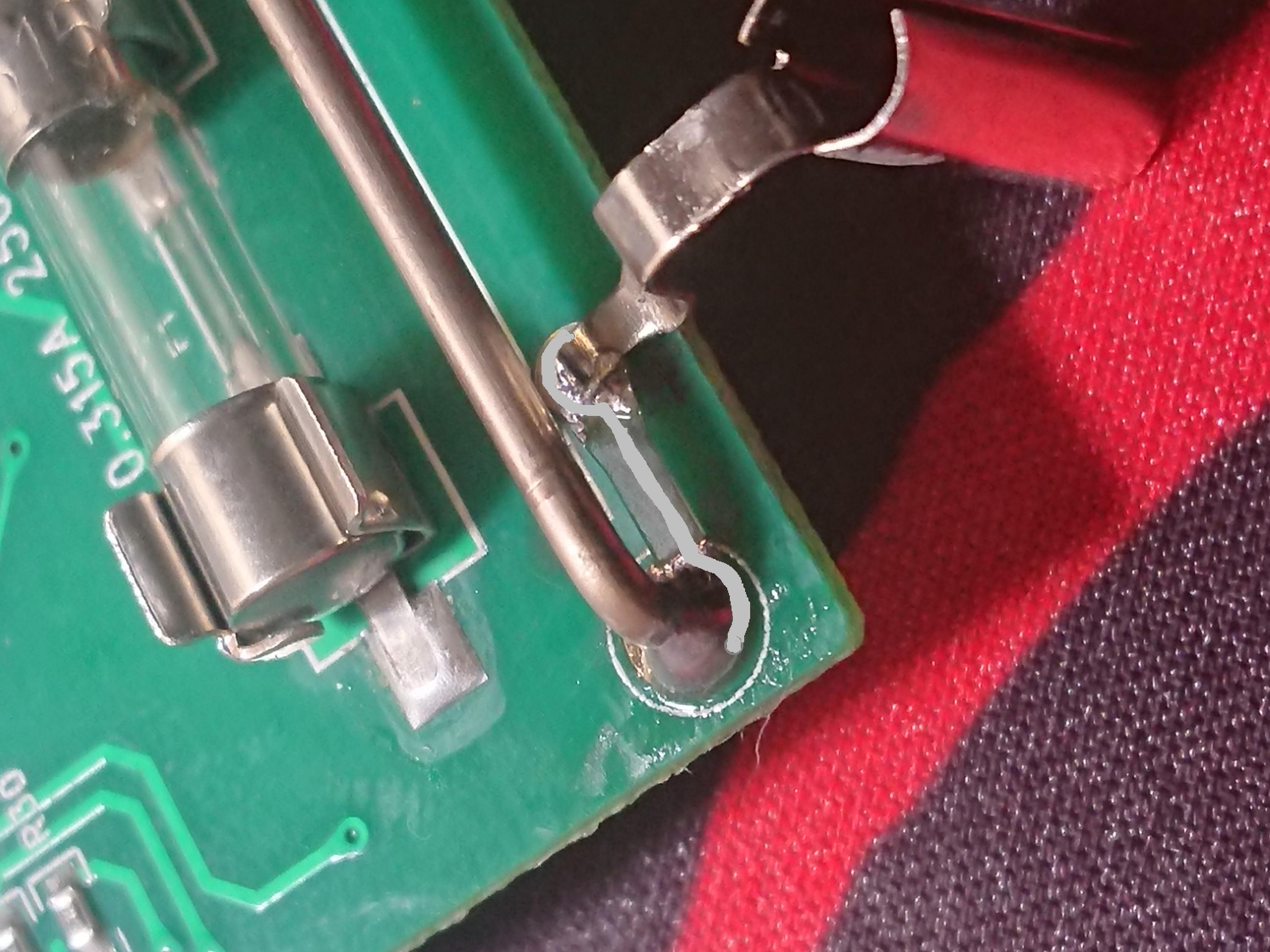

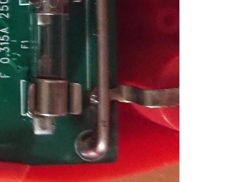

          There are some burn marks at the joint of the socket with the board and with that big metal bridge, I'm not sure how to call it. You can see it in the pictures above. Can those marks cause the multimeter to malfunction?
            Re: Why does my Uni-T multimeter not measure anything?
            It is hard to see. May be the trace is blown up.
              I thought about that. However, I'm not sure that can cause a short circuit in the multimeter.
              I'll try and take a better photo of the burn tomorrow and upload it.

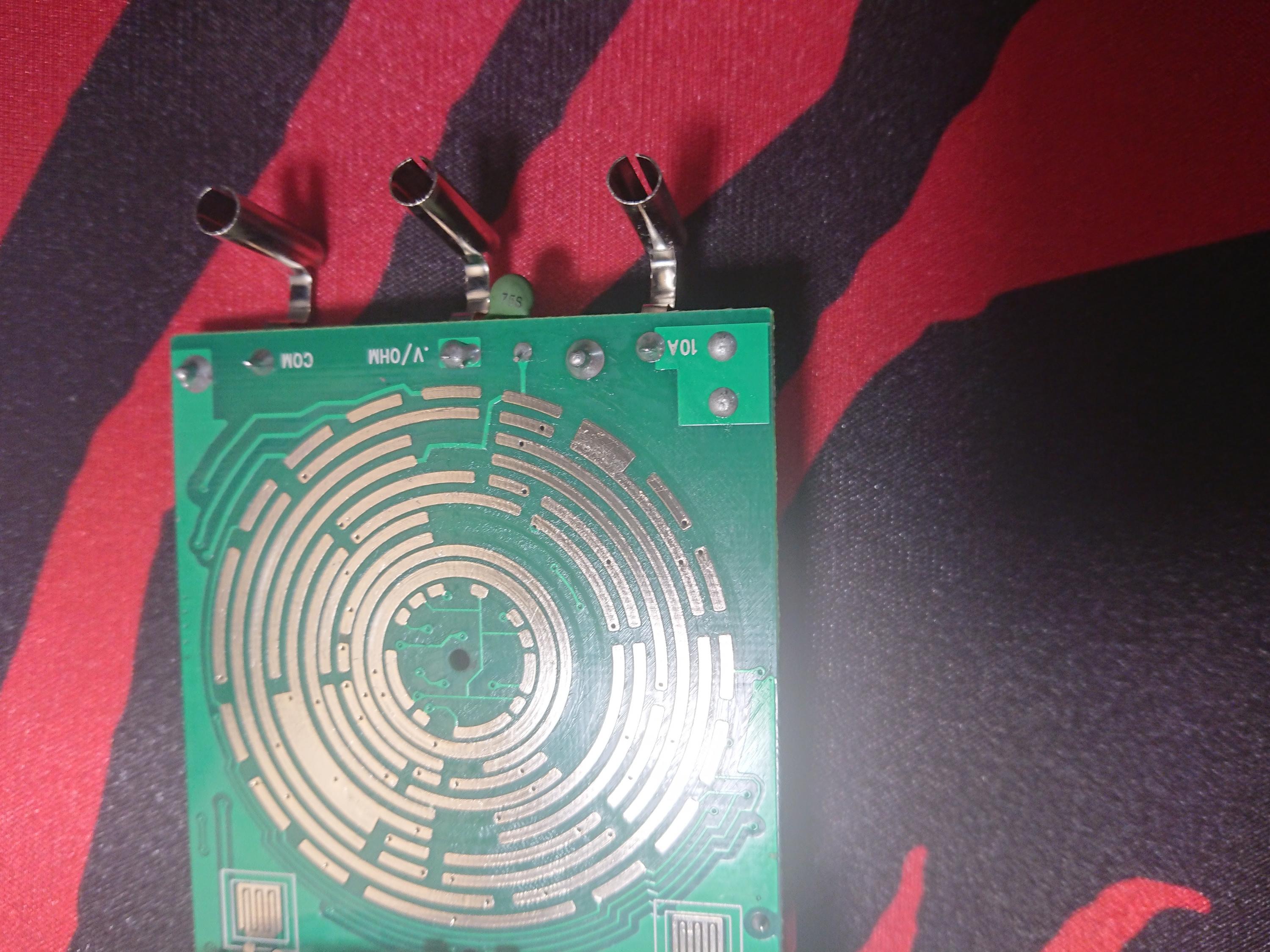

                If the trace from the probe receptacle is blown then the probe is no longer connected to the meter circuit.
                https://www.badcaps.net/forum/attach...1&d=1573479529
                You have 3 probe socket, what are each one since we cannot tell which is which because there is pictures of the front side of the meter, also no pictures of the other side of the board that we can see.

                  From down to up: Common, Fused, Unfused.
                  Bottom is Common, Top in Unfised.

                            If the trace blew it would likely be in this area. Is this where the black smoke is? clean any black soot from the board and provide a clear picture of this area. The COM jack likely connects to the end of shunt wire and also to a trace that connects the COM to the meter common circuit
                            If you look at the schematic you will see that the COM connects to one ind of R14 (0.01Ω) this is the large wire shunt. It also connects to the comon ends of R17,R29 & R30.
                              Yes, that is exactly where the smoke is. I'll provide that photo tomorrow, as it's 00:29 right now where I live and at 06:20 I have to wake up.

                                The blown trace could also be on the other side of the board, it is a double side circuit board.
                                  I'm pretty sure that trace is done-for.
                                  As for the other side, it looks fine.
                                    Yes, that trace is gone, so get a thin piece of wire and solder it between the COM and the wire shunt. Using a thin piece of wire would be better in case the mistake is made again. I suspect the meter will work fine after that.
                                        As promised, I'm reporting back. The multimeter is back up and running.
                                        Thanks to everyone who contributed!
