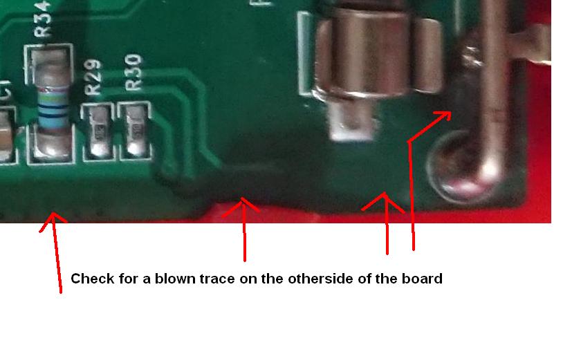

Why does my Uni-T multimeter not measure anything?
    replied
    Re: Why does my Uni-T multimeter not measure anything?
    or put an inline fuseholder on the probes wire - fluke sell a probe like that!
    Leave a comment:
  • Retro-Hipster
    replied
    Re: Why does my Uni-T multimeter not measure anything?
    Ah... it's a shame a board that spacious doesn't have A) a 10a fuse and B) HRC fuses...
    Ironically, that little gap where the trace was would probably fit one of those tiny 10a hrc axial lead fuses and give your meter an upgrade. Lol (Just heat shrink it well to keep it from the shunt/other terminals.
    https://cdn.badcaps-static.com/pdfs/...b127d9a063.pdf
    Leave a comment:
  • Retro-Hipster
    replied
    Re: Why does my Uni-T multimeter not measure anything?
    STJ speaks wise words. lol
    Also, I know that this situation is a bit different since you were testing the socket, but if you work commonly with mains stuff I would suggest making a light bulb current limited supply. For the cost of an extension cord, a ceramic light socket and a tungsten/halogen bulb, you can have a socket that will light the bulb up when you make a short while also protecting your equipment/device under test..
    Leave a comment:
    replied
    Re: Why does my Uni-T multimeter not measure anything?
    i avoid this by blocking the current jack on my meters and only testing current with a clampmeter.
    Leave a comment:
  • antoniu200
    replied
    Re: Why does my Uni-T multimeter not measure anything?
    count yourself lucky . i still have 3x £100 meters with lots more damage from doing same thing .
    well i say 3 i mean 2 . one got hit with about 20k volts .
    I know I am. Lucky because that 315mA 250V fuse blew before any more damage was done. If that fuse hadn't blown, I wouldn't have this mulimeter back up again.
    Leave a comment:
  • petehall347
    replied
    Re: Why does my Uni-T multimeter not measure anything?
    count yourself lucky . i still have 3x £100 meters with lots more damage from doing same thing .
    well i say 3 i mean 2 . one got hit with about 20k volts .
    Leave a comment:
    replied
    Re: Why does my Uni-T multimeter not measure anything?
    Thanks for the follow-up.
    Leave a comment:
  • antoniu200
    replied
    Re: Why does my Uni-T multimeter not measure anything?
    As promised, I'm reporting back. The multimeter is back up and running.
    Thanks to everyone who contributed!
    Leave a comment:
  • antoniu200
    replied
    Re: Why does my Uni-T multimeter not measure anything?
    Originally posted by R_J
    Yes, that trace is gone, so get a thin piece of wire and solder it between the COM and the wire shunt. I suspect the meter will work fine after that.
    Thanks! After I do that, I'll report back.
    Leave a comment:
  • R_J
    replied
    Re: Why does my Uni-T multimeter not measure anything?
    Yes, that trace is gone, so get a thin piece of wire and solder it between the COM and the wire shunt. Using a thin piece of wire would be better in case the mistake is made again. I suspect the meter will work fine after that.
    Last edited by R_J; 11-12-2019, 04:09 PM.
    Leave a comment:
  • antoniu200
    replied
    Re: Why does my Uni-T multimeter not measure anything?
    I'm pretty sure that trace is done-for.
    As for the other side, it looks fine.
    Last edited by antoniu200; 11-12-2019, 03:07 PM.
    Leave a comment:
  • R_J
    replied
    Re: Why does my Uni-T multimeter not measure anything?
    The blown trace could also be on the other side of the board, it is a double side circuit board.
    Last edited by R_J; 11-11-2019, 04:48 PM.
    Leave a comment:
  • antoniu200
    replied
    Re: Why does my Uni-T multimeter not measure anything?
    Yes, that is exactly where the smoke is. I'll provide that photo tomorrow, as it's 00:29 right now where I live and at 06:20 I have to wake up.
    Leave a comment:
  • R_J
    replied
    Re: Why does my Uni-T multimeter not measure anything?
    If the trace blew it would likely be in this area. Is this where the black smoke is? clean any black soot from the board and provide a clear picture of this area. The COM jack likely connects to the end of shunt wire and also to a trace that connects the COM to the meter common circuit
    If you look at the schematic you will see that the COM connects to one ind of R14 (0.01Ω) this is the large wire shunt. It also connects to the comon ends of R17,R29 & R30.
    Last edited by R_J; 11-11-2019, 04:33 PM.
    Leave a comment:
  • antoniu200
    replied
    Re: Why does my Uni-T multimeter not measure anything?
    I did try that. It showed OL.
    As for the blown trace, it's definitely seen some good black smoke. It could be blown, it could be fine. Not sure how to test that without another meter.
    Last edited by antoniu200; 11-11-2019, 04:21 PM.
    Leave a comment:
  • R_J
    replied
    Re: Why does my Uni-T multimeter not measure anything?
    NO. you should LOOK to see if there IS a blown trace. don't start adding jumper wires.
    Have you tried placing the meter in Ω and check what resistance you get when you short the probes together? maybe the meter is working.
    The way you had it connected, the large wire shunt was connected across the 10amp and COM jacks. That is what blew the house fuse. it was like connecting a wire across the house outlet. BANG
    Leave a comment:
  • antoniu200
    replied
    Re: Why does my Uni-T multimeter not measure anything?
    The black lead was in the Common jack. The read lead was in the Ampere (Unfused) jack. I tried to measure DV Voltage with that configuration in an AC 230V outlet.
    So, where should I resolder the Common jack? Should I take a wire and solder the Common jack to the large wire? Would that be enough?
    What made me think there is a short circuit in the meter is the rise in resistance when I select Ω and then quick drop to OL. Same goes for voltage: see how when I come from resistance it rises and then slowly drops?
    Last edited by antoniu200; 11-11-2019, 04:10 PM.
    Leave a comment:
  • R_J
    replied
    Re: Why does my Uni-T multimeter not measure anything?
    Originally posted by antoniu200
    I thought about that. However, I'm not sure that can cause a short circuit in the multimeter.
    I'll try and take a better photo of the burn tomorrow and upload it.
    What makes you think there is a "short circuit" in the meter? Your video shows the meter working. When turned to 20MΩ it reads O.L that is normal, When turend to DCVoltage it reads 0.00 Volts which is correct without any "voltage" for it to measure. Have you tried it with the probes connected and placed in the Ω scale, short the probes and see what reading you get?
    Like others have said, when you connected the meter in the "10 amp configuration" You would have likely vaporized the trace connecting the probe jacks to the circuit. That large wire bridge is the 10 amp current shunt for the meter You likely blew the trace connecting the common jack to the rest of the meter circuit
    Was the black meter lead connected to the com jack when this happened? or was IT plugged into the VΩmA jack.
    Last edited by R_J; 11-11-2019, 04:07 PM.
    Leave a comment:
  • antoniu200
    replied
    Re: Why does my Uni-T multimeter not measure anything?
    From down to up: Common, Fused, Unfused.
    Bottom is Common, Top in Unfised.
    Leave a comment:
    replied
    Re: Why does my Uni-T multimeter not measure anything?
    If the trace from the probe receptacle is blown then the probe is no longer connected to the meter circuit.
    https://www.badcaps.net/forum/attach...1&d=1573479529
    You have 3 probe socket, what are each one since we cannot tell which is which because there is pictures of the front side of the meter, also no pictures of the other side of the board that we can see.
    Leave a comment:
  • madfreak
    Which multimeter to choose : BRYMEN BM 869S OR UNIT UT18B PRO ?
    by madfreak
    Hello, there were probably topics like this, but I need opinions about these 2 multimeters or maybe there is another one on the market worth to buy ? .
    I am going to change the multimeter and I do not know if the 2x higher price for Brymen will convert into speed and comfort of a work ...
    What would you recommend?
    Brymen BM869s or UNIT UT18B pro?
    I care about accuracy and security, and the meter will be used for computer hardware.
    Thank you very much in advance for your comments and suggestions
    04-30-2022, 01:10 AM
  • ngml
    Repair of an LG split AC system indoor unit PCB
    by ngml
    I am trying to repair an LG split AC indoor unit, which does not start and gives a CH05 error code.
    This indicates an error in the communication between the outdoor and the indoor unit.
    The outdoor unit is fine, so the problem is the indoor PCB.
    The indoor unit is an LG PC09SQ NSJ (3SNM09JA2FA), and the PCB has the following type number: EAX35907219-1.2 (see photo1)
    I changed optocouplers ICO1X & ICO2X and the NPN transistor S9013 which drives optocoupler ICO2X (see photo2), but this did not remedy the fault.
    Does anybody have the schematics of this board,...
    02-01-2025, 12:55 PM
  • DrDos
    Unit runs but no speaker output kenwood KR-6030
    by DrDos
    I have finished my work. The new lights come on except the one for stereo, I reversed the bulbs to no affect, anyway, the unit powers on, relay clicks. I have no DC voltage in speaker outputs, I also do not have any AC in the speaker outputs. There is some faint crackling in the speaker. This unit cranks up loud so I had the volume on very low. Everything seems to be fine but I can't really check the switch until I can get sound out of the outputs. I was going to do caps for the power supplys and the tone board but thought if it was cranking loud at one time maybe just leave it alone until it...
    09-14-2025, 09:57 PM
  • dj8452000
    How To Test a P-channel Trench Mosfet Using A Multimeter In Diode Mode
    by dj8452000
    I am new to electronics and I'm understanding most of what I'm reading but I have a mosfet on my board that I've identified as a P-channel Trench Mosfet. I haven't a clue how to test this and what I should expect to see with the multimeter probes. I am hoping someone with years more experience than myself can help me understand how to use a multimeter to read this. Please look at the drawing I have attached to this and can you try to explain to me what I should be doing with my multimeter in diode mode and what results I should expect from a good mosfet?...
    02-18-2025, 08:28 AM
  • yayayee
    ASUS GU502GV not powering on - 1285A hot
    by yayayee
    I have a laptop that isn't turning on. When I disassemble it and plug in the power connector with the pcb by itself, I can see with a thermal camera I bought that TPS51285A is the only thing getting hot.
    So of course, the first thing I do is google the laptop model and the IC, and it just happens that I stumble upon a video by Northridgefix attempting to repair the exact same problem, only for it to catch on fire.
    I thought that maybe I'd be lucky so I bought a 1285A, that came in as a 1285B. The only difference I can see between them is that the 1285B...
    01-08-2024, 11:04 PM
