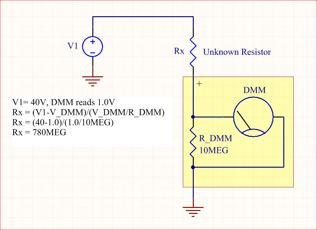

    Any old school way i can check a 600meg ohm resistor. Maybe like putting a frequency through it and using a scope?

              I just use a multimeter with known input resistance, say 20MEG.
              Set a bench power supply as high as I got, say 40VDC and measure the voltage. Then use the voltage divider equation to figure out the resistor's value.
              A multimeter reading of 1.290V for 600MEG in series with 20MEG DMM.
              Using a 9V battery, would read 0.290V for 600MEG, but susceptible to AC hum and interference, so you need a shielded, grounded work area.

                    Are you saying that when you measure the Vdrops across the 600M Ohns resistor with your DMM, it shows 1.290V?

                      Actually I think this is the way that's being described:
                      Equipment needed:
                      - 10MĪ© impedance or so DMM that can also measure millivolts.
                      If you don't know the exact impedance of the DMM, you'll also need a resistor of known value, say 10MĪ©.
                      - low impedance voltage source that does not drift within the time of your testing. Usually a good battery is good enough for government work. You may need multiple voltages if you go offscale.
                      - Calculator, unless you can do multiplication and long division with a writing implement and a pad of paper.
                      Step 1:
                      Measure voltage of your voltage source using the multimeter. Record that.
                      Say you're using a 9V battery, you will record 9.00V.
                      Step 1a:
                      If you don't know the impedance of your multimeter, now without changing the range, measure the voltage with the 10MĪ© resistor in series with the voltage source. (If you trust the ohm scale of your meter, you can use the ohm range to measure this 10MĪ© resistance just to be sure, if it's not 10MĪ© then substitute it in.)
                      9V+ ---- [your resistor in both cases] ---- [ + DMM - ] ---- 9V-
                      In all cases you are measuring the voltage drop across your DMM's internal impedance. In no case are you measuring across the external resistance.
                      Now with the resistor in series, the voltage will be lower. Say you read 4.50 volts due to the resistor voltage divider made with the resistor and your meter. You can calculate the impedance of the multimeter by
                      4.5 volts [measured]=9 Volts [your battery you measured in step 1] * x Ī© / (x + 10MĪ© [your known resistor] ) - solve for x which is your meter impedance in that mode.
                      In this case X will calculate out to 10MĪ©.
                      Note that multimeters may have different impedances for different voltage ranges. You may need to do this measurement on different ranges if you have to change ranges. Note that you will have a problem - if you overload a range, you can't use that range.
                      Also note that multimeters have different input impedances. There has been a standard of DMMs for 10MĪ© but my Fluke is 11MĪ© and I have a HFT DMM that measures 9MĪ© ... I used to have a VTVM and it measured 11MĪ© which is probably why the Fluke is 11MĪ©.
                      I also have a JFET input Tektronix DMM that I leave in 10MĪ© mode. If I set it into JFET input mode, this will result in the meter itself becoming a problem in measuring its input impedance as it can be damaged with high voltages.
                      Step 2: Measure the voltage with the unknown resistance in series with the multimeter, record the voltage. Say you get 148mV. Remember do not change range, unless you calculated the impedance of that range as well. If you get 0 volts you will need a higher low impedance voltage source and go back to step 1. A possibility is two 9V's or more in series.
                      Step 3: Calculate your unknown resistance.
                      0.148 V [your reading] = 9.00 V [your battery you measured in step 1] * 10MĪ© [your meter impedance in the range you're using] / ( x [your unknown resistance] + 10MĪ© [your meter resistance again] )
                      Once again solve for x. x would turn out to be 607108108 which is the calculated ohmage of the unknown resistance.
                      Without a sensitive multimeter that measures in the millivolts in this case, you would need a higher voltage than 9V. 148mV is tough to measure accurately with a 20KĪ©/volt analog multimeter but may be close enough.
                      Once again do not use autorange if your meter supports it.
                      Note that the higher the unknown resistance, the more jitter you will get in your voltage readings. This jitter is noise and you may need to shield or especially stop touching the resistor and leads to get a stable reading.

                          Re: High resistance measurement
                          Originally posted by budm
                          Are you saying that when you measure the Vdrops across the 600M Ohms resistor with your DMM, it shows 1.290V?
                          No, the DMM is in series with the unknown resistor. This is the test circuit and the math formula, changed for a DMM with 10MEG input resistance on DCV.
                          I'd tried putting the DMM on current range instead, but 40V into 600MEG is only 0.0667uA and too low a reading.
                          I've measured up to 5GIG resistors this way, testing a high voltage probe because the resistors got old and drifted.
                          It's because a DMM can measure mV accurately that this method works, although AC hum and noise needs to be kept to a minimum.
