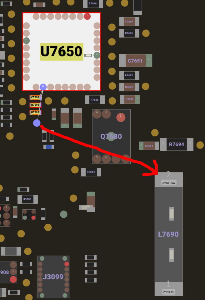

        Remove all power. Meter in resistance mode.
        Confirm that the following traces are reaching the inductor used for the same power rail:
        CSP2
        CSN2
        Place one meter probe directly onto the regulator chip pin (U7650); other onto the inductor @ L7690.
        The pulsing of the enable means the logic board is attempting to power this rail on.

          I'm not sure if I understood you 100% correctly because I cant find CSN2 in flexbv, but I attached a picture which measurement I did.
          Result : 10 Ω

            CSN2 is pin #17 on the same charger IC.
            Configure your meter to the lowest resistance mode. Touch the meter probes and report the measurement. This measurement should be ~0 ohms or the lowest resistance that is measured when you touch the meter probes together. Respectively, the measurement from pin # 18 on the ISL chip to pin # 2 of the inductor should also be ~0 ohms (not 10R = 10 ohms).

              I did check the meter and it has 0.1R. I even grabbed another meter to verify, which has 0.3R , and with both I'm now getting 0R between Pin 17 (U7650) and Pin 2 of the Inductor, however between Pin 18 of the U7650 and Pin 2 of the inductor I'm now getting 1.567kΩ with both meters.
              I dunno how that 10R Measurement came to be, I probably must have made a mistake but I double checked now both measurements with both my meters.
              • thecookie17
                • Feb 2025
                • 13
                I just figured out that Pin 18 is connected to Pin 17 (and thus Pin 2 of the inductor) over R7693, so that 1.576kΩ measurement could be plausible depending on the value of R7693
                PS: Please correct me if I'm seeing this wrong
                • mon2
                  • Dec 2019
                  • 14509
                  Correct. The 2 resistors are effectively in parallel with a resistance of 3k16 each so your measured value is now correct.

                      My correction - Trace one leg and it will be 0 ohms in the path. This should be pin # 17 on IC to pin # 1 or # 2 on the inductor @ L7690.
                      When using pin # 18 on the IC to pin # 2 or pin # 1 on the inductor @ L7690 - the total resistance will the parallel effect of R7693 & R7692 = ~ 1k567. The inductor will have a resistance but very close to 0 ohms since this is effectively a wire around a bobbin which we are ignoring.

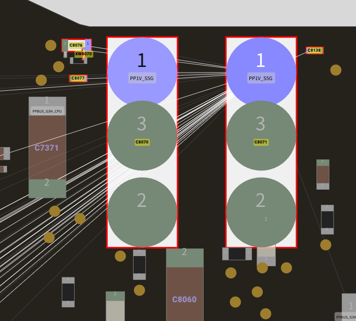

                                I just checked for a short on PP1V_S5, and what do you know, 0 Ω
                                I measured from Pin 1 of those capacitors to ground, that should be PP1V_S5G if i'm not mistaken.

                                  Yes. This may be bad news as this rail is linked to the CPU / PCH = both on the same die. At this time, suggest to inject 0v8 to 1v0 (not higher) onto the same rail you are measuring @ 0v. Then remove the heatsink on the CPU and check who is heating up.
                                  While the CPU / PCH will have a low resistance to ground even if ok but it should not be at 0R. That is a dead short. Perhaps we are lucky and it will be one of the caps you are probing Can only tell with the voltage injection. Keep the voltage at 1v or lower & the highest current your power supply can support. This will make the shorted part heat up and crack under pressure..like a police interrogation.

                                    I did remove L8060 and it shows 0Ω on Pin 2, and the guy over at the other forums said it was likely 99% CPU, should I still bother injecting voltage?

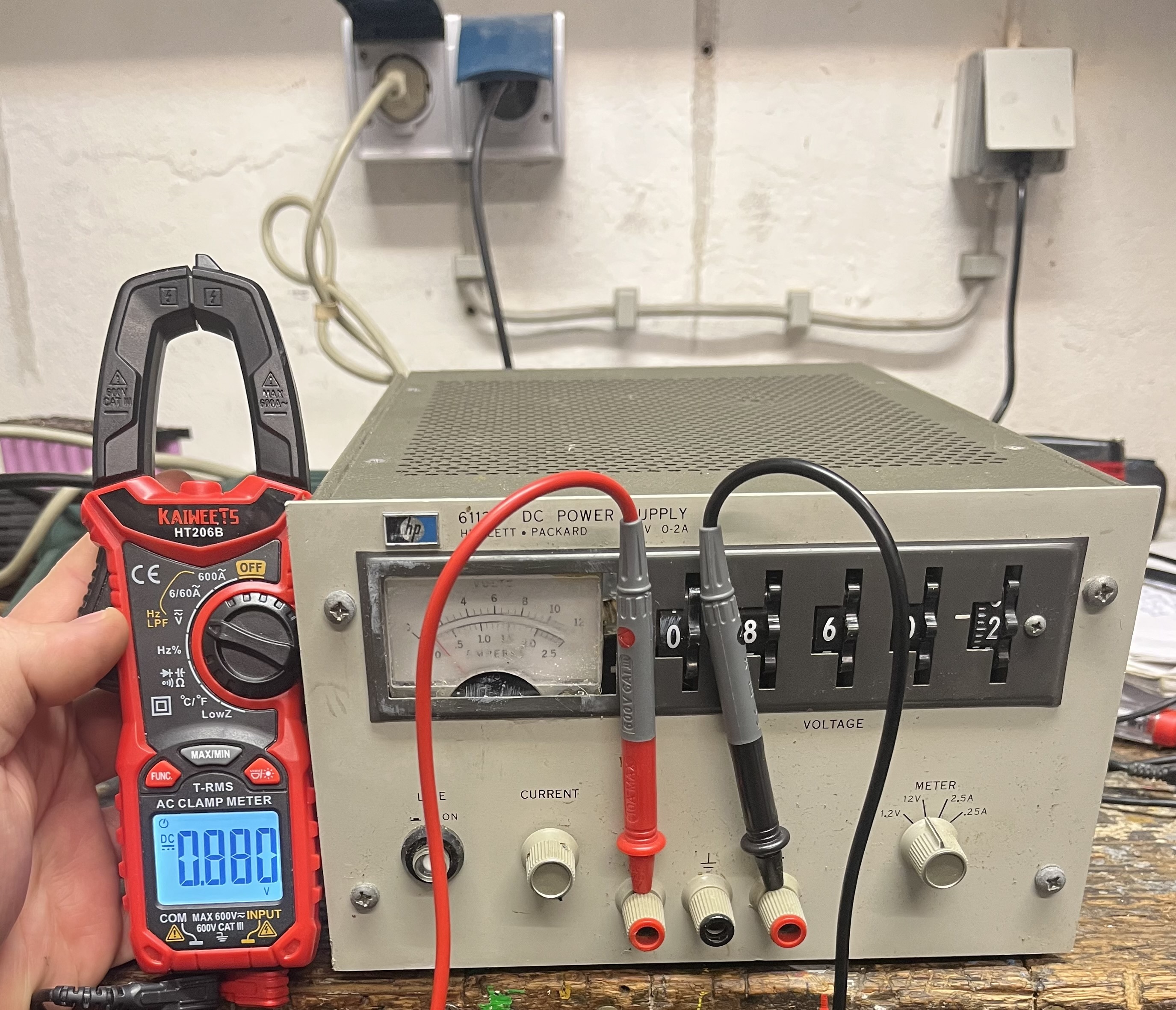

                                    I don't have a good lab bench psu right now I'd have to get one but if it'd be worth trying i would do that.
                                    • thecookie17
                                      • Feb 2025
                                      • 13
                                      Wait.. actually I remembered I picked such a power supply out of the trash once. Seems to work okay, i can dial in 0.8V. It can only supply 2A however; that would be only 1.6 Watts, would that be enough?
