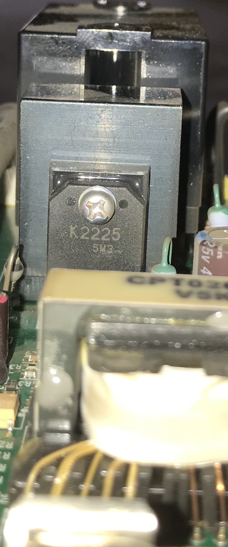

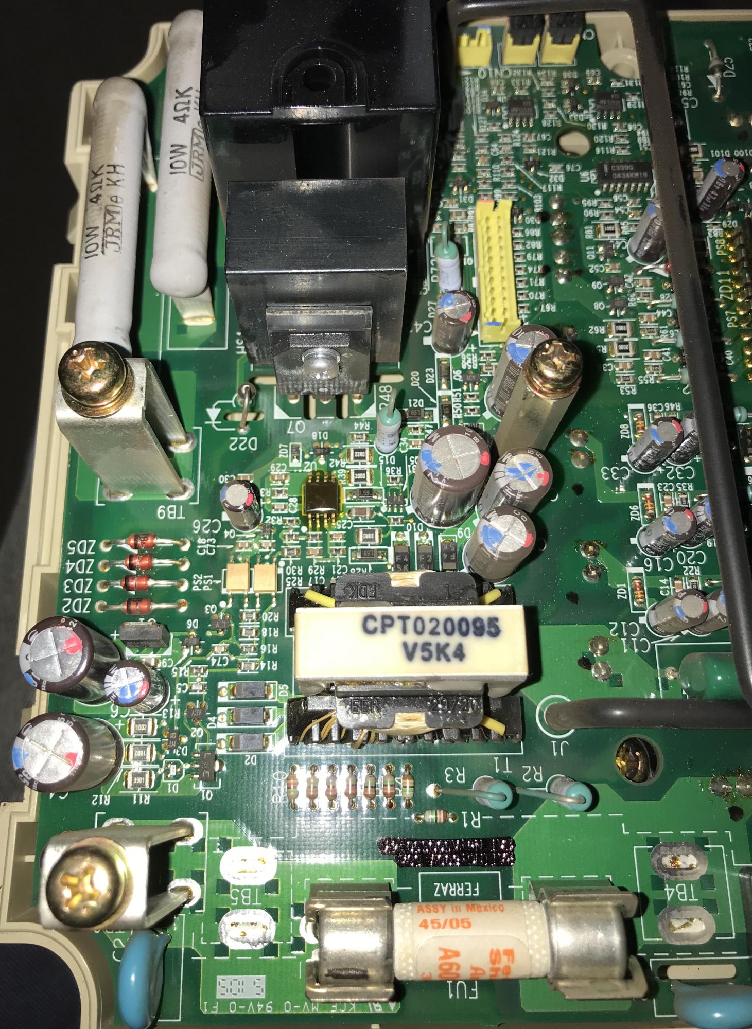

                            Here are some pictures of the drive that just took a crap the one that would not power ON
                            One note
                            The switching power supply regulator has some kind of epoxy resin on it so you can not read the IC chip number
                            Also there is a 30 amp fuse in it that is not blown
