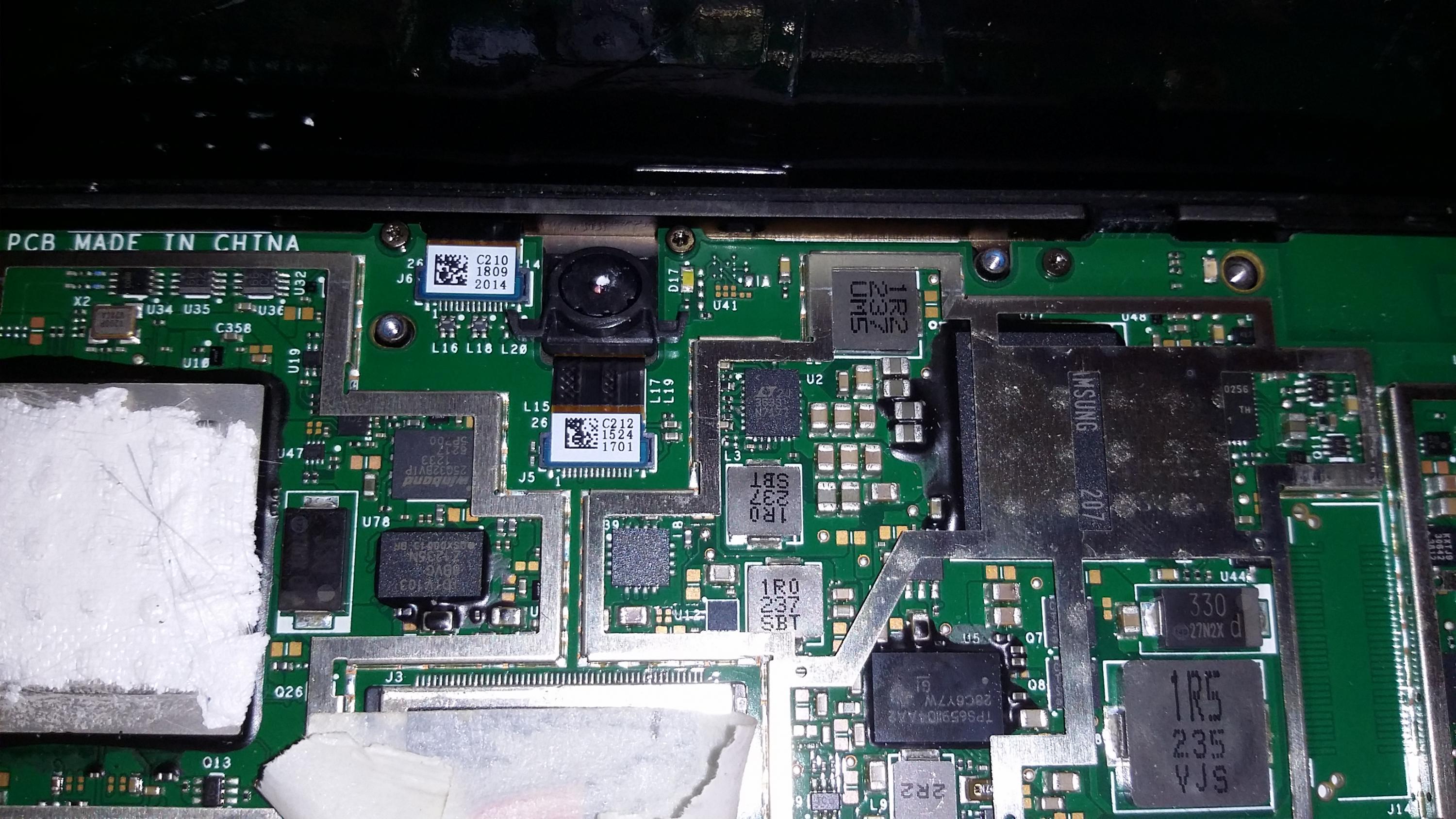

    trying to bring life back to a tablet. Without a schematic, its a tough slog. Anyway, can some one help me and tell me what these "larger" smd package components are and what the markings means.
    In the picture, they are 1r0 237 sbt, 1r2 237 um5, 1r5 235 vjs. Most seem associated with the powering domain.
    My guess is some form of resistor but they don't seem to measure out correctly as a "plain resistor"
    Thanks for your guidance.

    Re: Help: what are these SMD package components?
    They are power inductors, (coils) 1µH and 1.5µH
        Those inductors are for the SMPS, I.E. U2 LT3633: https://www.analog.com/en/products/l...oduct-overview
        You can look up the spec sheet of other ICs then you can start checking Voltages
          The other numbers are very likely date codes

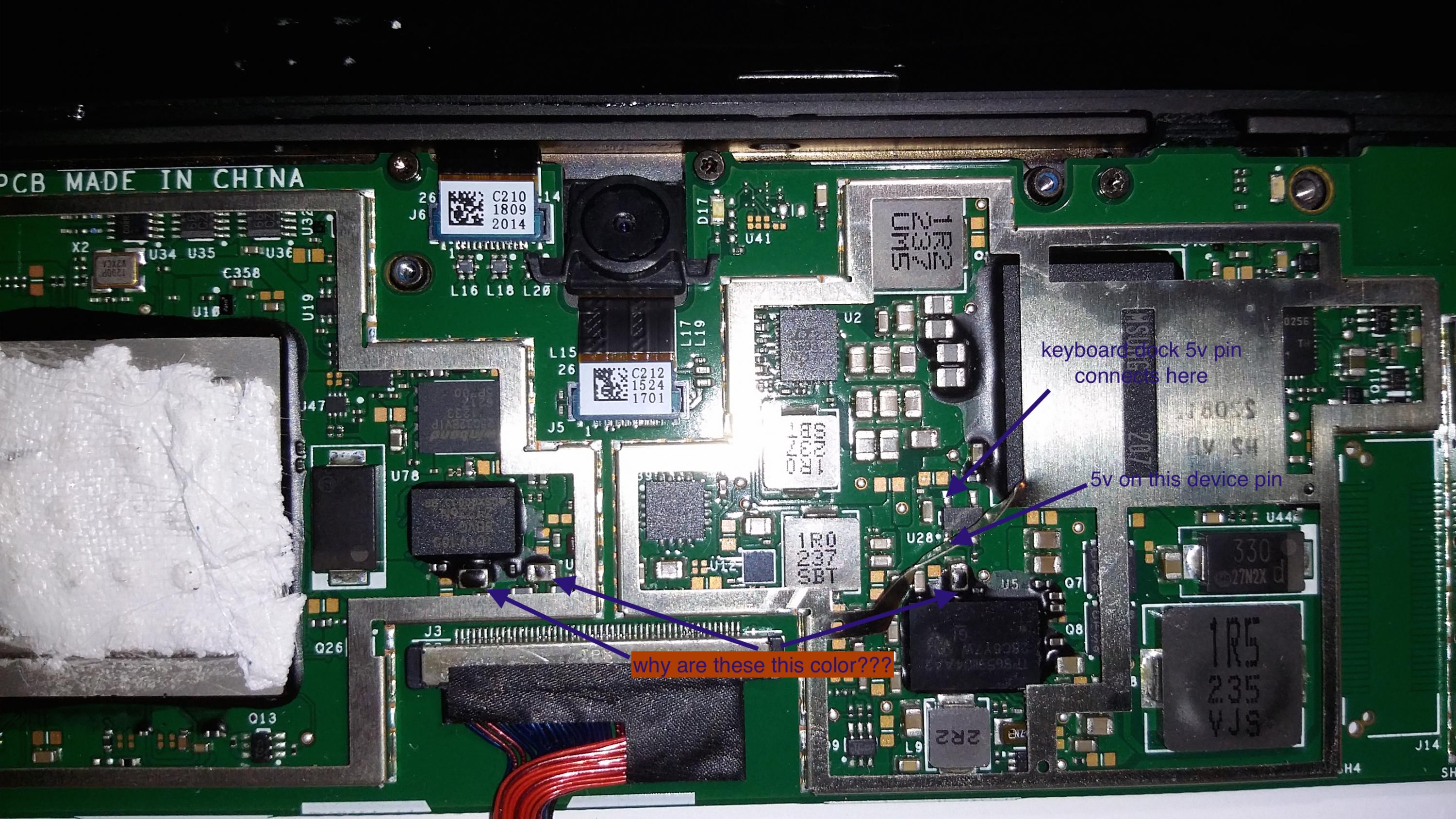

                        sorry if I am dragging this thread around. Some of the questions are about devices but I understand that it is maybe running into specific trouble shooting. I do appreciate the great guidance.
                        Attached is a picture of the power management area.
                        There are some smd components that have like a "black paint / dot" on them... are they bad components (ie. burnt / burning) or are those some form of designation?
                        Further, in the picture, I traced the 5v pin from the cover dock usb pin (which never gets 5v) back to the area with the 5 pin device. One leg of that device has 5v volts on it but it appears that device never gets activated. Anyone know what it is... its label is UFC0E. There is the same device in the circuit at the usb port area.
                          The ic labeled UF is likely a LDO, could be a AX6608-2.5V If pin #3 is not enabled, the output will be 0v.
                          That MSGD could be a gyro sensor ic
                          The black paint dot could be just glue for a component that was not fitted, they put down glue dots, then the component gets placed on the glue before it gets soldered

                            OK... I guess I need to trace that enable.... got a feeling it will end up near / in the TI power management chip / ic.
                            Learning lots, great hints..... but not sure I (we) can save this unit. It might be deeper than a "non-schematic troubleshoot" can achieve but you never know unless you keep trying... :-)
                            • budwich
                              • Jul 2015
                              • 3097
                              looked at the spec for an ax6608 with the 5 pin package.... could be a similar device maybe.... BUT I never see any voltage on any of the pins in question. Basically only voltage present is on "pin 1". This is on both devices in the two areas. :-( Haven't been able to trace the pin 3 track to anything yet (via a meter)... I haven't removed the board to look at the back side to see if visually can follow tracking.
