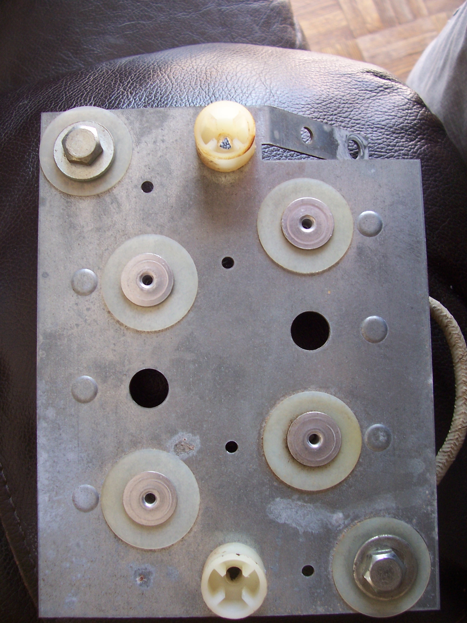

Help idinifying circuit from Battery Charger
  • davg
    • Sep 2008
    • 536

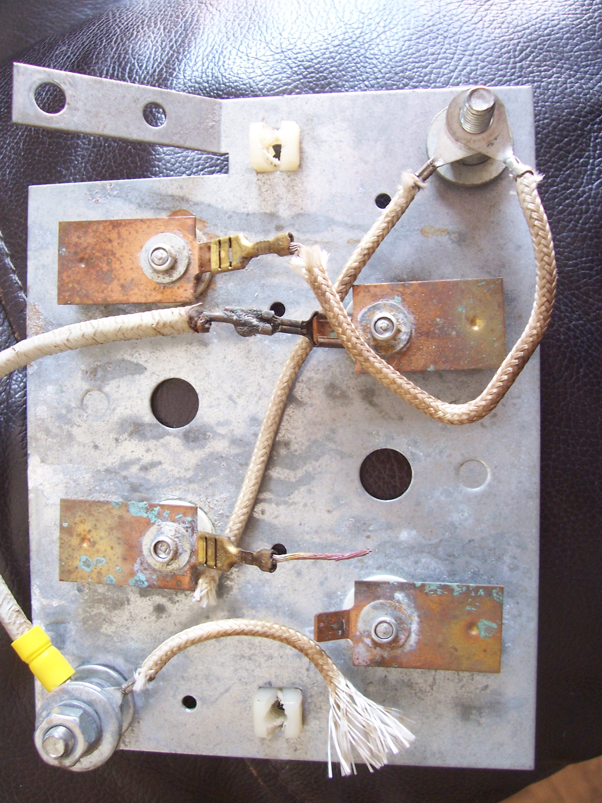

    The photo is of a circuit in an older car Battery Charger. I was wondering if someone on here could identify this circuit and explain it's function and how it works. It seems to be a very simple circuit to convert AC power to DC power. The two leads from the Transformer connects to the two terminals

    Re: Help idinifying circuit from Battery Charger

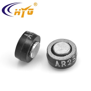

    There should be button diodes mounted under each of the brass tabs. 4 diodes making up the bridge rectifier.
    The diodes are likely similar to ar504

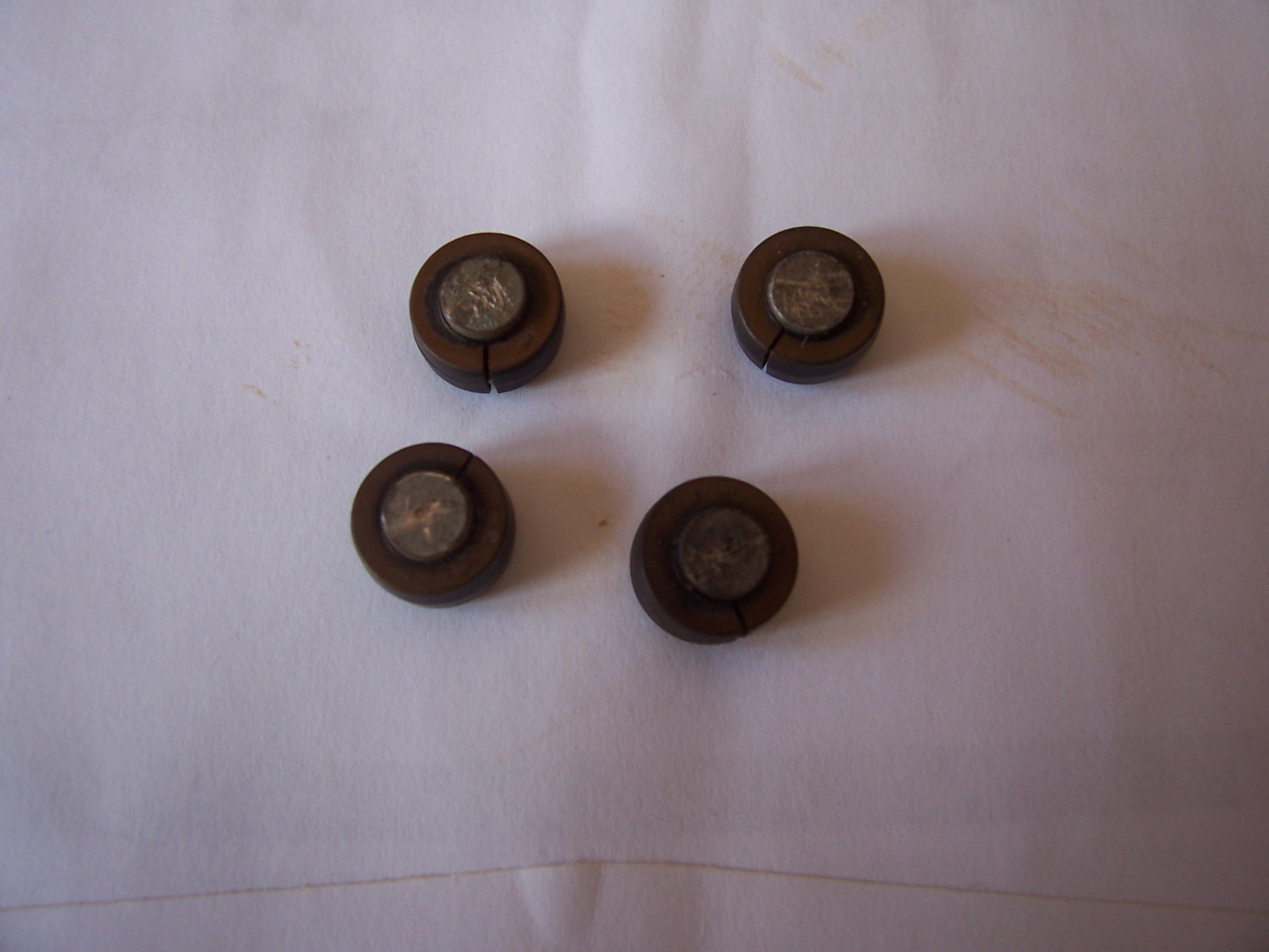

      What should these diodes look like? there is something under these tabs that look like doughnuts?? Can I use a bridge rectifier as shown below to replace that circuit?
        Tks again R_J yes there are?? first time a have seen a diode looking like that?? The circuit seem to be shorted is there a way to test these diodes?
          Each diode can be tested with a multimeter and diode test. What seems to be shorted? the diodes?
          It looks like all four diodes have a common point, the aluminum plate, so they could have 2 diodes in parallel

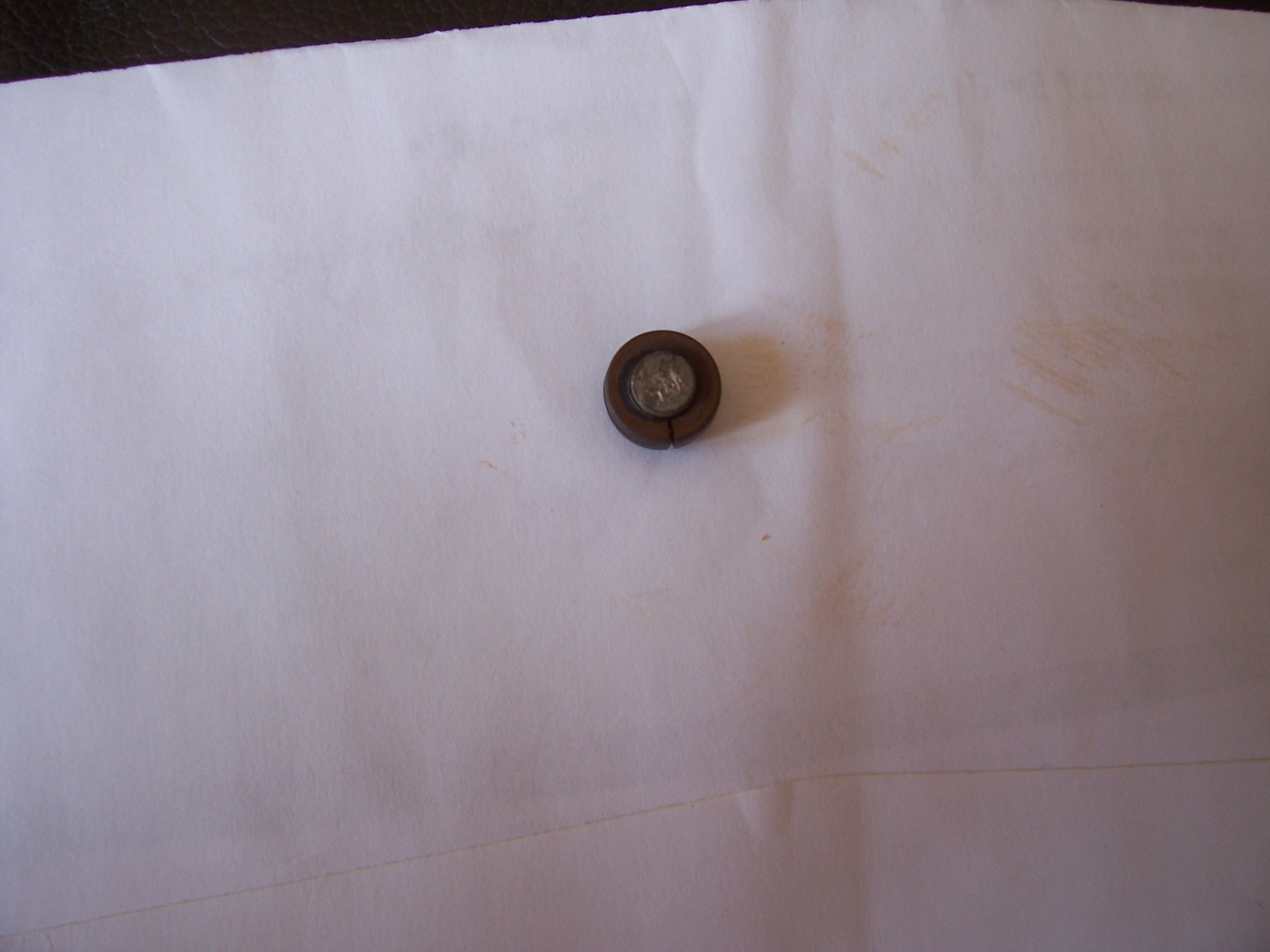

            All 4 of these has a slit in the outer casing which I assume is not normal. Testing with my meter in diode mode and leads end to end gives no reading and the same when I reverse the leads?
              I don't believe they should be split like that, what is the number on them? it should be marked on the side. I t could be the diodes have a high forward resistance so they could show open with a meter.

                No numbers visible on either of the 4?

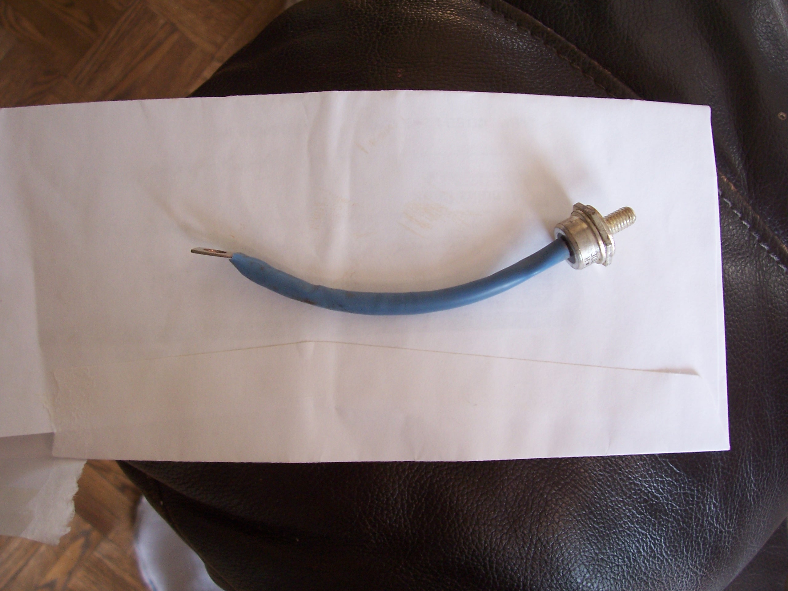

                  People sometimes replace them with 50 amp/400v D0-5 style stud mount diodes

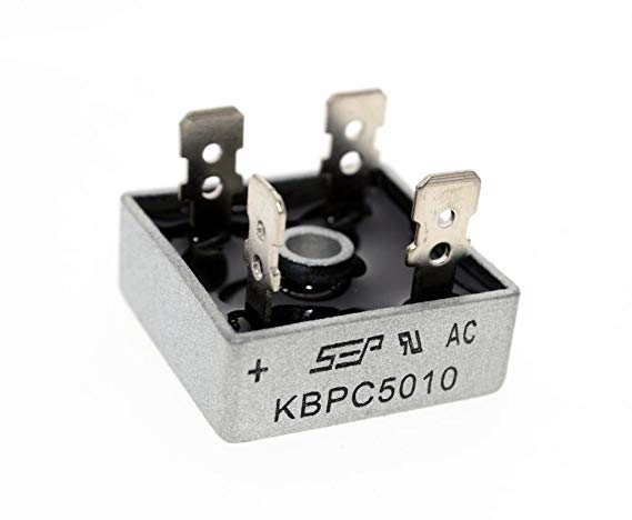

                    It looks like the charger manufacturer tried to copy a car alternator's construction with press-fit diodes. But the plastic washers are terrible for heat conduction and aluminum rivets on copper likes to corrode and the skinny wires have to go. Yuck.
                    I would change over to a bridge rectifier module like KBPC5010 50A 1000V $3.00
                    But the big problem really is heat sinking the diodes. Even if you put in huge expensive stud-mount diodes, that small plate just can't get rid of heat very well. I would beef up the heatsink.
                    How many amps is this charger rated? Does it have a fan?

                      I have a couple of these on hand #72HF80M would they do the job
                          Any diodes used need heat sinking for cooling. This is the hassle.
                          With a 15A load, each diode will dissipate about 7W of heat, roughly.
                          If you use a bridge rectifier module, then all the heat is concentrated in one square for 28W.
                          The VS-70HF is a large 70A 800V stud-mount diode, you would need four.
                          But the hassle is mounting them on the heatsink, the cathode is the bolt so two of the four diodes need insulators or the special version with reverse-polarity (anode to case). Insulators can't transfer the heat, so the diode cooks or the plastic melts and they aren't a great way to go.
                          Simplest fix I think is bolt a 25-50A bridge module on the heatsink, the modules are isolated case so no more hassles with shorts to the metal.
                          Rectifiers from a scrapped PC power supply could work. They are two Schottky's in a TO-220 case and a bit more voltage for the battery. What else you got in the junk box.
                            Yeah probably best not to use a bridge and use discrete diodes - the original design spread the diodes out away from each other for a reason.
                            and holy crap, seeing some china shops selling the button diodes for less than 10 cents a pop in 1000 quantities... wonder how bad they are?
