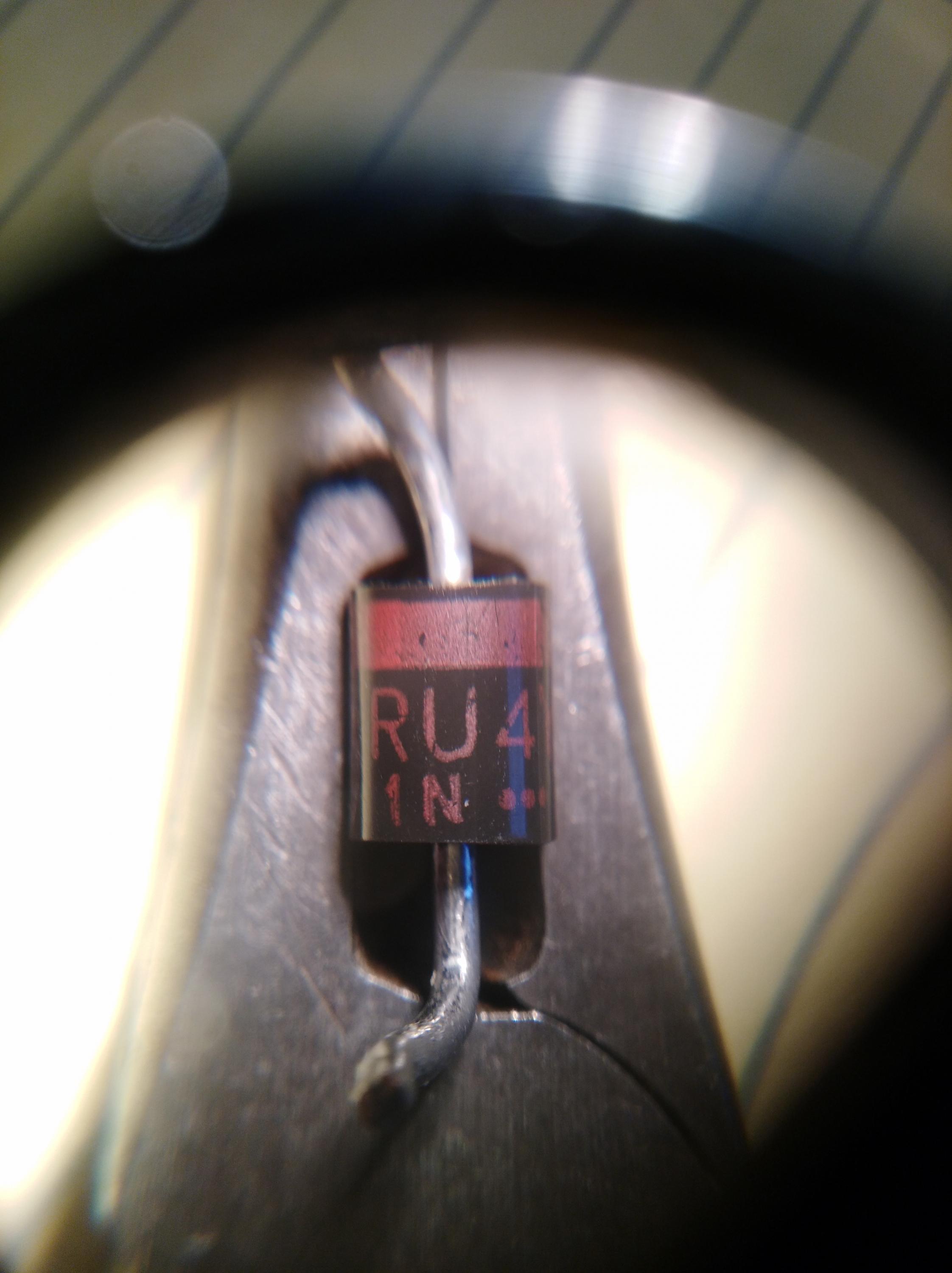

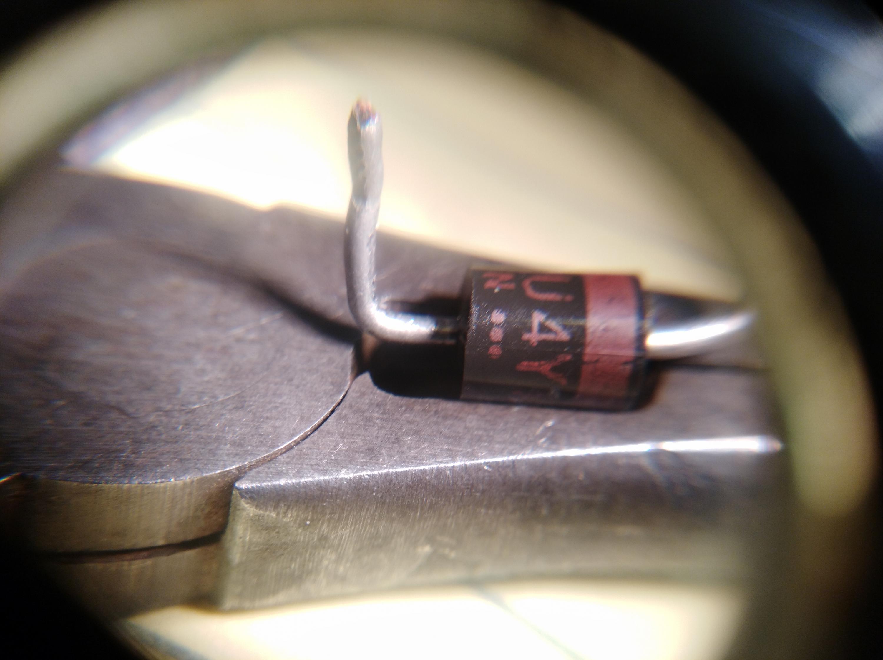

    Is this a diode?
    Is this a diode? Please see pics, identifier is RU4Y above a second line saying 1N, but I cannot identify. Can I use for a 1N5408? Thanks.

    https://cdn.badcaps-static.com/pdfs/...112ddc643d.pdf

      Re: Is this a diode?
      The RU4Y is a 2 amp 100volt fast recovery diode, The 1N5408 is a 3 amp 1000 volt standard diode
      The 1n5408 will likely not work in a switching power supply
        2A diodes are not popular, hard to find in North America. I would use UF5402 3A 200V fast recovery.
        1N540x is very slow diode.
          Standard recovery 1N540x would probably get toasted if a fast recovery type is necessary.
          On the other hand, a UF5402 is much faster than the original part, and might generate extra noise with its fast turn-on.
          A closer match would be an MR852. The MR850 series has been around a long time. As the part number suggests it was originally a Motorola part, among the many Mot sold to On Semi. I remember seeing MR85x parts in use as Boschert when I was there in the early 1980s.
