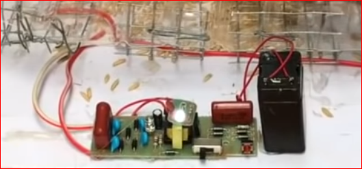

    Electric mouse/rat traps on youtube, and I was trying to figure out the power supply to buy one. There are loads of fake videos with 12V battery + 150uF 450V cap in parallel... the HV PSU is hidden.

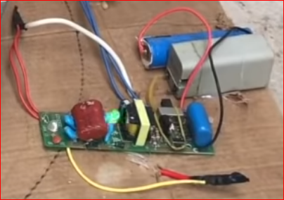

    I saw this PSU which has weird RGB led flashing and possibly a timer and shutoff. Closest I could get to it is a "DC-DC 3.7V Step-up to 1500V-2000V-1800V High Voltage Pulse" but it does not have the extra circuit (MCU?) seen in pics. I think a timer or something like a fencer is needed.

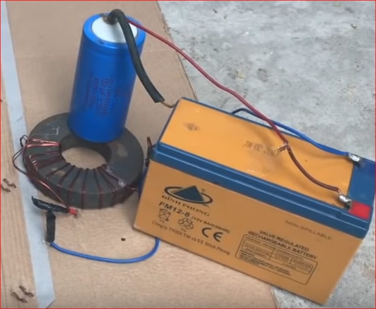

    Other youtube vids use a (hidden) boost converter with 10-150uF 450VDC cap charged up, across the electrodes.
    I was not interested in tasers because of the fire hazard with an arc and the stink.
    Anyone recognize the board or know the name for it?

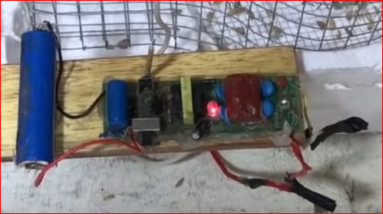

        What throws me off is the youtubers all hiding their power supply, to keep their fame and glory, and youtube's censorship of anything mean like an arc.
        The feet and tail seem to get the jolt. The critter collapses on the electrodes, then shorts out the PSU, so you'd need something to flip empty the board.
        Some guys use wire mesh spikes to get through the fur.
        I can't tell if 450VDC or 2kVAC is better.

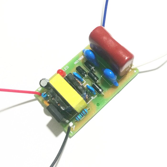

                  The little stun gun HV modules "1000KV" or "30KV" overheat and die if run for even 30 seconds. Or they arc over inside with no gap to limit.
                  They are all one-transistor saturated-core DC-DC with HV multiplier at the output, in other words big long arcs but little current. Igniter ones have lower V and higher (hotter) arc current. BigClive had some beers and tried touching one lol he swears pretty good.
                  It looks like I need something to sense mouse feet on an electrode, then turn on the HV power supply for ~15 seconds and then switch it off and keep it off if something is still on the electrode. The HV power supply would have to be OK with nothing there, and no arcs on the wood to burn down the building.

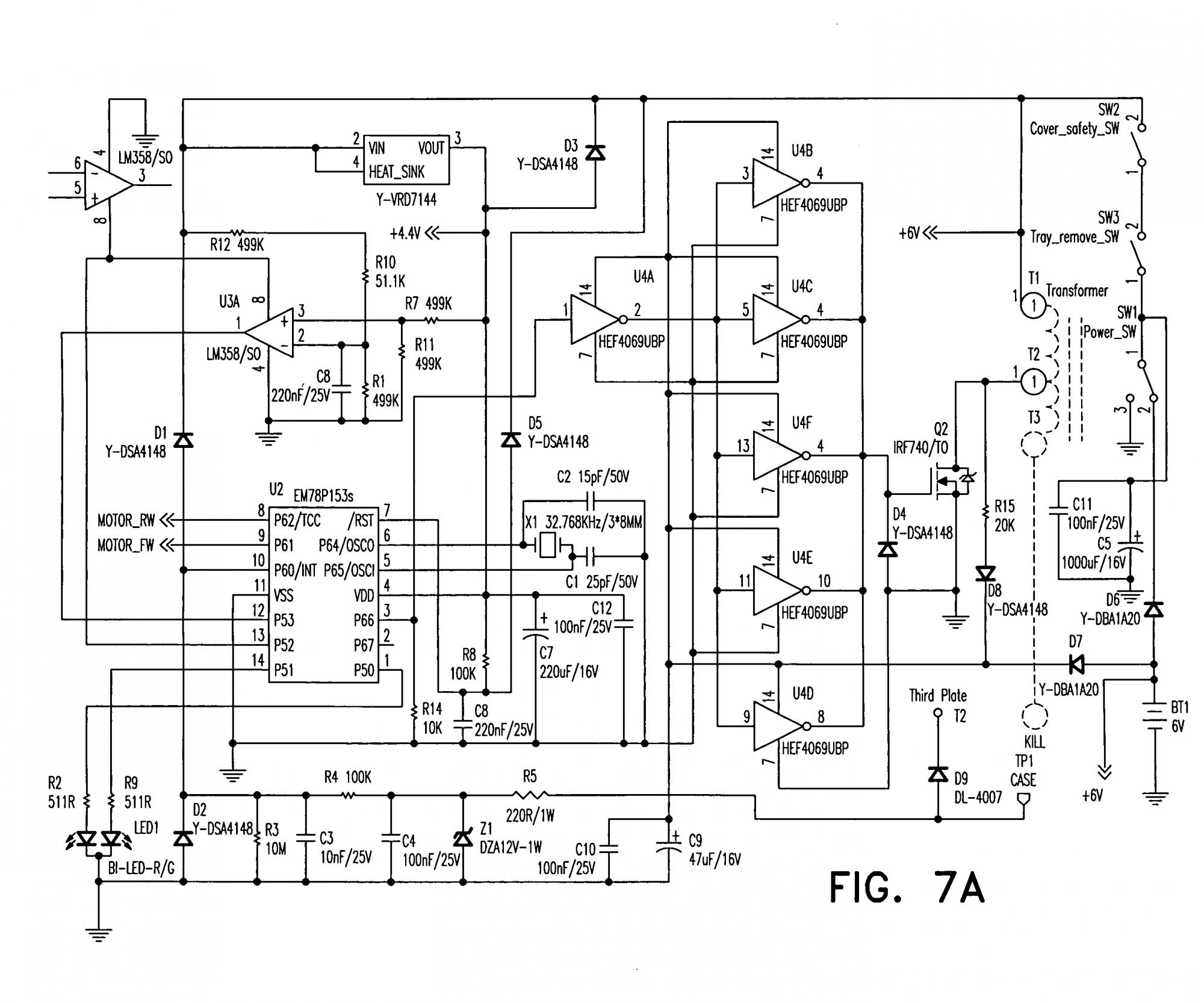

                            Couldn't find much for a decent teardown of the Victor.
                            Kept researching and found the patents for Woodstream Corp. that uses resistive sensing between electrodes, and here is the schematic they use.
                            "... Upon entry to the high output subsequence, step 530, the trap generates a high voltage killing cycle, step 532. According to a preferred embodiment, the high voltage cycle includes the generation of high voltage pulses having a peak magnitude of from about 4 kV to about 7 kV, and more preferably from about 6.5 kV to about 7 kV, and a duration of from about 23 usec to about 28 usec at intervals of about every 4.25 msec to about 4.5 msec for at least about 20 seconds. Upon completion of the killing cycle, the trap enters the check for kill subsequence, step 534.
                            Upon entry to the check for kill subsequence, step 540, the trap again checks to see whether there is an impedance between the killing plates in the range of about 10 k ohm to about 1M ohm, step 542. The absence of such an impedance indicates that the mouse escaped. In this event, the catch counter is checked to see whether it has a value greater than zero, step 544."
                              by sam_sam_sam
