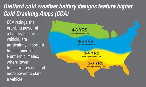

                      The norm, here, is 3-4 years for a battery -- regardless of "quality". The heat just cooks the sh*t out of them!
                      The optimal battery maintenance strategy (here) is to buy your first replacement from a place like Costco (inexpensive yet decent replacement warranty -- the non-prorated term is about 3 years) and then just bring it back to them at the end of the non-prorated period for a free replacement. They don't even bother testing the returned batteries as short-term failures are so common.
                      (A battery need not "fail" for it to be considered as defective in terms of bench testing)

                        I see temperature has a big effect on lifetime.
                        Johnson Controls revenues $6 billion for car batteries, 135 million made per year. They are pretty much the big dog making almost all car batteries, so I don't see a huge difference other than marketing hype between "brands".
                        Optima AGM spiral plates are 3X the price of a vanilla car battery and last 2-3X... so what's the point? Especially since Johnson Controls bought them out and destroyed the quality years ago.
