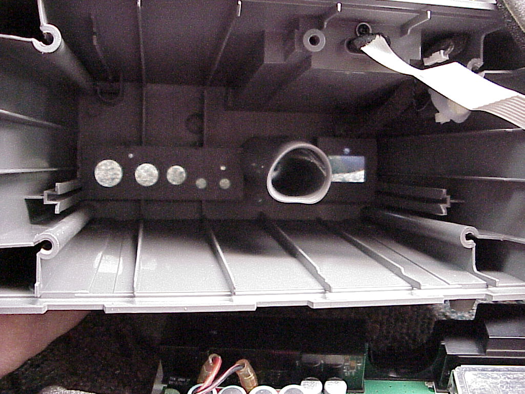

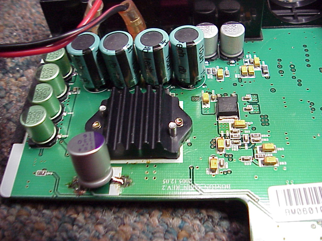

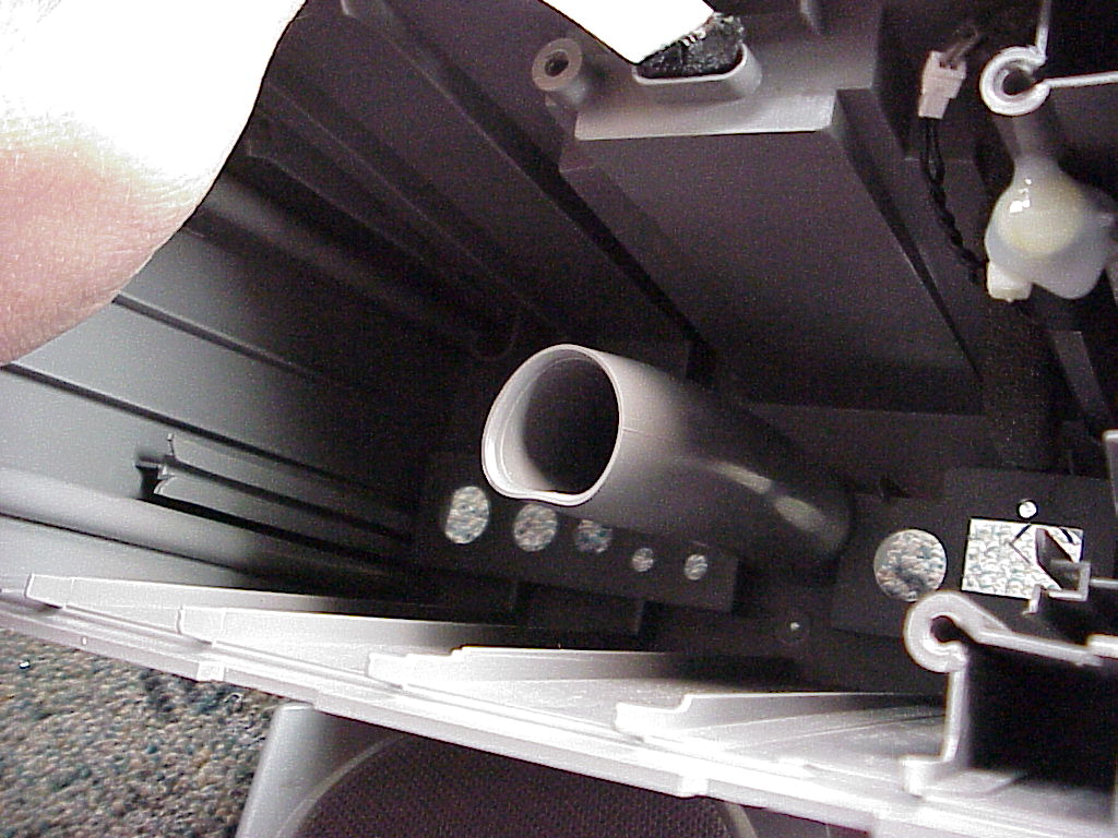

    boston receptor hd radio got very hot
    you know its too hot in there when the speaker port melts.
    a cap exploded near the audio output chip who's heatsink did not have a thermal pad.there was a gap between the heatsink and the chip.
    i used a poly to give it a better chance but its probably a waste as this model was beat performance wise by a 1941 zenith aa5!
