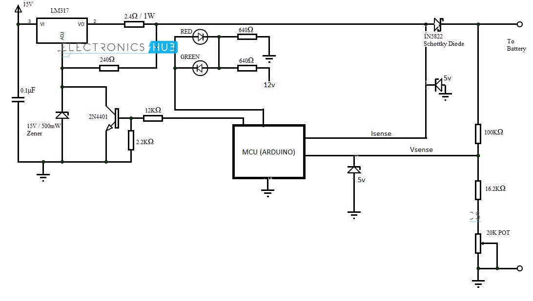

                    Another interesting one here (the second version). I could replace that 555 with the arduino used to run the alarm module, so I don't use two separate ones. Put all of this into a box, mount it on the wall somewhere and we're good to go....running wires for the sensors would be a bit of a chore, but hey, whatcha gonna do...
                    EDIT: had another look at that schematic and may have spotted a problem, though it's not mentioned, so perhaps I don't fully comprehend how it operates: when the LM317 is active, wouldn't the resistor divider on the right immediately detect the battery as being charged causing it to oscillate ON-OFF-ON-OFF very fast ? My idea is that when the battery is discharged, the circuit will begin charging it and as such apply voltage to the output terminal. This is connected to the resistor divider which would make it read the charge voltage and not the actual voltage in the battery, thus the circuit would turn off. As it does so, the "real" voltage appears again, triggers the circuit to charge and so on...could be a bad analysis though.
                    Second possible analysis of the issue: the LM317 is used as a constant current source and not a constant voltage source (it's more of a combination of both in fact), so it slowly ramps up its output based on the current drawn by the battery (due to that sense resistor on its OUT pin), which would make more sense in conjunction with that voltage divider because it doesn't always output 14v or whatever, but slowly "gets there" when the battery no longer draws current through the current sense resistor.

                          Here's what I had in mind: I adapted the example diagram....I spent all 5 minutes doodling in MS Paint so it's going to be brilliant Didn't really think it through: just threw together some lines and replaced most of the passive components with the arduino.
                          The way I see it on paper: we need some sort of voltage reading, so the resistor divider on the right was given to us right off the bat and should stay in the circuit AFAIK. We can use that to "measure" the voltage with our arduino to cut off the charging when it's reached 13.5v or something, which is where the next part comes in: in "charge mode", 2n4401 is "open" and not acting on ADJ pin in any way, so the LM317 does its magic and charges in constant current in conjunction with the current sense resistor (typical application AFAIK). The arduino then turns on 2n4401 and pulls the ADJ pin to GND, bringing down the output to 1.25v or something like that. I threw an extra "Isense" line on there for no real reason...I just realised.
                          ...as I'm writing this, I'm starting to notice that the arduino is probably superfluous for this application, which could be pulled off with discrete components to measure a goddamn battery

                            You will need more than 15V feeding the circuit.
                            https://cdn.badcaps-static.com/pdfs/...3ef99622bc.pdf
                            What is the purpose of 15V Zener?

                              According to the original schematic (since I didn't alter that portion) it prevents the LM317 from exceeding 15v.
                                Discrete components don't have (significant) memory. You will find that your circuit "works" -- with a new battery; then fails miserably as the battery ages or develops faults.
                                Of course, if you don't really CARE about how well the backup is performing, then these won't be issues for you!
