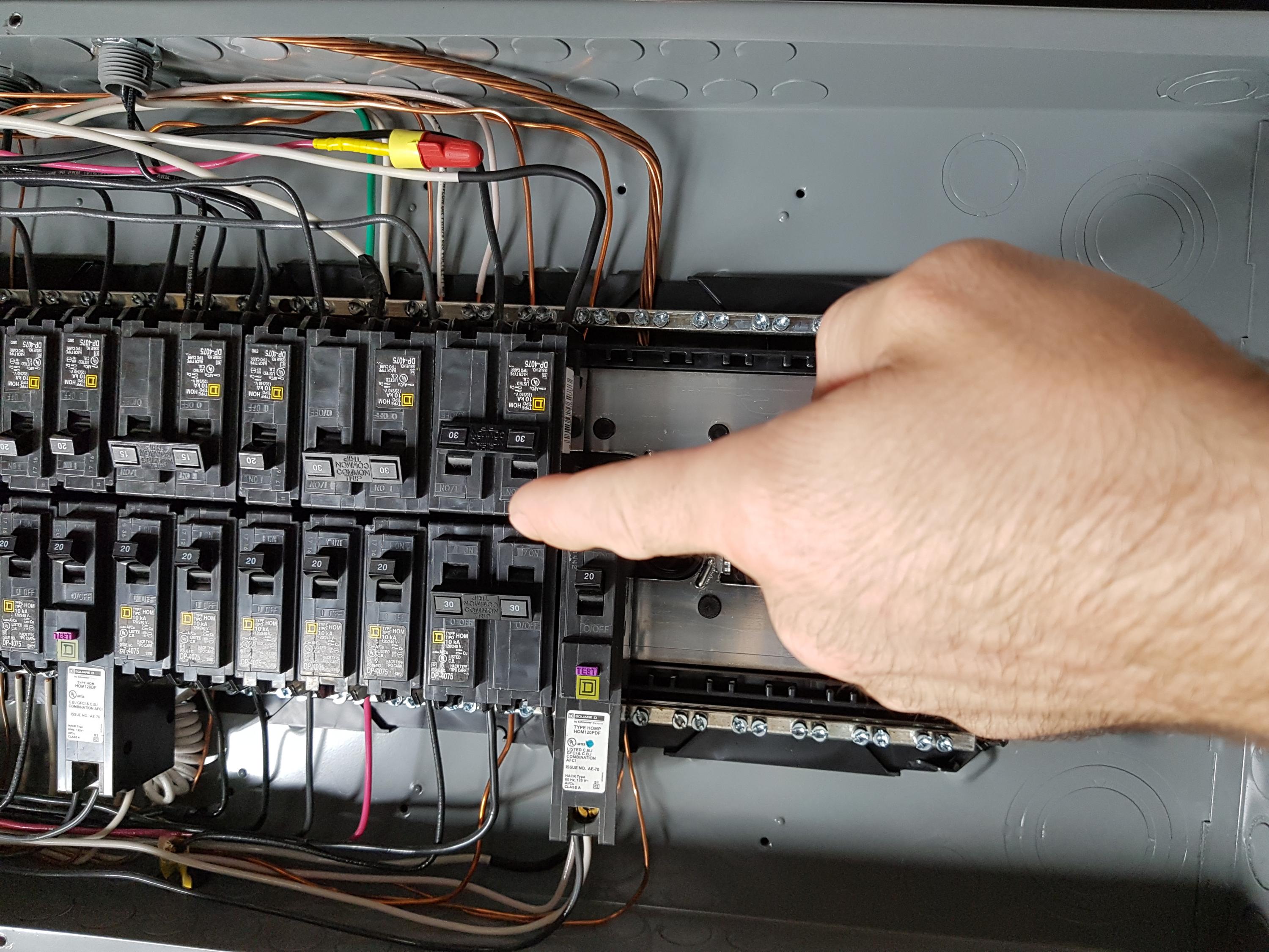

                Re: Possible ground loop
                draw a wiring schematic, i cant follow this.
                  Is ground loop causing problem in your setup right now?

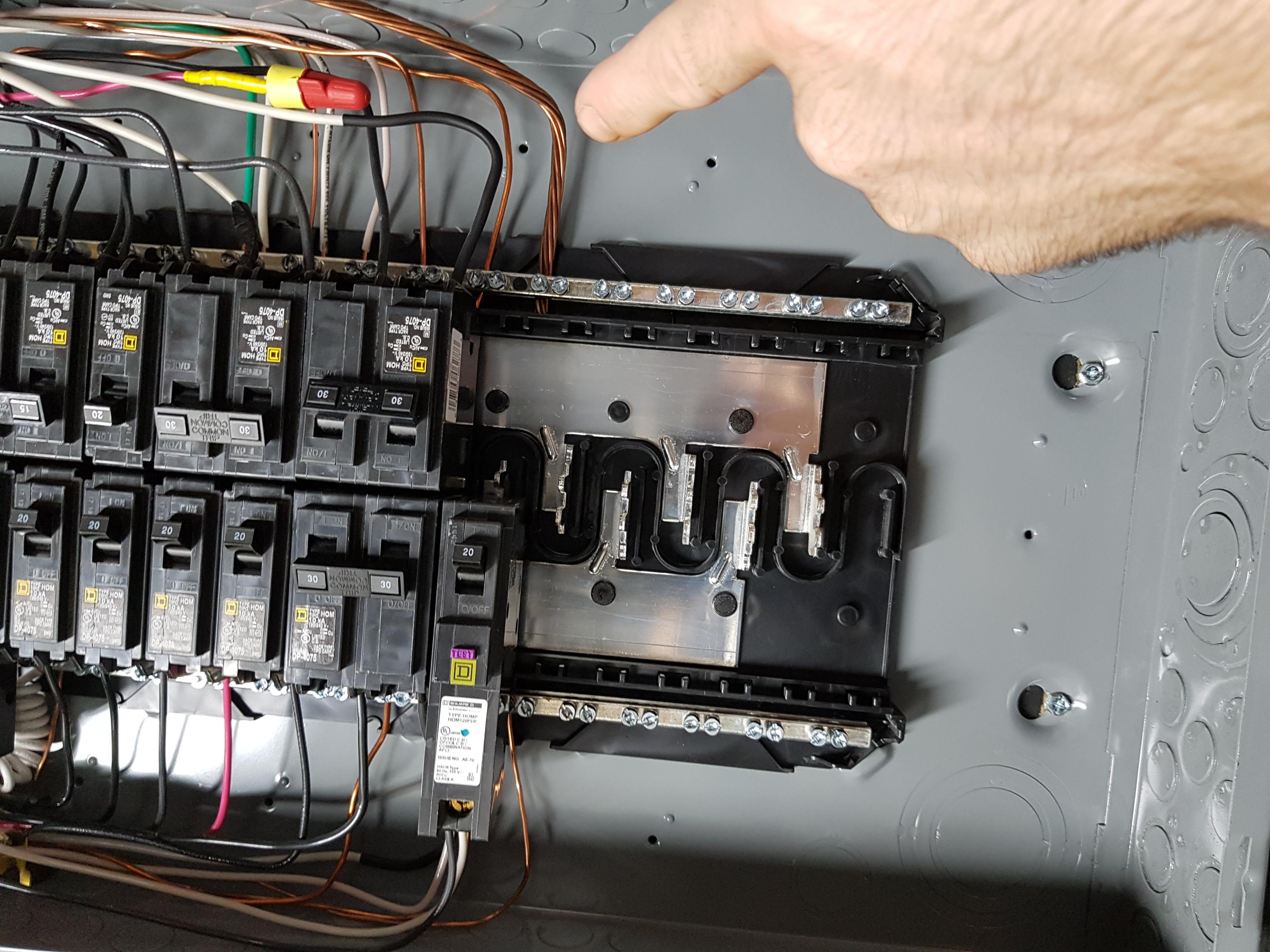

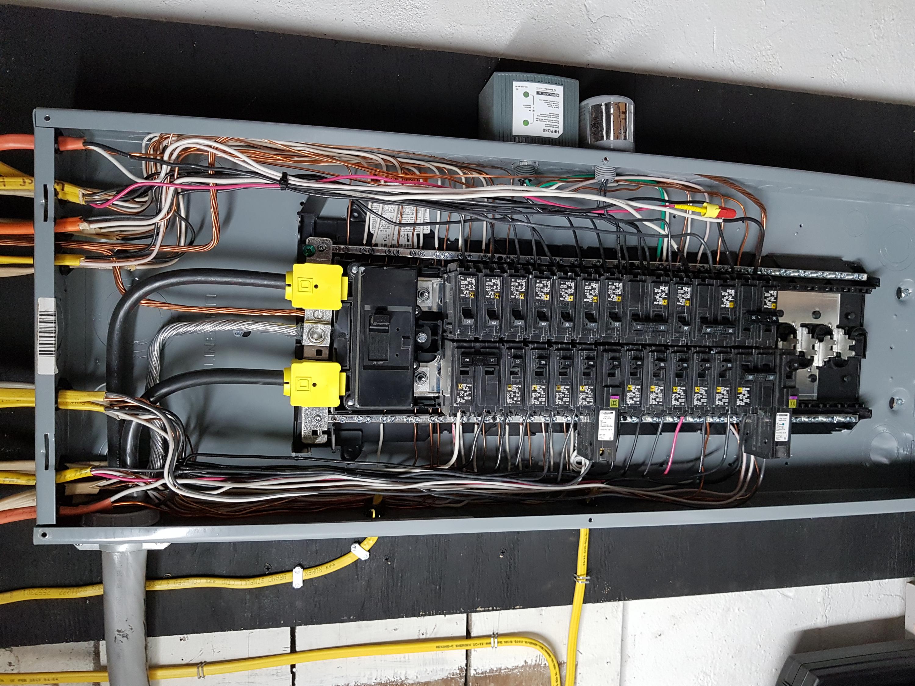

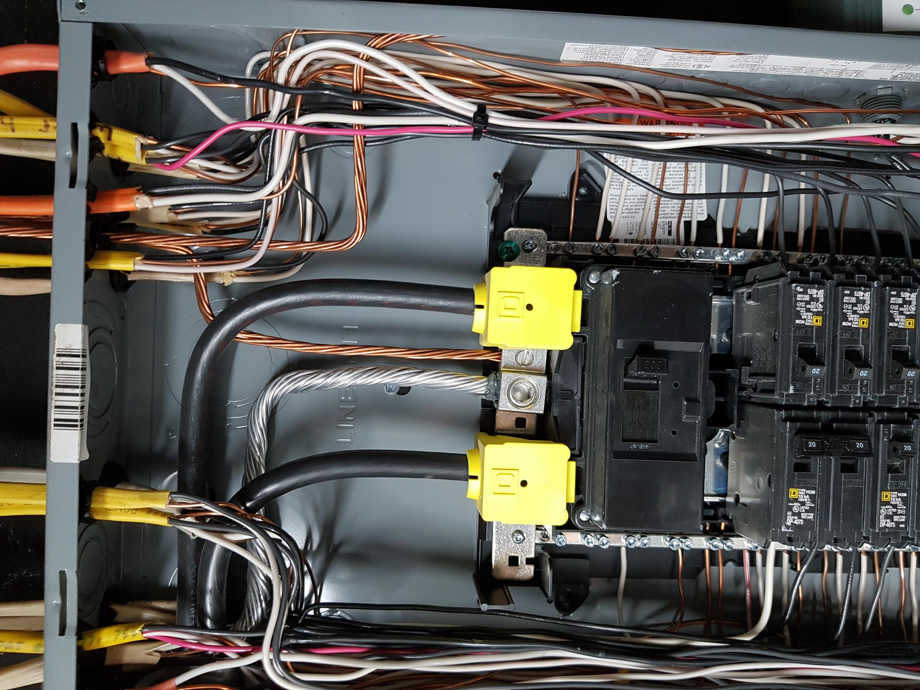

                        Here's some pics of the panel.
                        Phone took the pics sideways for some reason. The first shows how the Neutral and gnd are hooked up to the panel. Second shows how the electrician ran the earth gnd to another point on the panel. The bare copper that's buried goes into the panel at the top, where the Neutral is hooked. The bare gnd that runs through the basement that everything is bonded to goes to the bottom the gnd buss bar. The gnd and neutral buss bars are connected at the top with a bar. The bar came with the panel. The conduit I ran is the cantex schedule 40 rigid PVC.

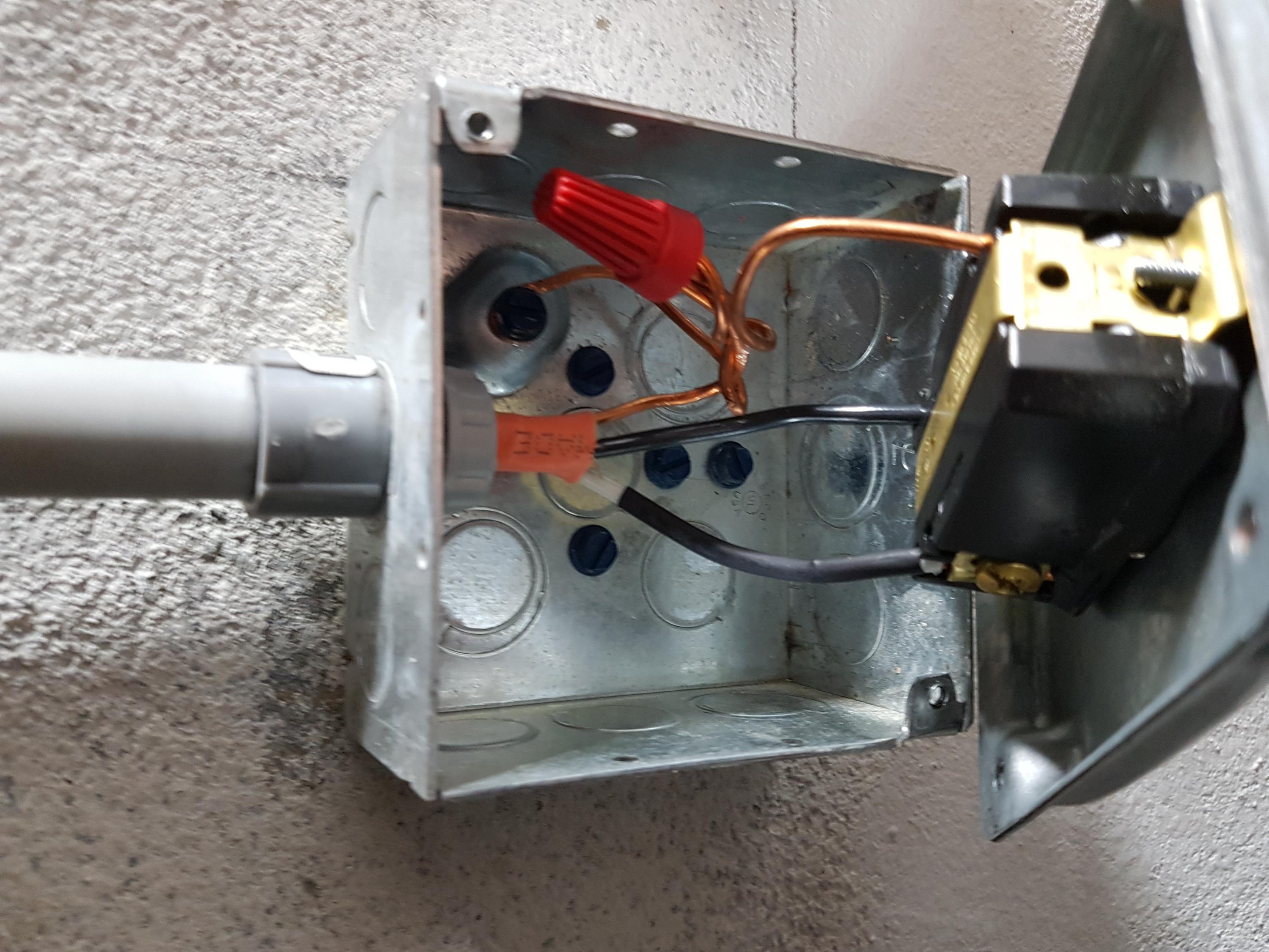

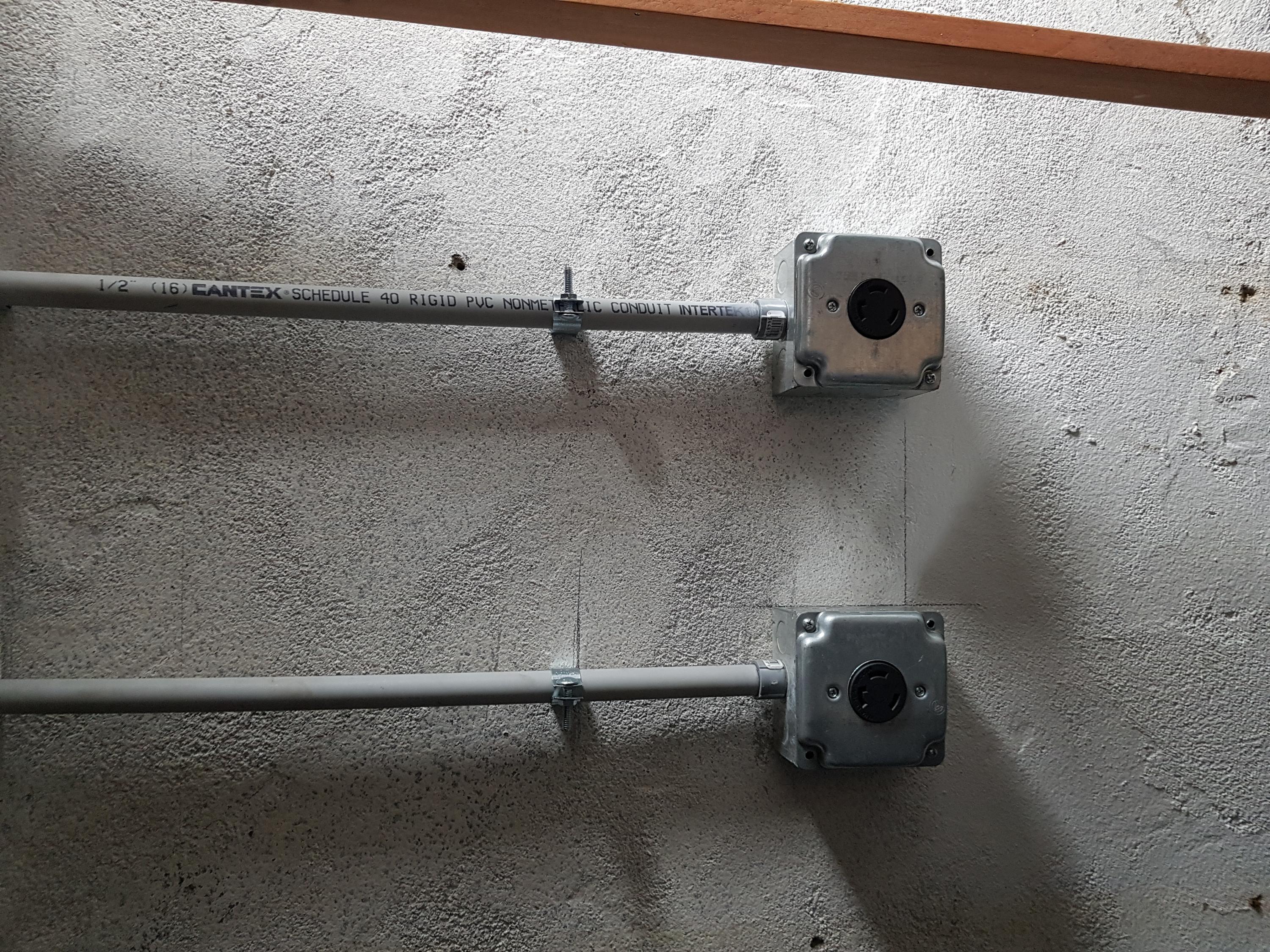

                          Here's a pic of the two 240VAC receptacles that I installed myself. They run to dual pole breakers installed on opposite sides of the panel.
                          There's also a pic of one of the boxes with the cover removed, so you guys can see how I did the pigtail. I did this so if one of the supply lines ever came free, God forbid, and touched the metal box, it should trip the breaker, rather than energizing it so if someone touched it, they shouldn't get shocked.
                          What really surprised me, my neighbor who works for a company that installs junction boxes all the time, never heard of grounding those boxes like that, and doesn't understand why it needs to be grounded.
                              unshiethed earth wires - yuk.
                              what's the gray paste-shit on the incoming N wire?
                                That electrical box is grounded when the face plate is bolted to the box since the outlet GND makes contact with the face plate via the brass strap on the back of the outlet.
                                https://www.ecmweb.com/qampa/code-qa...-conductor-box
                                  as long as the screws are all good, but if the center ones fail the assembly will be floating inside.
                                    Yep, this why it is better to ground the box instead of relying on the contact between the outlet GND and the face plate to the metal box. I always GND my outlet box with GND wire just in case.
                                      yes, i was wondering why there is a wire-twist instead of putting the incoming and box earths into the socket terminal.
                                        That's what I did. It wasn't too long ago that we found a light switch that failed. It literally was broken in half.
                                        I do not mind spending the extra couple mins to run a pig tail for extra safety. I don't know if it's required by code, but it always feels like it's the right way to do it...
