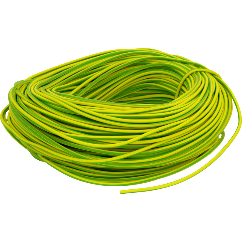

      Re: Possible ground loop
      can you not get earth wire sleeving ?
      example
          example
          In this area, I've only ever seen the bare copper wire being used. Various companies all carry these blocks that attach directly to the bare wire, so it might be a local code or something?
            some electricians here use bare earth wire . i follow them round and add sleeving . not really necessary unless close to live wires to cause arcs or dead short like we had here . the earth rod was smoking
              • 31285
              wrong, sleeving is mandated by the 17th edition of the codes.
              it's strict on the colours too.

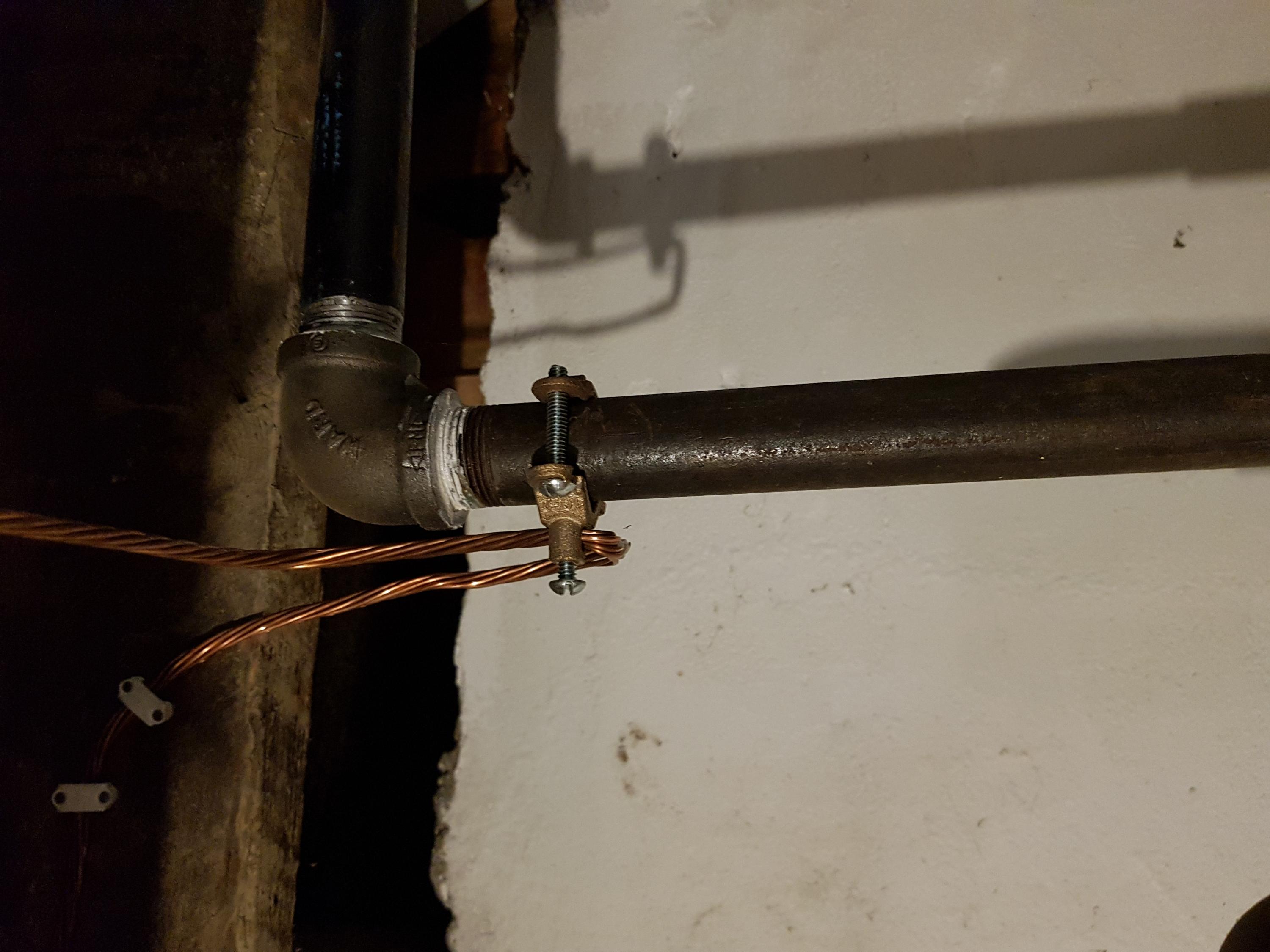

                      #30
                      can you explain the incoming supply ? or draw a diagram . trying to get a handle on this .
                      for example we have high voltage transformer up a pole that supplies single phase 240v . terra terra system .. dead easy if working from same main panel . only ground loops caused from more than one unit unit connected to supply earth .

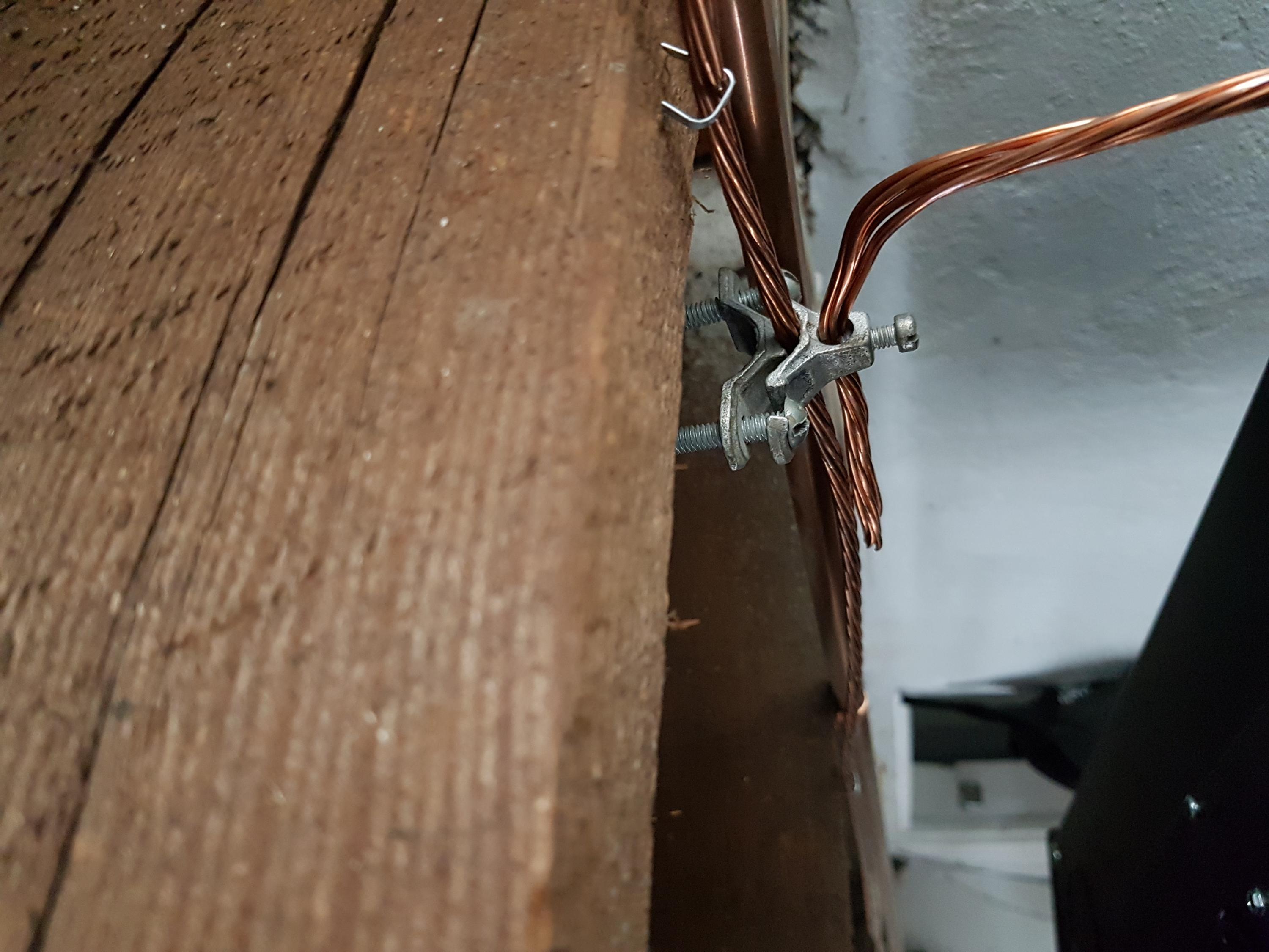

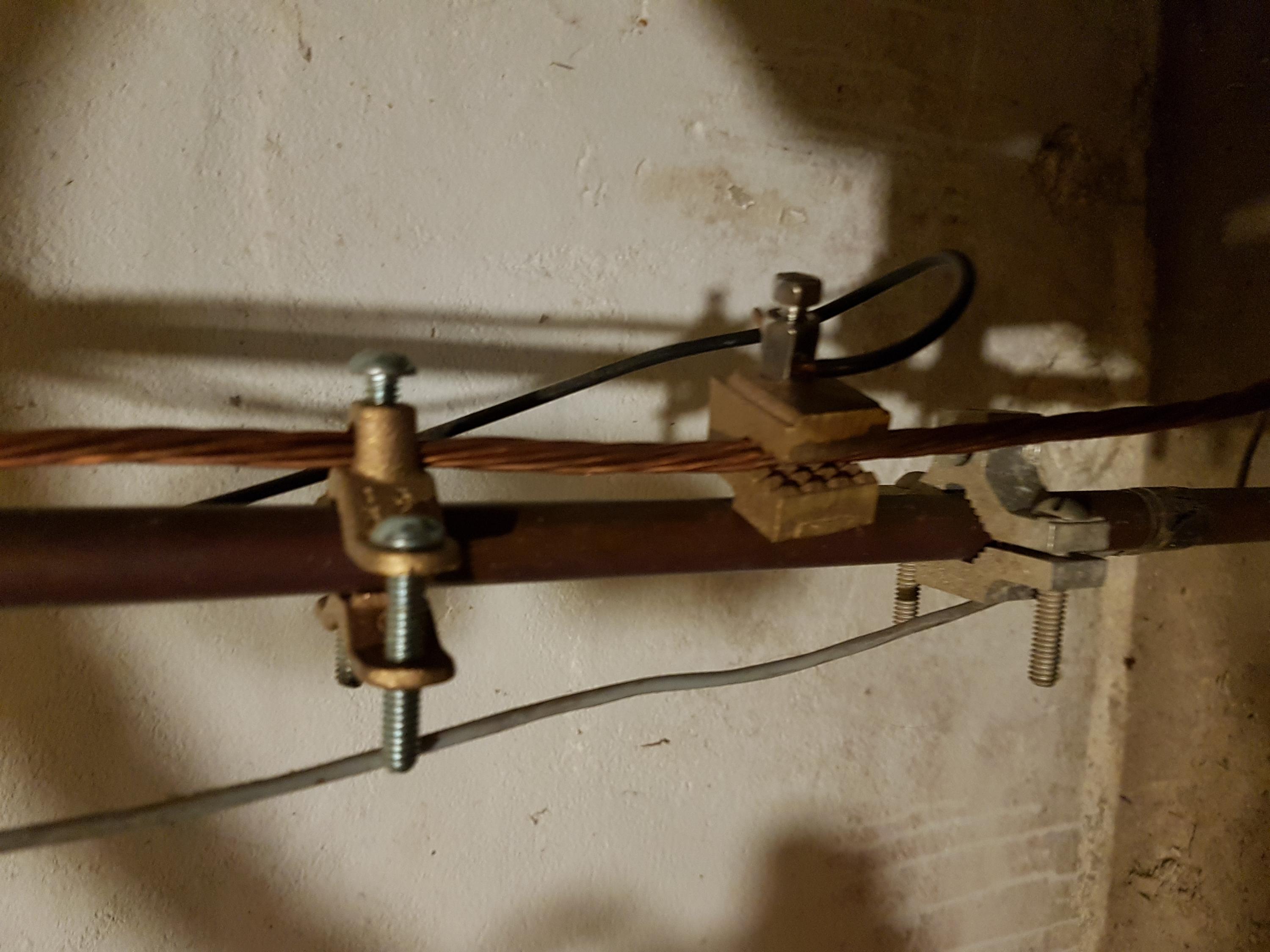

                          #32
                          Yes sir, to the best of my ability. I believe we have a transformer at that pole that receives 240VAC and supplies two 120VAC lines plus a neutral to the house breaker. I believe it's called centre tapped.
                          On the panel, every other breaker is on one of the 120VAC lines. So we install a dual pole breaker, we're getting 120VAC from one incoming line, another 120VAC from the other incoming line, 180 degrees apart, giving us 240VAC.
                          On the panel is two bare copper lines, 4 gauge, stranded. One them runs throughout the basement and the various utilities get bonded to this line. It ties in right next to where the neutral from the pole ties into. One the GND buss bar is where the other 4 gauge stranded wire hooks up. It's a shorter run and goes out to my side yard, where it's buried and attached to a rod (I believe).
                          This is now why I don't think I have a ground loop at all. Even though both receptacles are ran seperately to the breaker panel, they're still sharing the same earth connection.
                          Originally, I thought the electrician ran two earth connections to the panel, because of the two bare copper 4 gauge stranded wires coming out of the panel.
                          Does this help you at all?

                            #33
                            ground and neutrals bonded at same place says you should be fine so far as i understand it .

                              #34
                              Yes, that's the way I understand the ground loops. I believe I misunderstood the electrician when he said he was running a seperate grounding wire throughout the basement. I saw the two bare copper lines and thought there were two rods in the ground. I am not sure if there's any benefit to the way he ran those wires, but I guess it looks a little nicer.
                              I have 4 gauge lugs or whatever they're called. I crimped one on the bare wire for the rack, that bonds to the ground wire above it. I want to replace that with the (insulated?) green with yellow stripe wire and run it directly to the panel. Just need to find a place that sells it in 4 gauge.

                                  #36
                                  I'm not sure about picking off ground from the panel neutral bus. It would have to have the current rating including all the neutral currents. Square-D might have made a mistake there- does it make sense, the feeder bus bar and neutral (return) buss bar carry the same currents for 120VAC loads. Example: take two 40A loads on one side (120VAC), you have 80A flowing on the little neutral buss bar. It's much smaller than the feeder buss bar.
                                  What I've done (for sub-panels) is use a split-bolt to bond the ground-rod wire to the ground wire running out to the sub-panel.
                                  I would not worry about PDU ground loops. It can be an issue between some crappy RS-232 serial systems or audio gear where a few V is a problem, so I've used orange duplex receptacles which have an isolated ground to prevent ground loops.
                                  Your PDU's are grounded together in the rack, and back at the junction box. So there is a loop but not a prob.
