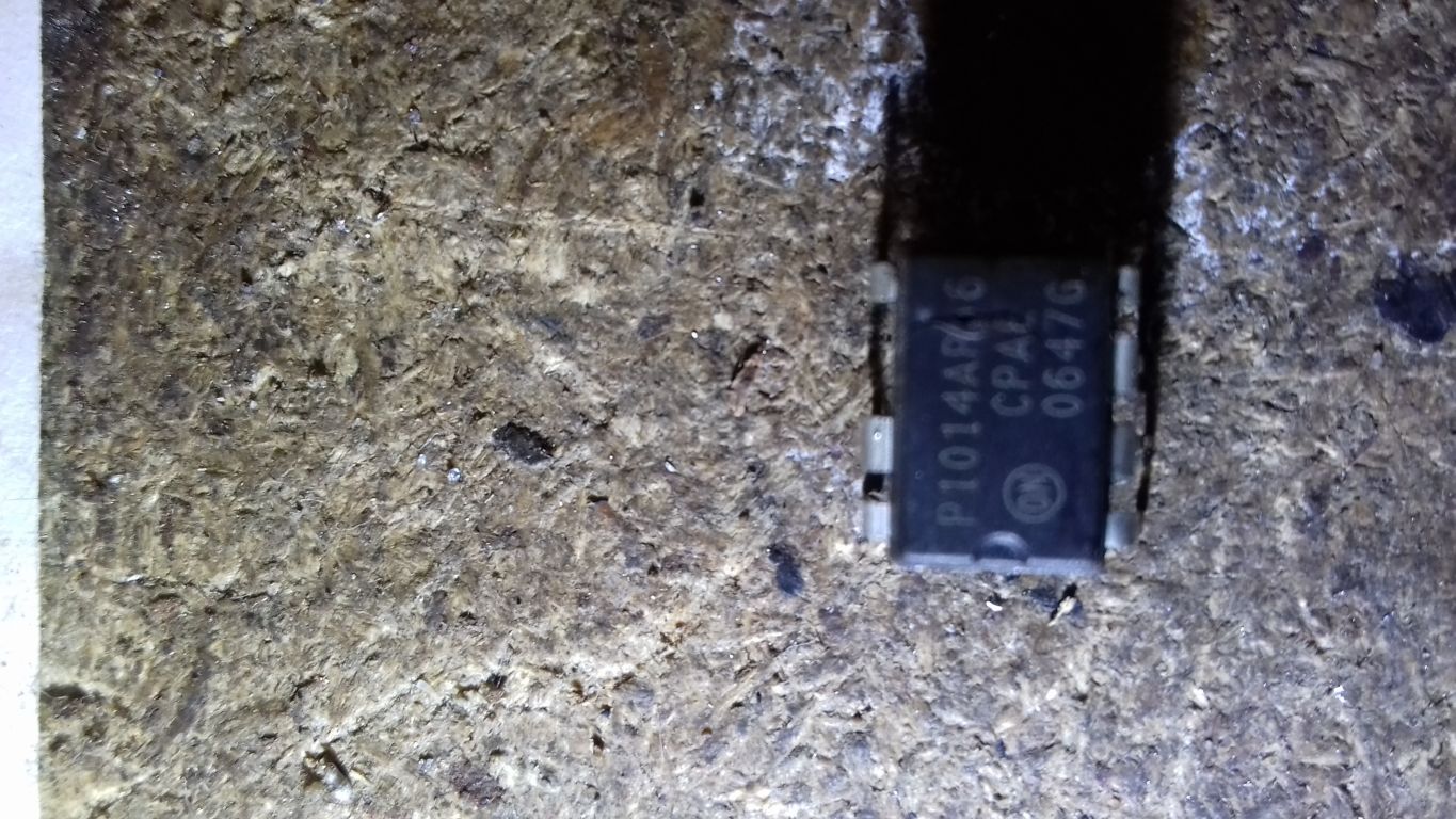

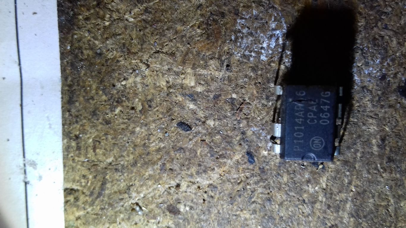

is this a NCP1014AP065G ?
  • petehall347
    • Jan 2015
    • 4429
    • United Kingdom
    cant quite read it as hole blown through ...
    • 31138
    Re: is this a NCP1014AP065G ?
    from the datasheet - yes.
    all variants are AP,
    ending values are 06, 10 or 13.
    clearly this is 06.
      nice one . just needed confirmation ... its from my tv power supply . main capacitor open circuit . suppose thats what killed it ? quick check of diodes etc nothing else appears shorted .
        Getting a bit o/t, but if your TV PSU has Active PFC (APFC), you might want to make sure that circuit is running as it should be and not overshooting. Main capacitor going open-circuit can be attribute to either bad part (crap cap brand) or APFC overshooting and killing the cap over time. Usually it's #1, but I've seen the latter wreck even good quality brands too. Something to keep in mind after replacing the main capacitor and that NCP1014 chip.
          there are 2 bulged caps on the board i am replacing as well .
          bit of history .tv always worked well but would sometimes forget what source was selected when coming out of standby .. i had been away a week and on my return i plugged the tv back in and no standby . grabbed the hair dryer and warmed it up .stand by light come on and switched on fine .left it on and ok for first night . next night it was off when i woke up . no standby light . so far found this ic blown up . 2 bulged 4700uf 6.3v caps and main 150uf 450v cap open . plus a blackened open fuse .
            well its up and running . replaced 4 caps in all plus the ic . tv starts up in 4 seconds .
            main filter cap replaced with 150uF 450v SNAP-IN, Rubycon (JAPAN) HXG 105C, ripple:1.51A! LIFE 3000Hrs
