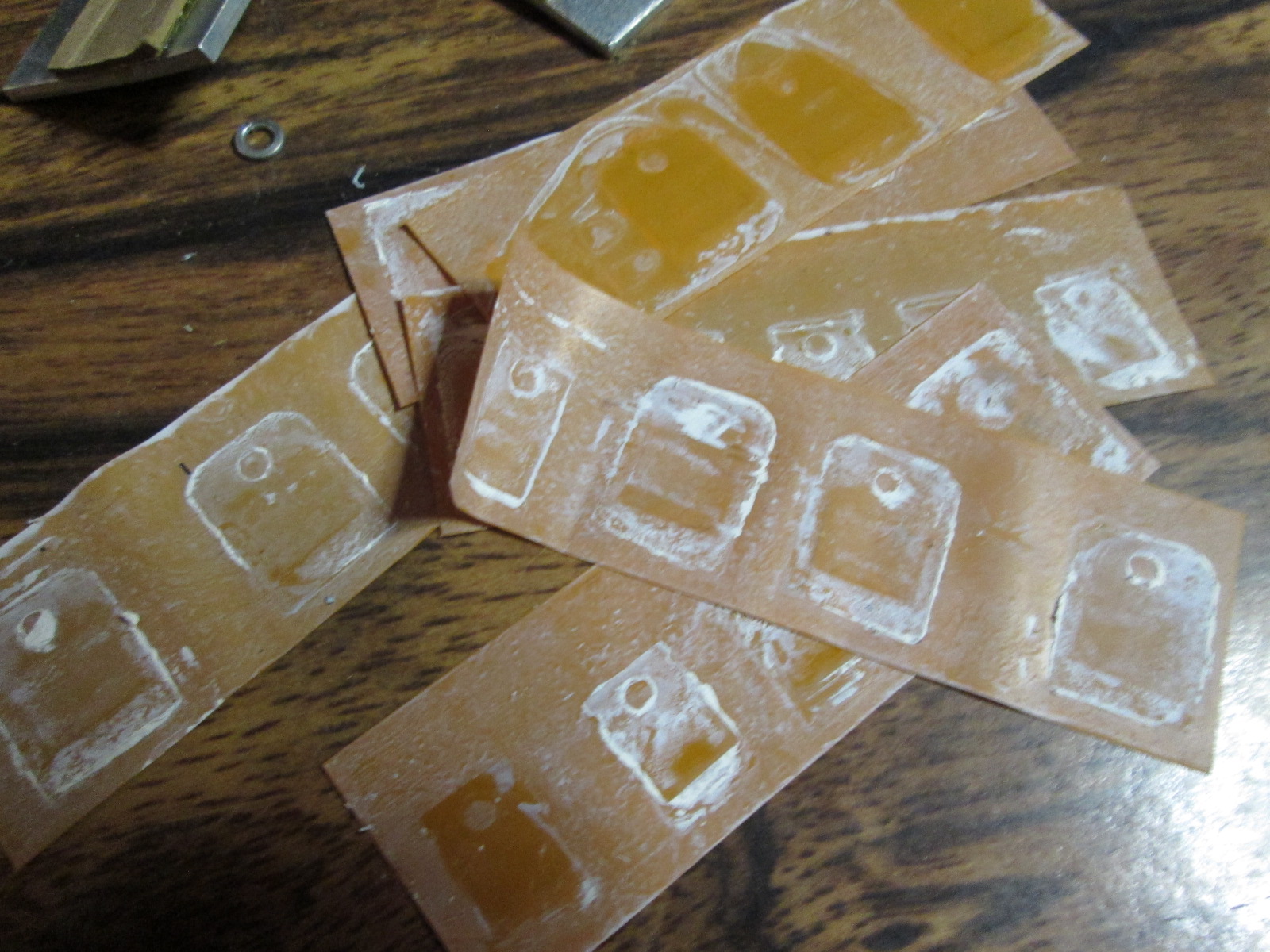

    Can anyone identify this insulating material please?
    Its a thermal insulator for a car amp, paper thin.
    Anyone know what its called?
    thanks
    • 31013
    Re: Can anyone identify this insulating material please?
    thermal pad - possibly from bergquist.
    • Cartel
      • Feb 2006
      • 112
      its not a sil-pad.
      Its like canadian money, super thin and like a plastic paper
        • 31013
        could still be, the thickness is only down to isolation usually - your not dealing with mains.
        • PeteS in CA
          • Aug 2005
          • 3579
          • USA, Unsure of Planet
          Maybe something like Kapton?
          PeteS in CA
          • petehall347
            • Jan 2015
            • 4426
            • United Kingdom
            life is short .. clean it and use again ..
              master hoarder
              • May 2008
              • 12170
              • Bulgaria
              +1
              If there are no breaks in the material, just clean and reuse with new thermal compound.
