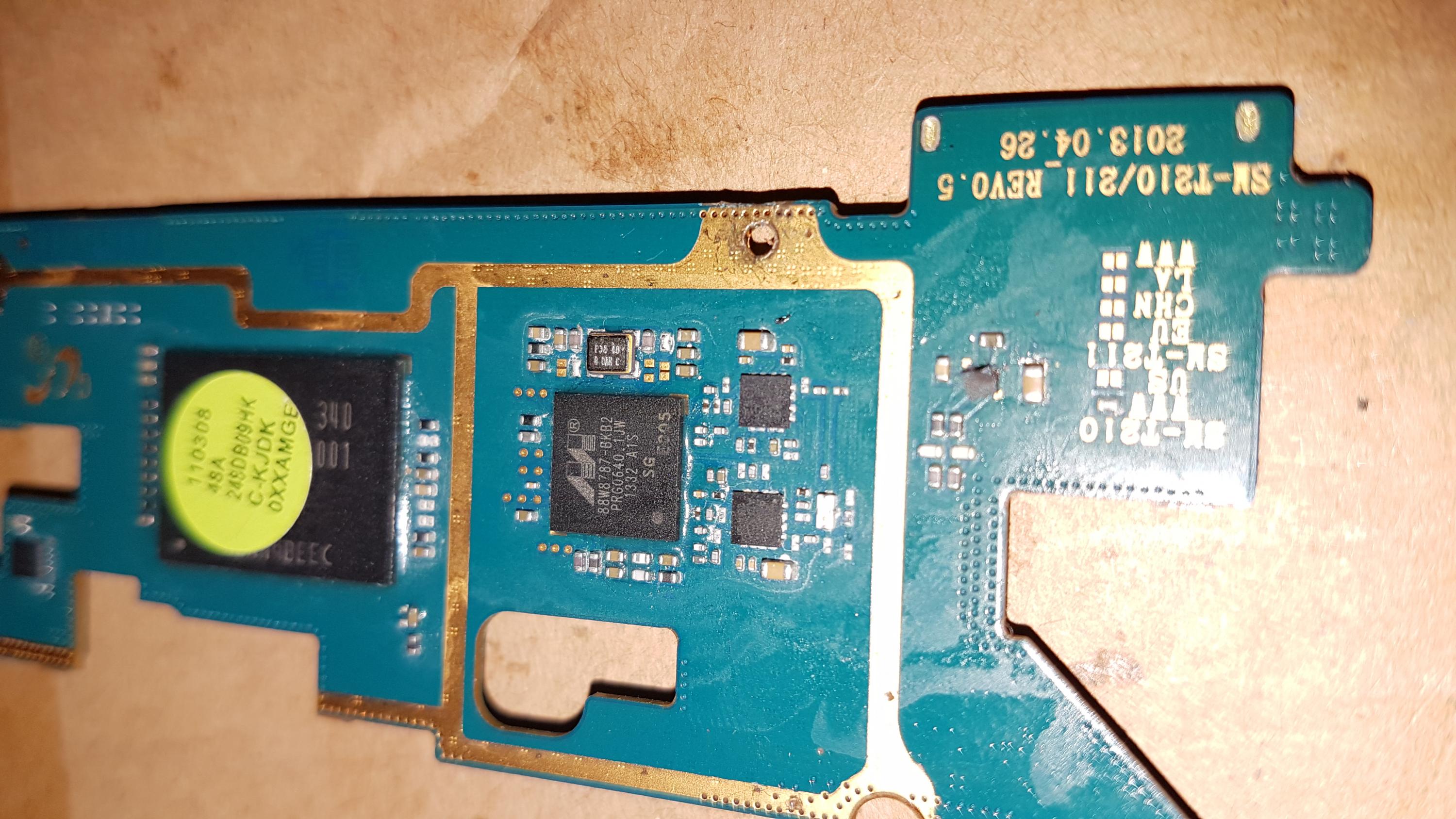

    I have i dc power supply Qw-ms305d and i i set 2v and connected to red to the shorted part of the curcuit ibdont feel any heated components with finger i can se voltage drop and amp meter going up.
    Trying to get a android tabno power issue

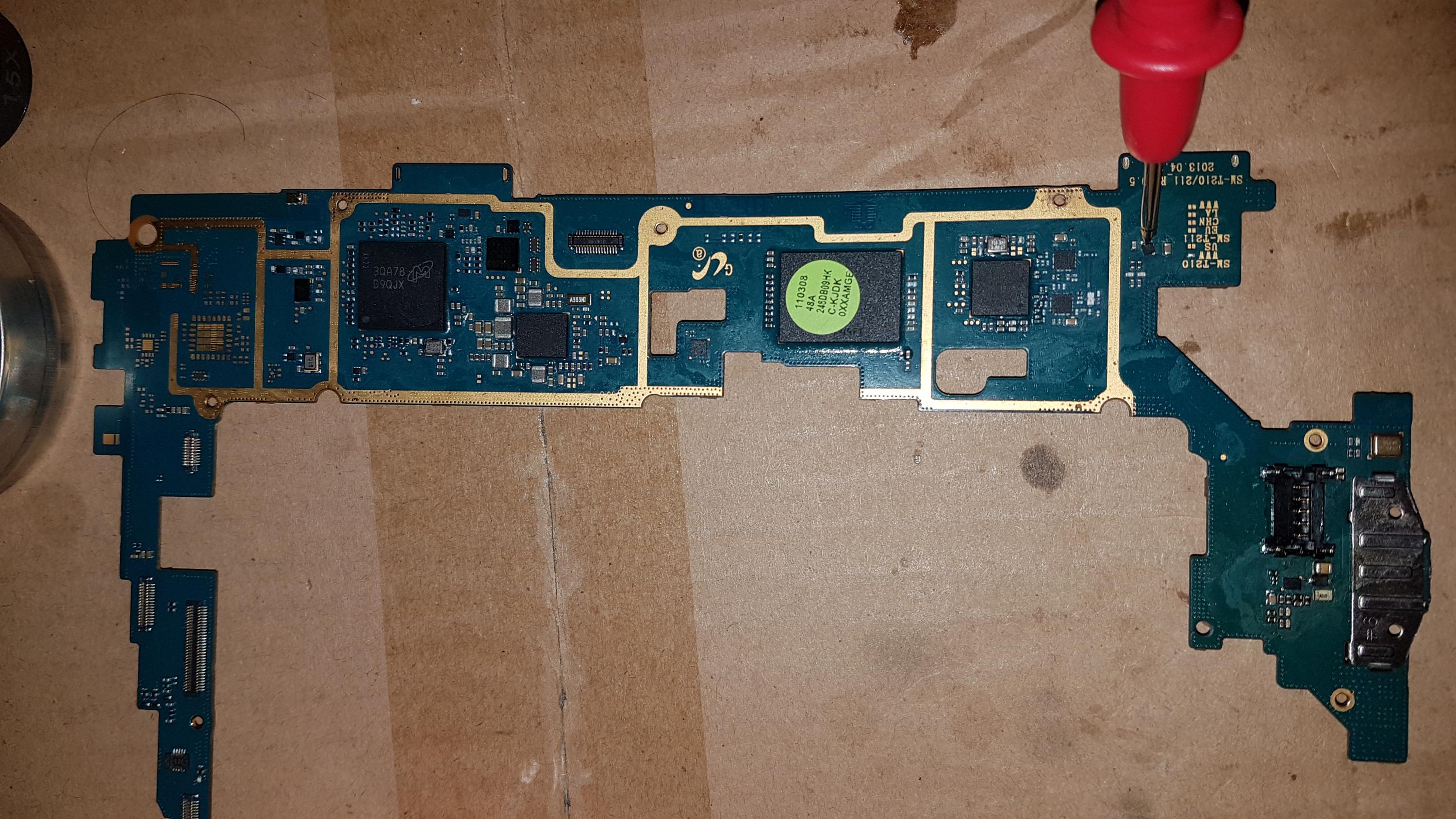

          I set to 5v voltage and touched the red pin to the short cap.
          I say its shorted because it beeps both sides also if i touch gnd and any side of the cap it beeps also when i connect the dc power supply to the cap voltage drops and current goes upto 136.
          The first image showing which two caps.

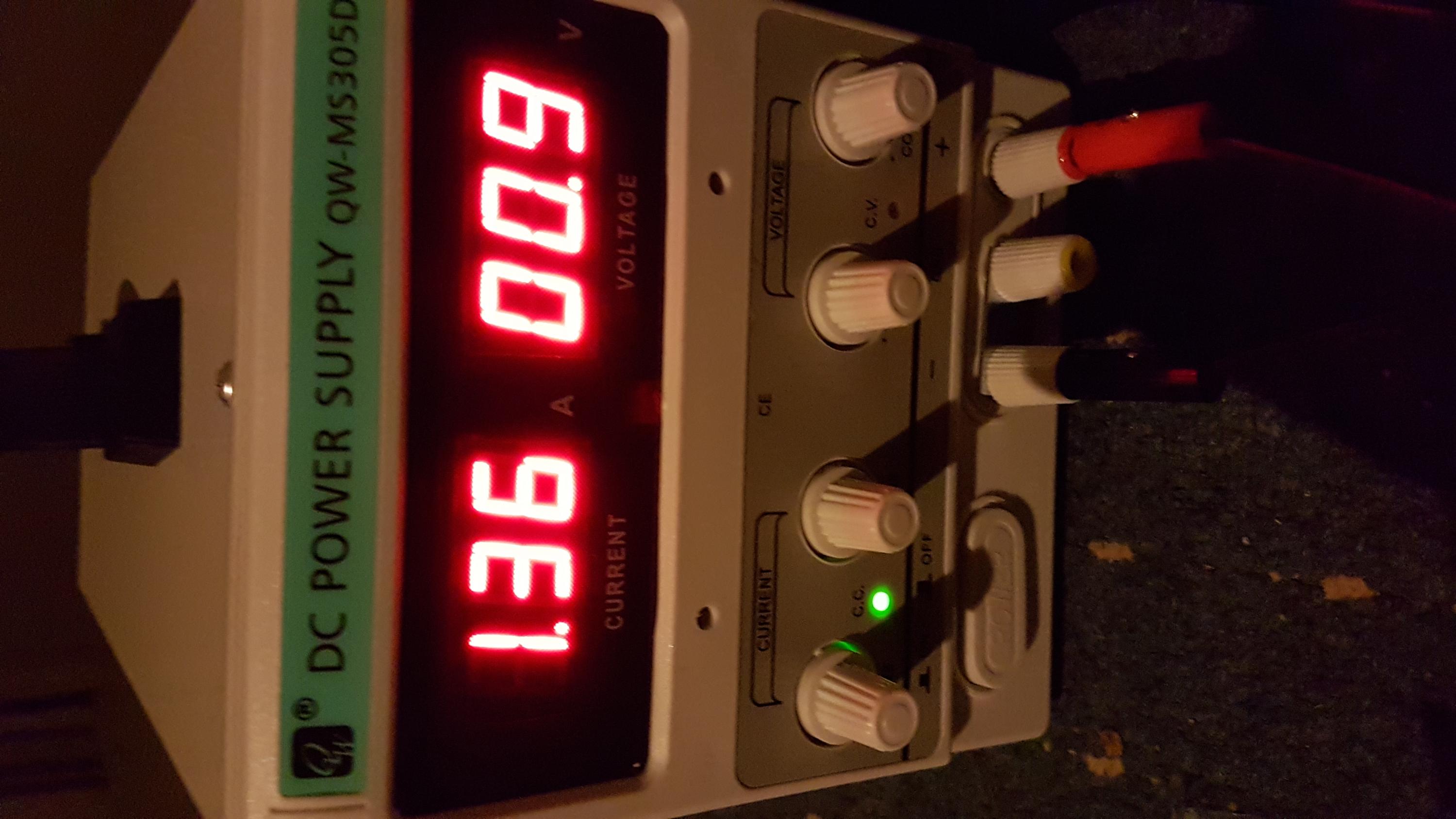

          The second image showing me connecting dc power supply drawing current.
          00.6 Ohm.

            Re: Use dc power supply to find short heated meathod?
            There's a decimal point in there. It's 1.36A. You have the current limited, I usually inject 3A to find the short/hot component.
            You should disconnect the battery before testing/injecting voltages.
            Why not remove the capacitor and see if the short goes away?

              Thanks for the reply i removed the caps before and they was fine because it didn't beep i connected the wire of multimeter to the pins on board were the caps was and it beeps so am trying to figure where the short is coming from i tried freeze spray but no sighn of heat.
              I will try set more amps i just hope am doing it right when i connect the dc power supply pin to the shorted part the current goes to 136 and board dont heat
                Setted 3.52amp stil not heated components am i doing it wrong

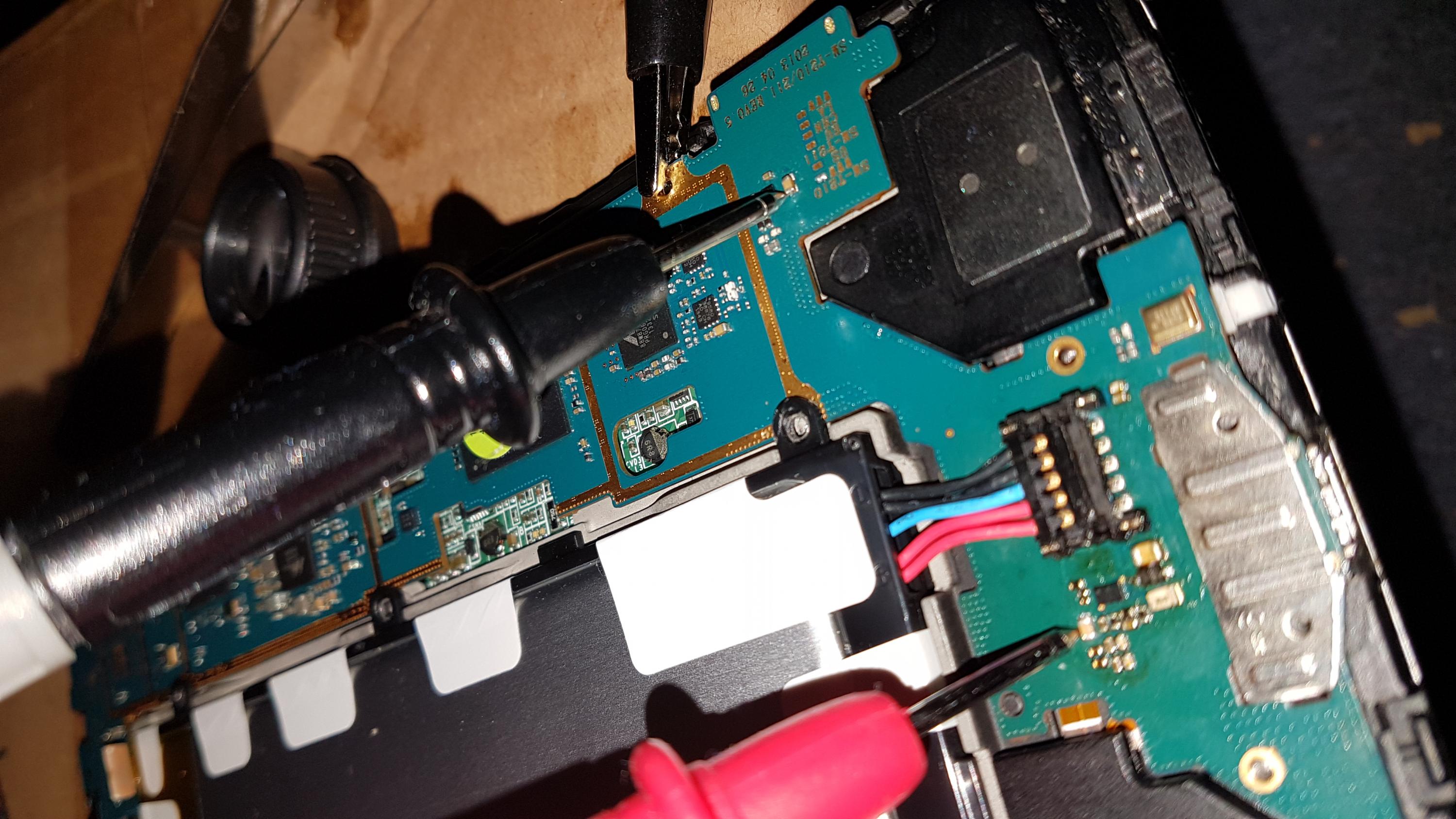

                  You're aware there's a load of components on the other side of that pcb ? It needs removing from the chassis as it's possible something that side has shorted.

                    Yes its out of the casing and the board is out only am touching it both sides no heat i can hear the dc power supply fan turning on due to the current being set to 3.xxamps and low voltage drop

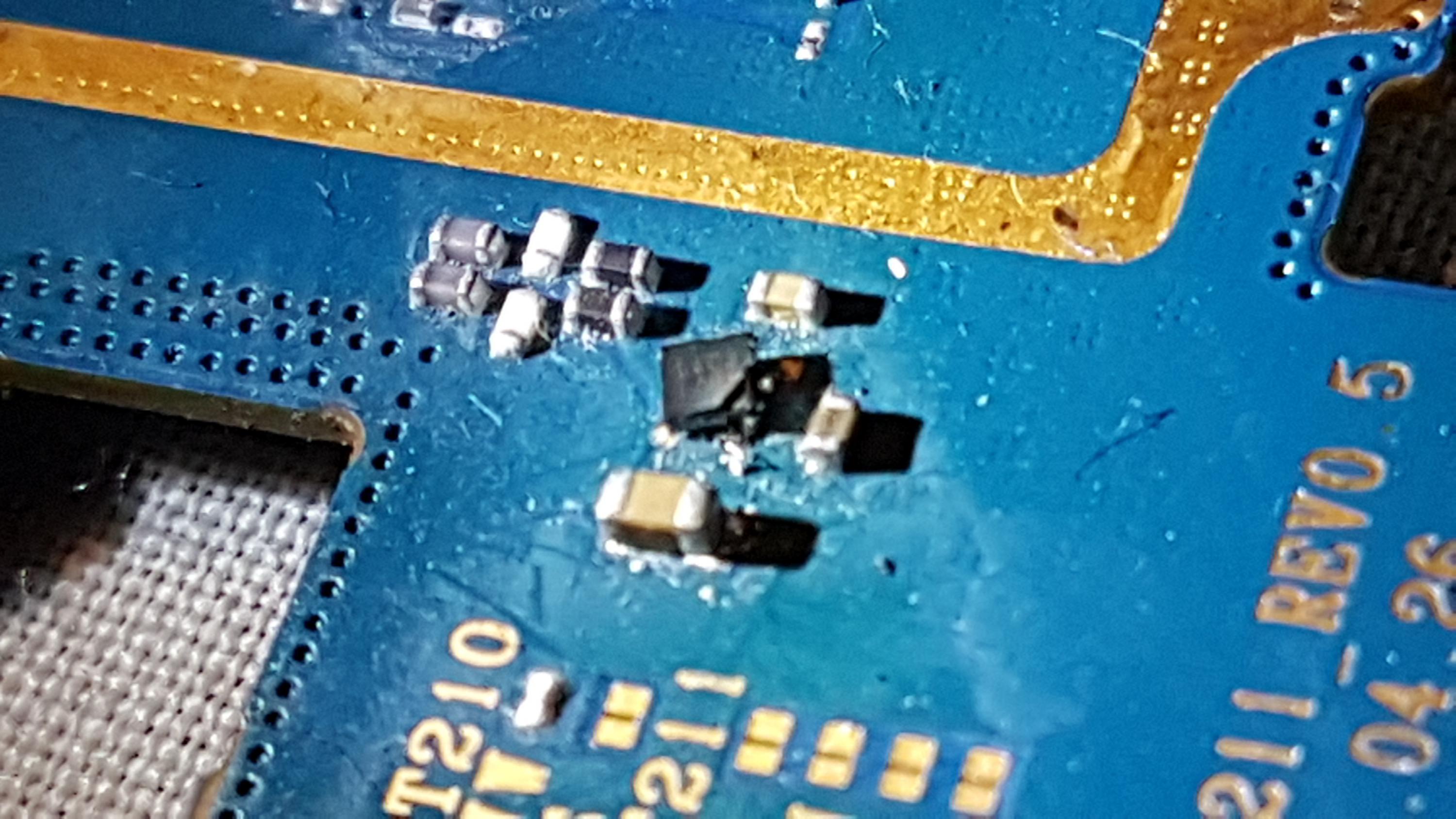

                      Ok lol i got sick of it and as i was holding it while the amps was on 4 i set it to 5 and the ic next to the caps smoked is that the culprit
                          If the magic smoke came out it's dead now. What are the markings on it ?
                          You can also measure for shorts with a meter in diode mode, put the red probe on ground and the black on the rail to check.

                            Please check post 11 attachment is that the culprit caused no power.
                            Diff not sure what the marking was but can you tell me if that was the part causing the issue.

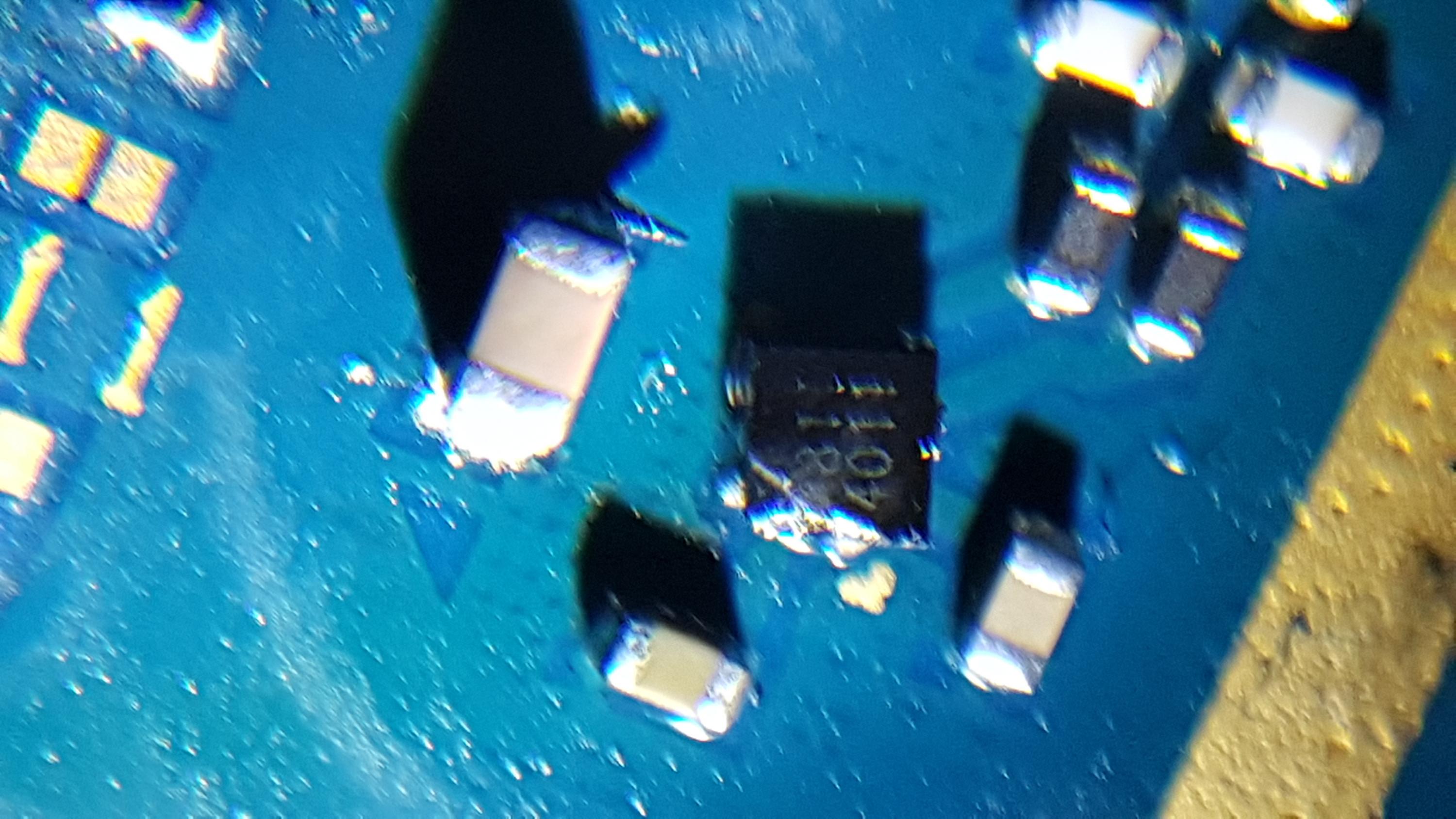

                              Super zoom to the blown part.
                              Its for galaxy tab 3 rev 5
                              4811
                              4011
                              9 joints to this chip
                              Wonder were i can get this from.

                                U492 is the ic audio amp.
                                I can find one in Russia. http://originalspareparts.com.ua/parts/120/2/

                                  How do u know that ic is audio.
                                  I broke the ic of the board the caps stil beeping? Maybe i should add the new ic and se if it works or should i give it another amp test to se what else smokes?

                                    I found reference to it on the Russian page and also here http://forum.gsmhosting.com/vbb/f258...ounds-2119234/

                                        I also Googled U492 galaxy tab t210 and it's the 6th/7th link. There is a translate link.
                                        What trouble shooting brought you to inject 5V there ? Page 8-4 of the service manual has the troubleshooting steps for no power on.
