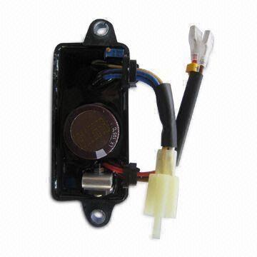

          It is all mystery to me so I googled up petrol generator regulators.
          I took a I look at the regulator circuit box.
          So then I went to my fleet of old discarded, smokey ,noisy, gennys of the same design to see if I could find a another regulator box but was surprised that they did not seem to have them?
          I started one of the clunkers and found it was giving out 248volts.
          The washing machine pump works after turning down the revs to get back to the original frequency and at 230 volts so I pretty much happy about it all.

                                    Re: voltage revs variation petrol generator.
                                    I repair quite a few of these unbranded 3000 watt Chinese clones for a Landscape gardening client, the the regulator goes bad they can produce up-to and higher that 300 volts or zero volts depending upon the fault. The auto voltage regulator (AVR) for the generator sets I see tend to be built into the alternator and as mentioned work by varying the armature voltage.
                                    They tend to look like the below, there is usually an adjustment for voltage (trim pot).
                                        ones i have done the trimpot is for over-current cut out . i set a diesel one up with the customer there and he shouted look at the black smoke from exhaust . i said lets let it run for a while flat out to clear it . it did of course clear it . plenty of black soot and sparks came out of that thing .
