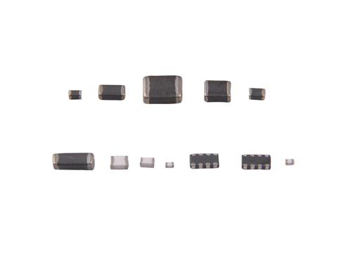

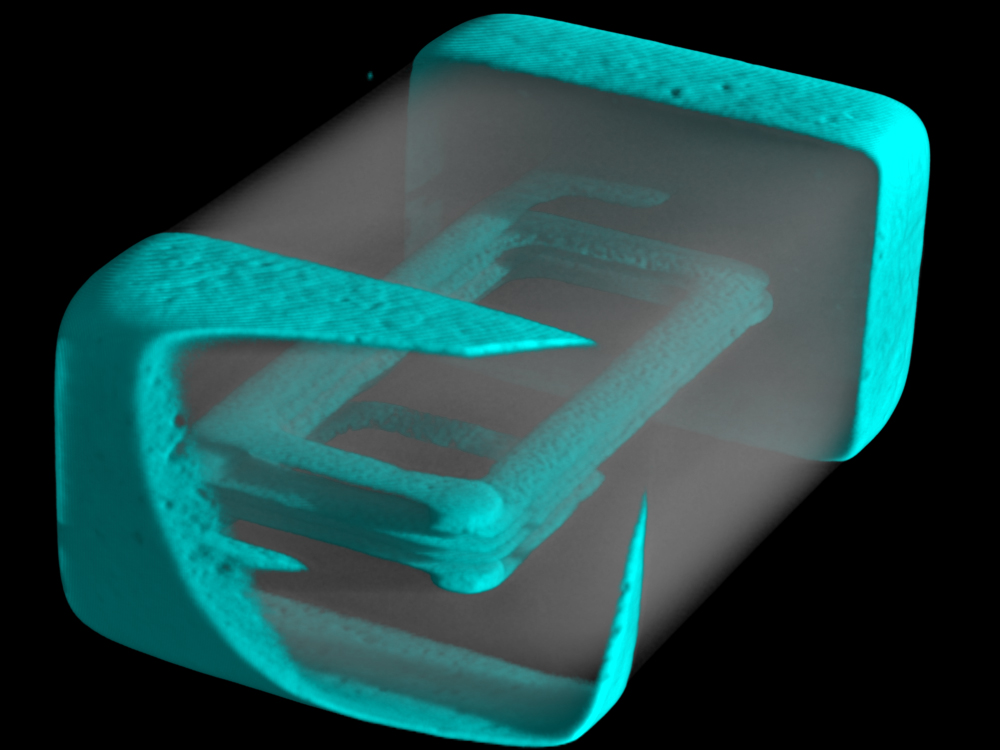

          Re: OK to replace inductor with solder blob?
          The card has been running seemingly 100% stable so far all day (I'm just about to test it by replaying Prince of Persia - Sands of Time for a while)
          it would be impossible to wind my own inductor of the correct value
          As you can see from the photos I have attached - you can get an idea of the size by looking at the smallest one in the first picture - the 2nd picture shows by way of x-ray how these are constructed...
