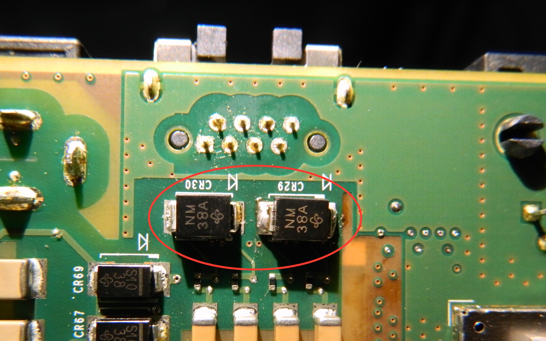

Help identify Diodes
  • cvorke
    • Oct 2012
    • 26
    • Solar system
    Could someone help me identify marked Diodes?
    They are on input of POE lines at Cisco AP.
    Both are OL in both direction.
    Thank you!
  • redwire
    • Dec 2010
    • 3906
    Re: Help identify Diodes
    They look like bi-directional Tranzorb TVS diodes (no stripe) by Vishay; diode markings. NM date code 38?
    It's normal for them to read open in both directions until their clamping voltage.
