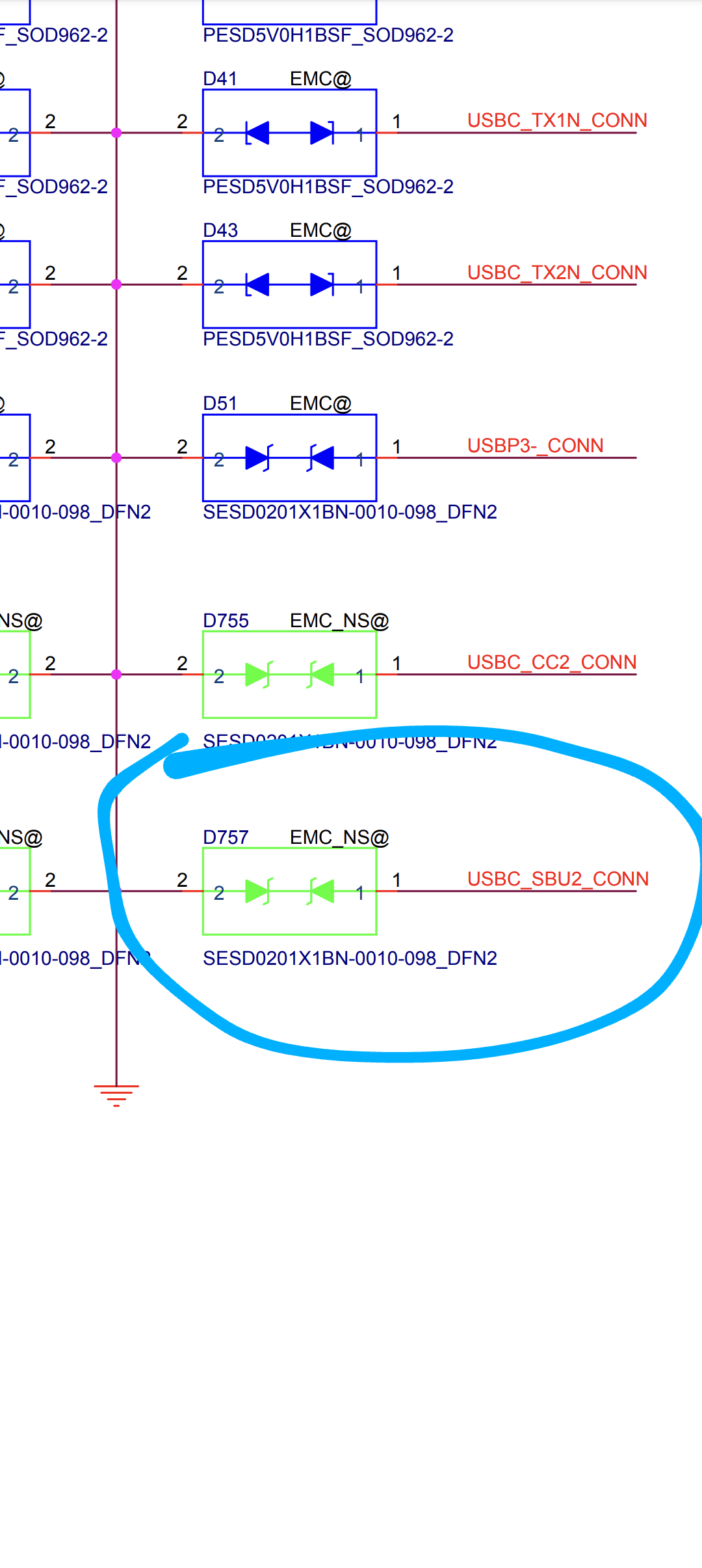

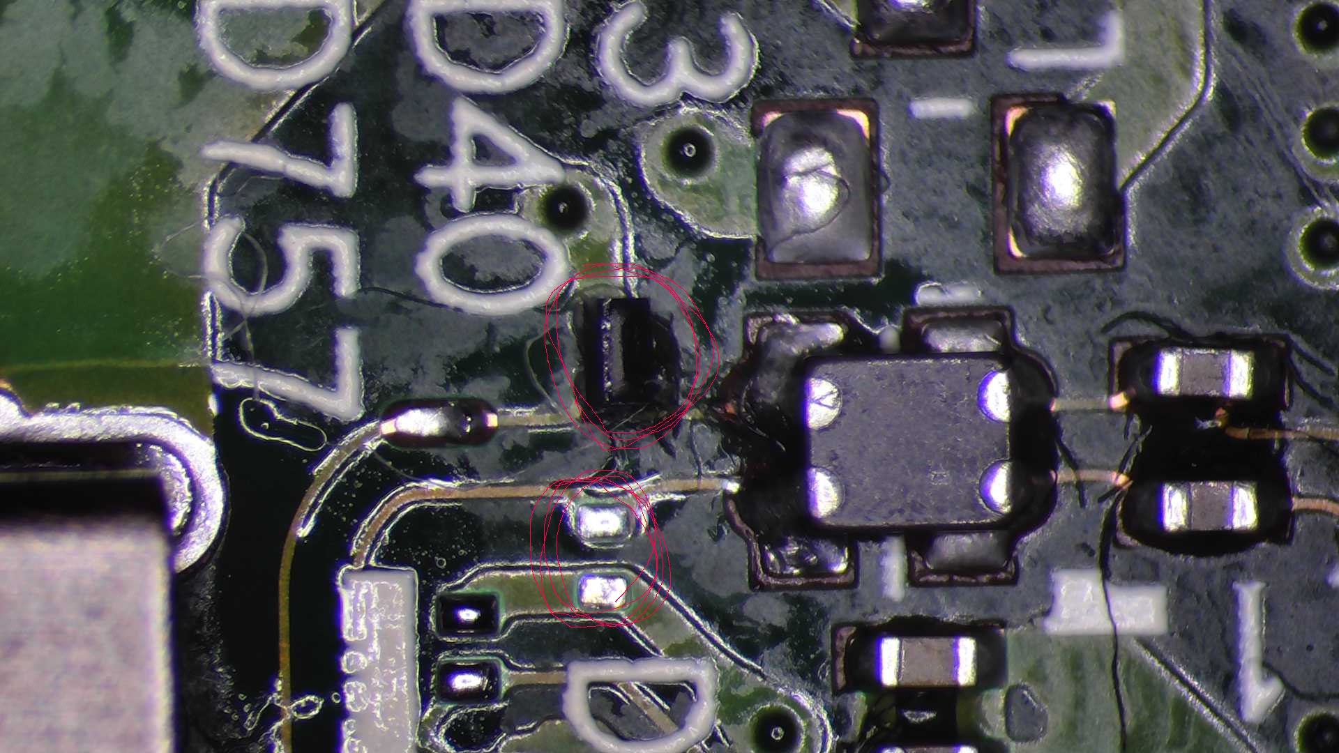

    Hi folks. As the title says, I was doing a port replacement on a Lenovo Thinkpad T480s and in the process of post-solder cleaning, I somehow knocked off 2 or 3 diodes (i think they are diodes) near the main usb-c. I can't seem to find what kind of a diode is that. I know it's ultra tiny and just has a letter "G" on it. Would someone maybe have a proper schematic for the t480s model? I can only find the non-s one and it's quite different to the "s". Would love to figure out what component that is.
    Thanks in advance!

    What is the motherboard model number
    • Nikolai Danylchyk
      • Apr 2025
      • 4
      The board in question is NM-B471.
        • 20795
        Check these schematics and boardviews https://www.badcaps.net/forum/troubl...-t480s-nm-b471
        • Nikolai Danylchyk
          • Apr 2025
          • 4
          Found! Much appreciated
