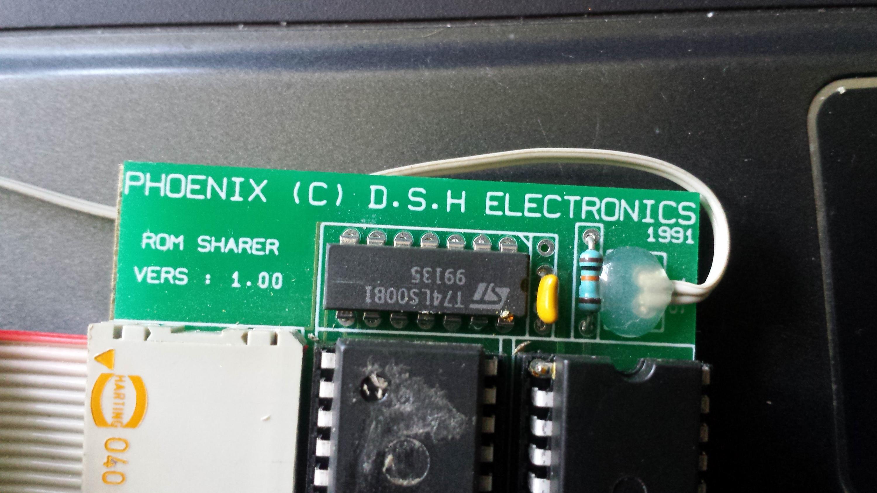

    I am looking for a t74ls0081 chip that may be damaged after a short out and I need to replace to eliminate it possibly being faulty now.
    can someone help me find one or is there a equivalent that will do the same job.

      Thanks here is a picture. Can you also tell me if the equivalent is also pin compatible so i can just solder it straight in.

        Re: Help with finding IC or a equivilent
        just a 74ls00 - they are all pin compatable from different suppliers.
        is that an amiga rom switcher? just wondering.
        why do you think the chip is bad?
              yes it was a Amiga Rom switcher that I stupidly put in the wrong way in a spare amiga and it burnt out a wire in the ribbon cable and got a MC74F244N chip on the motherboard bloody hot. Ive ordered a couple of new MC74F244N chips and fitted a new length of ribbon cable. I checked the kickstart rom chip that was not selected by the rom switcher (a KS 2.04 rom) and it is still ok. However I am not sure its good to try the rom that was selected (a KS 1.3 rom) in case it will damage my main amiga 2000 plugging it in. I cant believe I did that. That switcher has no markings to say which way it goes and I got it oriented wrong damn it. Just hope it hasnt taken anything else to much out like the MC68000.
                it could have trashed the 1.3 rom, but test it to see - it cant damage anything else.
                          Thank you stj. you were spot on with the SN74HCT00N i soldered it in and my rom switcher is working again. I also tested that other kickstart rom and your right it wasnt damaged so that's more good news. Now just have to wait for the two MC74F244N chips that got hot on the other amiga to come and I can then see if that fixes that one too. If it did damage the cpu I have a HT68000 which I could use which I think is just a Hitachi equivalent and it might have even come from another amiga years ago.
