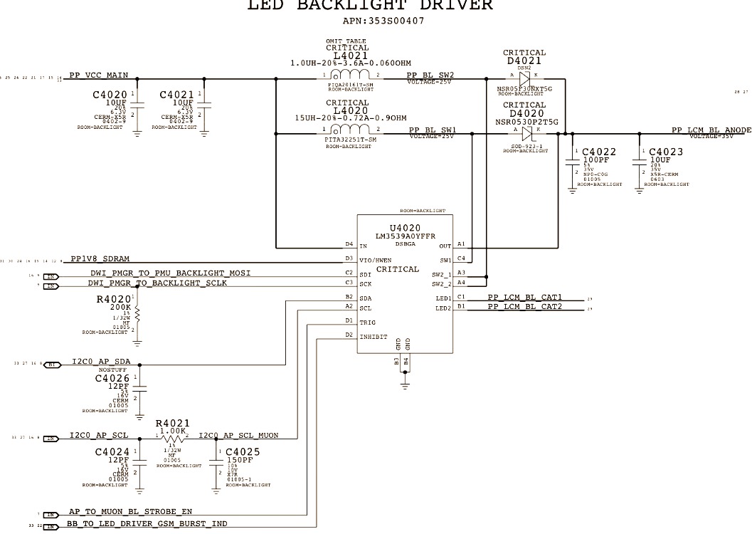

    iPhone backlight circuit operation question
    Im curious why there are two different coils used. Is it for providing smooth current output or is a feedback system?

    Boost converter for driving the LED strings..
    Just look up 'BOOST CONVERTER'
    Since you have the P/N of the IC (LM3539) then just look up the spec sheet to see how it works, it is LED driver LED.

      No data sheet available. I know it's a boost converter I'm wondering the purpose of two coils of different sizes as oppose to just one
        Re: iPhone backlight circuit operation question
        It looks like both inductors are not driven at the same time, one is when high current demand is needed and one for lower current demanded.

            I've seen lots of videos on iPhone repairs. But I feel a lot of the people don't have clear understanding of electronics theory and circuit operation. They're mostly checking for shorts and replacing components. I'm sure they know basic stuff but I'm trying to understand circuit operation
              If you want to really understand the circuit operation then you need to start making actual measurement to see what is going on in the circuit such as this backlights controller IC
                I was thinking it might be multi-phase.
                              You can see one of the signal line has the word 'BURST', may be it has something to do with that. You also check the 'SWx' outputs to see what is going on. One inductor is rated at 3.6A, another one is rated at 0.72 A.
                                    Why would Apple use an extra inductor and diode?
                                    One inductor is 1uH/3.6A and the other 15uH/0.72A, so a high power and low power mode.
                                    Boost converters have high peak input currents, even if the load is small.
                                    I would say there's no room in an iPhone for a big capacitor to absorb those spikes and they switch over to the bigger inductor to lower electrical noise.
                                    During a call, you want a low noise on power for cell comms. Also for lowering EMI with dual-frequency or multi-phase between the two boost converter outputs. But I don't see the one inductor capable of anything but low brightness.
                                    It also looks like they are turning off the LED boost converter during a GSM TX (packet) burst, to save available power. Long range GSM transmit power can take almost 2A.
                                      Is the 15uh inductor responsible for the high power?
                                      When you say it's turning off boost during a gsm tx, does that only happen when the screen is off? If not how does the backlight stay lit if that's occurring
                                      How does it know when to switch to the other inductor to lower noise?
